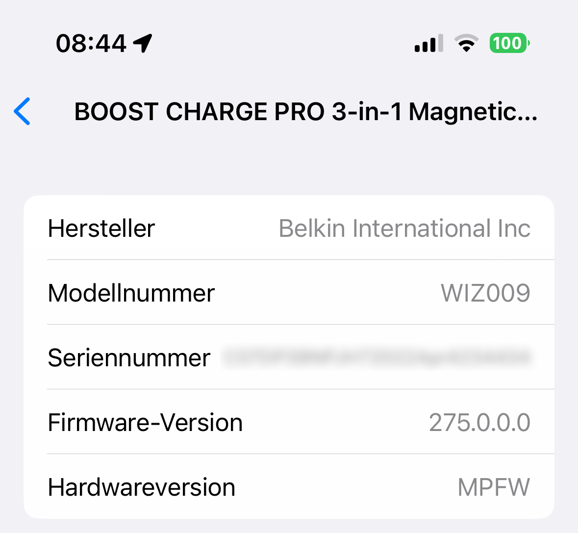

To see the firmware revision, put it on the MagSafe charger and wait 2 minutes.
Without removing it, unlock the phone and go to Settings->General->About and scroll down, it's about 2/3 of the way down.
I had to wait about 5 minutes for some reason.
