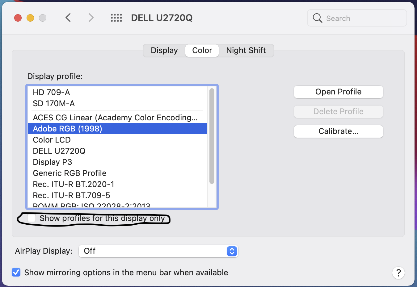

You have to uncheck "Show profiles for this display only" to see other display profiles. Check below screenshot.
Thanks but it is not about the color profile but the signal between M1 and monitor where I can not get RGB mode (in Dell OSD menu only YPbPr works if I switch to RGB everything becomes pink). This is not a new issue but I had hoped it would be different with USC C vs HDMI cable. More about it here:
