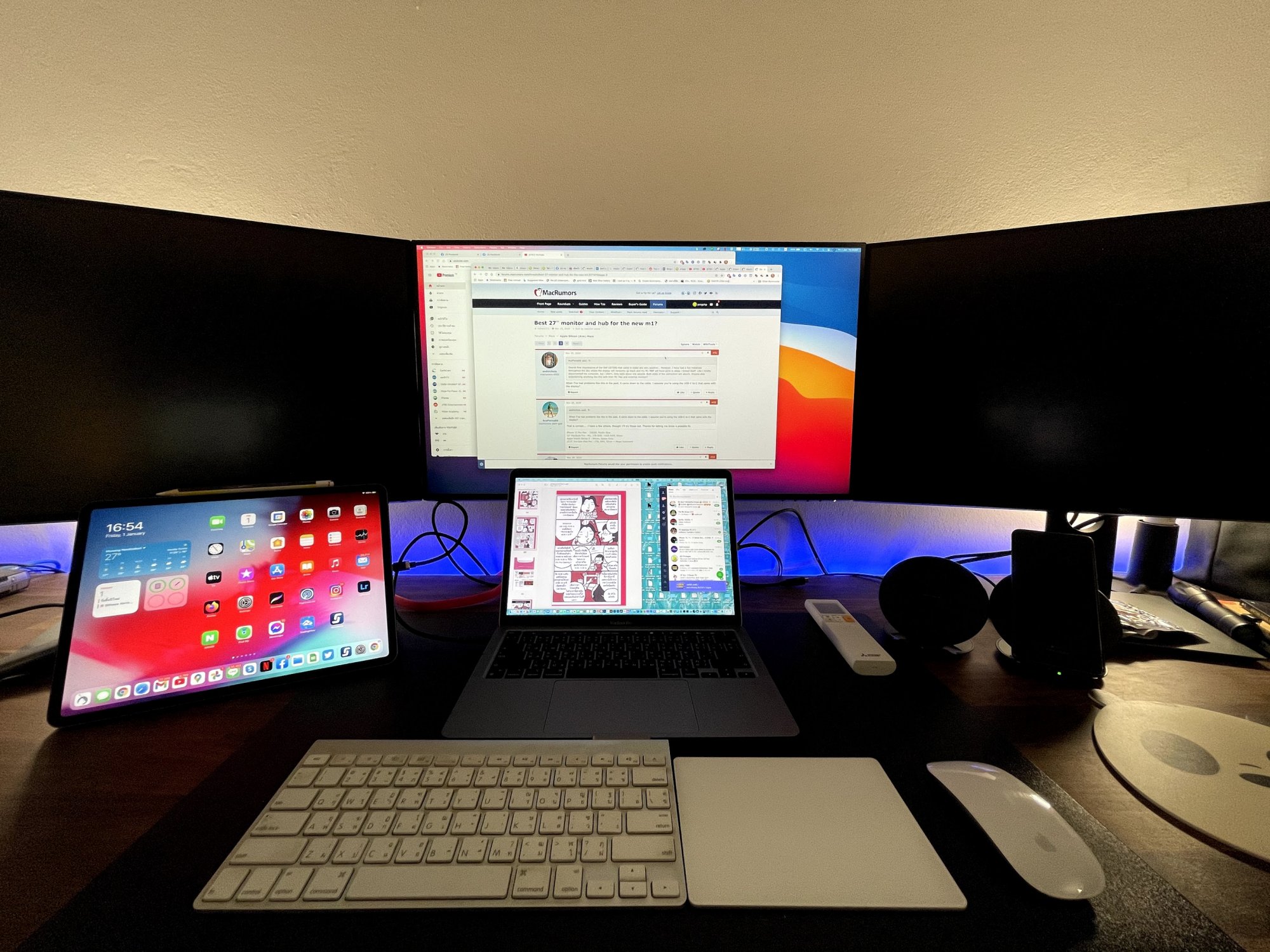

MBP M1 with U2720Q. Perfectly fine.

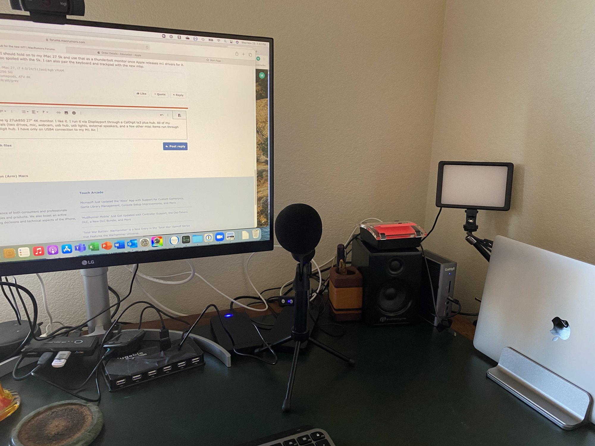

I have the lg 27uk850 27" 4K monitor. I like it. I run it via Displayport through a CalDigit ts3 plus hub. All of my peripherals (two drives, mic, webcam, usb hub, usb lights, external speakers, and a few other misc items run through the CalDigit hub. I have only on USB4 connection to my M1 Air. So far so good.
