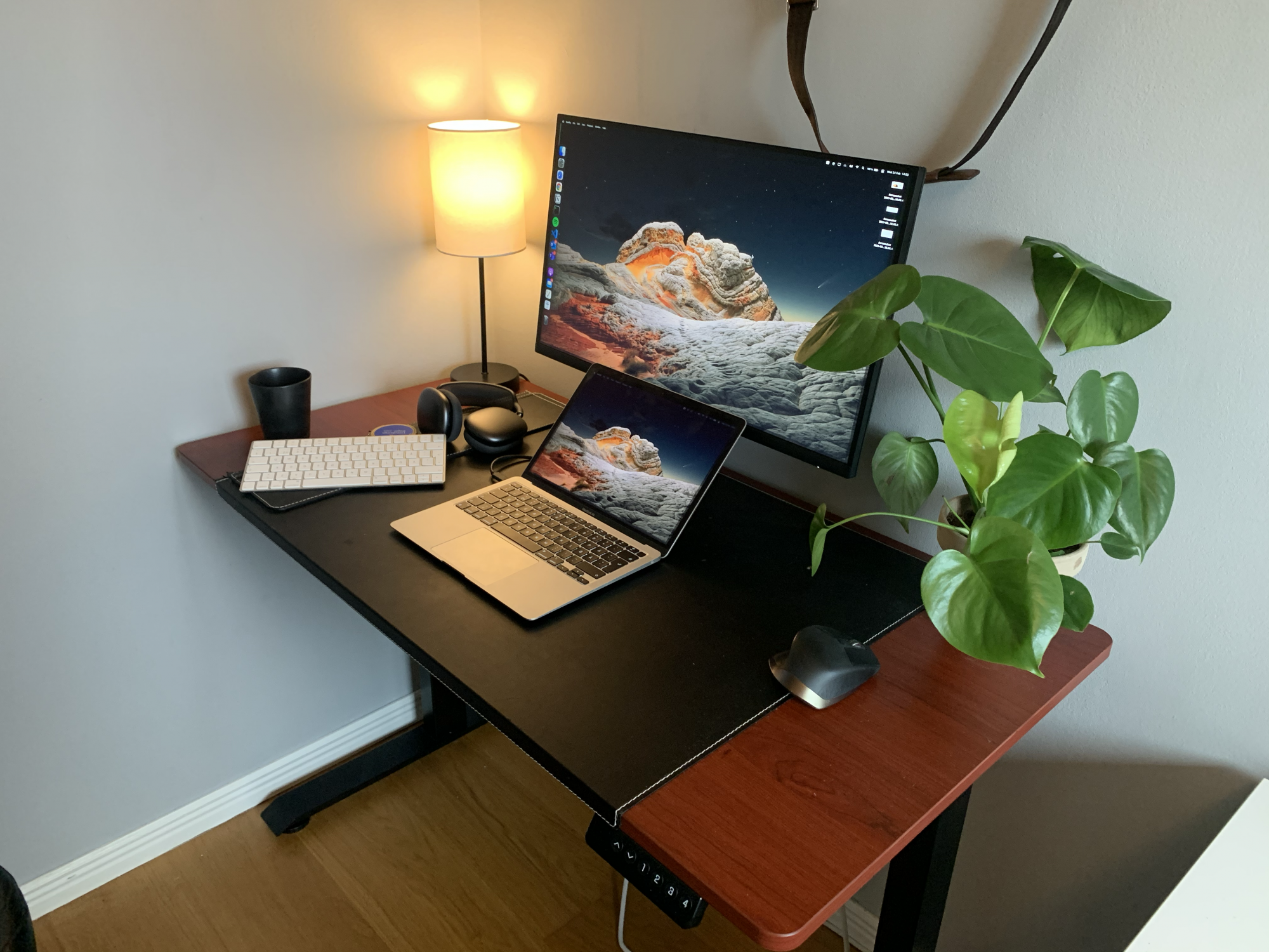

Ive been using a Dell P2721Q 4k USB-C monitor with my M1 Macbook air. Very happy with it so far, I also like that there is no visible Dell logo on the monitor.
