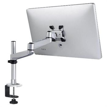

Cotytech is a Taiwan based company that sells a variety of monitor arms and other ergonomic products.
They have a number of arms which may support the 27" iMac, but the first one I'll point out in this post is their Apple Monitor Desk Mount Quick Release Dual Arm. It's actually quite a basic arm with no gas shock or spring, however what is interesting about it is that it doesn't require the buyer to purchase a separate Apple VESA Adapter Kit. Here is the company's YouTube video showing how to directly attach it to an iMac. At $159.99, it isn't cheap for a basic arm (though you do save the $39 on the VESA adapter).

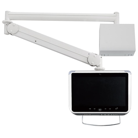

The second arm may be stretching it a bit - - it's payload is 26.4 lbs, so it's actually over it's weight capacity supporting an iMac with it's stand removed. It's feature is it's length. It is called the Long Reach LCD Monitor Arm MW-M25WB, and it is fully articulating with a gas pneumatic spring combination. It extends a full 73" from it's wall mount and costs $773.99.
That's interesting, Bob. Disappointing about the inadequate carrying capacity, though I'm wondering if future 27" iMacs might not be lighter, if they go permanently to SSD only plus more lightening. Though not a fan of the undersling design - looks too medical/hospital gear.
"Copytech" indeed. That first one is the exact arm Monoprice is selling, and for $70 more.
