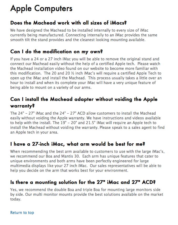

As far as installation goes, I have attached a screenshot of their support page for Apple Computers that addresses installation of the MacHead adapter on older 21.5" iMacs by a certified Apple tech. It says that the Monitors in Motion sales agent can find an Apple Tech in your area that will not void the warranty (You may also want to try this Apple Authorized Service Provider locator, but it's mostly Apple Stores. https://locate.apple.com) Hopefully they can get everything straightened out for you.

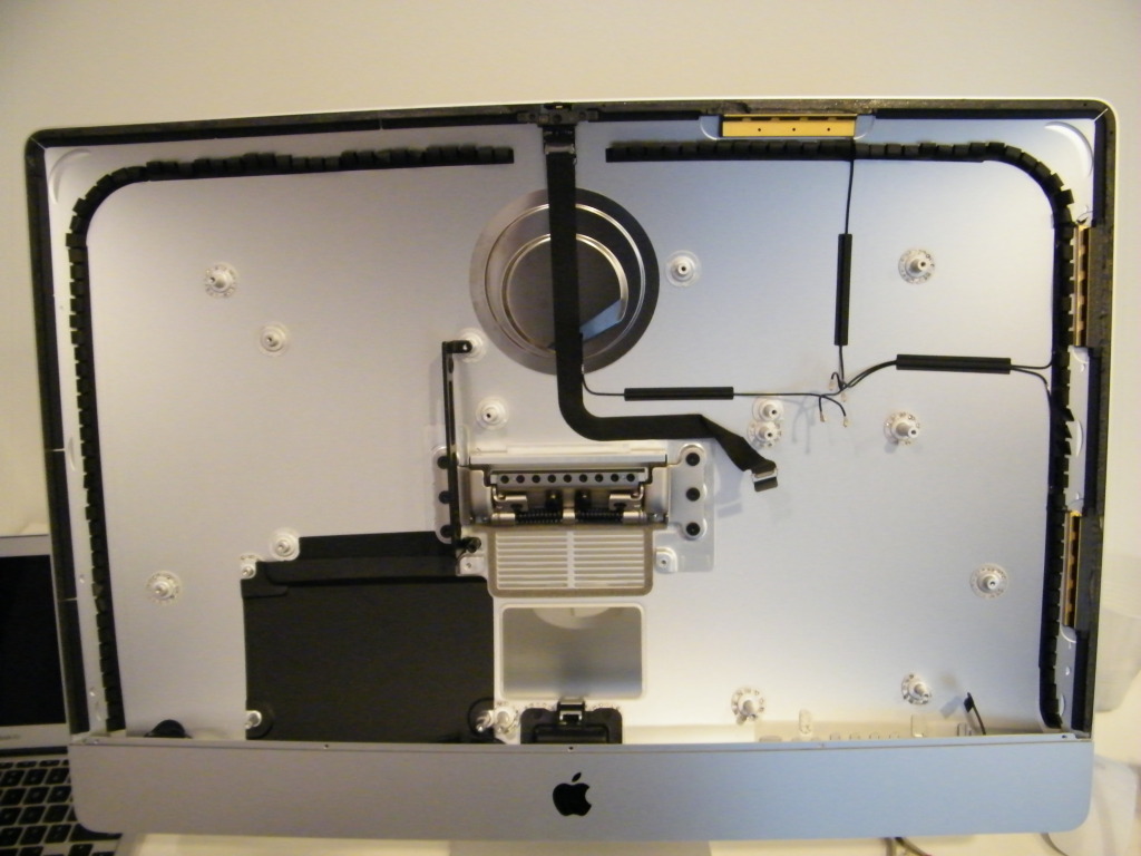

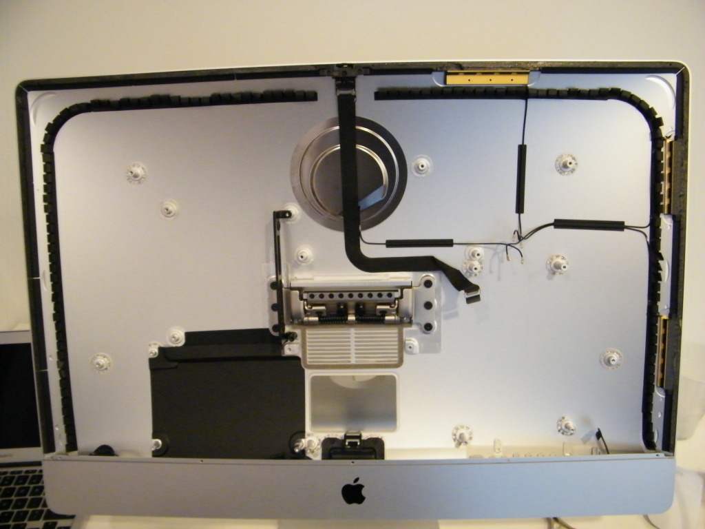

Hate to tell you but the stand is screwed in, inside the imac. Unless you catch a genius on a great day I highly doubt that they will install it for you. If they will then I will stand corrected, but chances are you are stuck with the imac mount like I have.
It was documented on this site when the new iMac was released that the stand is screwed to the inside and full disassembly was necessary to remove it. That is why Monitors in Motion developed a MacHead Adapter that was compatible with the new mounting arrangement, and they stated in the Facebook post that the adapter needs to be installed at an Authorized Apple Store or dealer because disassembly is required (This was also the case with MacHead installation on earlier versions of the 21.5" iMac). Obviously this is something that would be pre-arranged with a competent Apple technician for a price, and would not be expected to be done by any random Genius.

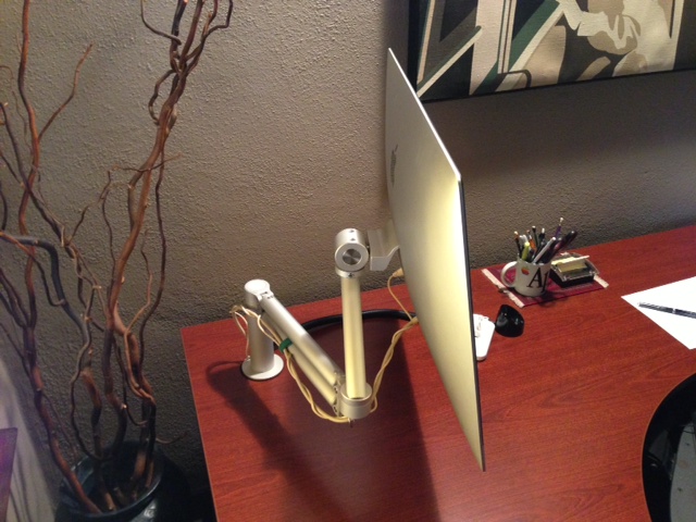

2011 27" iMac
Mounted my 27" iMac to a Innovative 7500-hd-1500 with the help of this forum. I thought I'd upload my pics. Super happy with the way it turned out. I'd say the arm was set for the full 44#'s and I didn't think I was going to be able to get it down to adjust without breaking my desk.

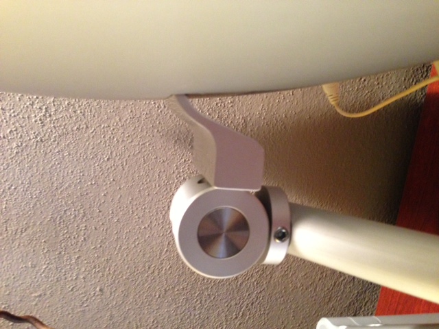

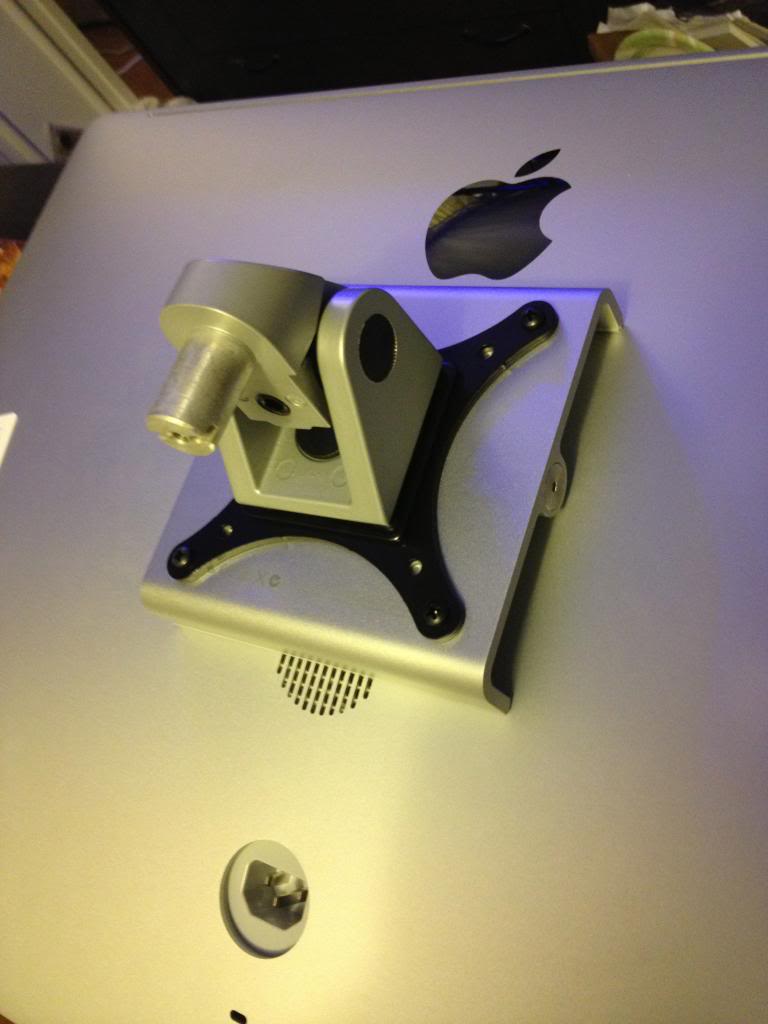

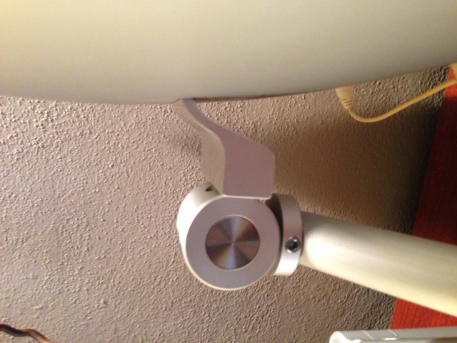

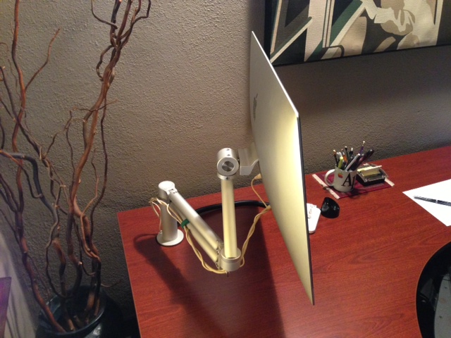

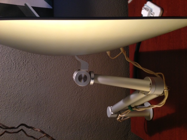

It was a long road to get here, but I finally got the right part from Monitors In Motion for the late-2012 model iMac.
When it came, I took the part (along with the MIM Facebook page shot that shows the "spigot" connected to the back of the iMac) to our flagship Apple store in San Diego and asked if they could attach it. They walked away slowly....figured as much. But they did recommend CryWolf, which I had as a backup to try out anyway.
CryWolf raised their eyebrows, but said "yup, we can." A few days and 200 bucks of labor later, here is the whole set up at my home office.

Have you noticed any issues with (CryWolf's) workmanship?
Not at all - they were professional, courteous, and my iMac looks the same going out as it did going in. Considering the way these particular models are built, it's a friggin' miracle.🙂

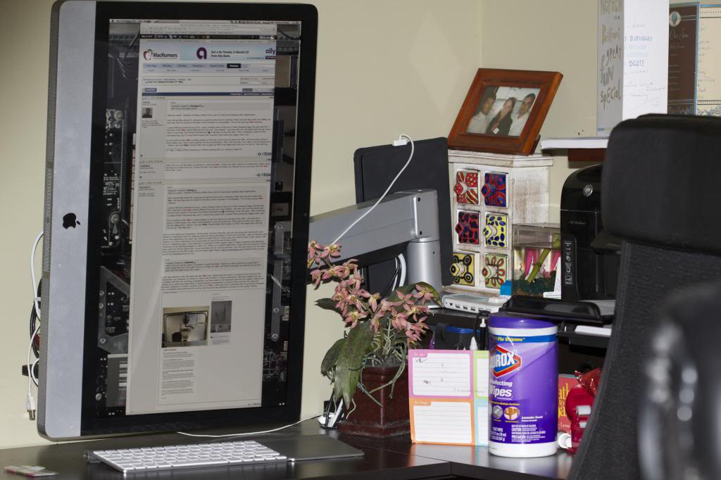

My good old 27" iMac and its trusty 7500-1500 arm companion are now into their fifth year of working as a team.
It's been sad to see Apple's move away from easy arm compatibility on the iMacs, and I imagine I will be going for a MacBook Pro or MacBook Air when it comes time to purchase my next computer. The arm will then take over duties with a new (4K?) external monitor on my desk.
