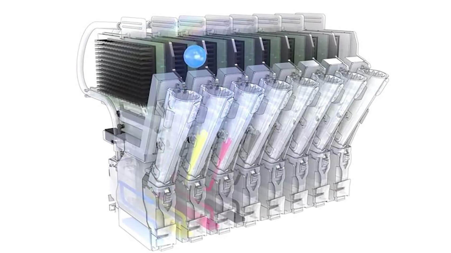

Okay so I checked with the techs, and while I don’t have a definite answer, I may have a lead. When we got our massive Epson large scale printer, our supplier tried to pitch us on a Canon laser instead, and I think it was this one: https://www.canon.ca/en/product?nam...s/Printers/Large-Format-Printing/Graphic-Arts
Gonna try asking the supplier to verify. As an aside, our new Epson with its 11 massive ink tanks has been a bit of a dog compared to previous models and we’re constantly needing to unclog the heads, even with regular use. Previous one never had that issue, so looks like we got a bad one.
For the occasional colour photo, I honestly just use our multi-function Ricoh, and while not as nice as a dedicated photo printer, it’s results aren’t terrible.

So that printer looks awesome, but it's inkjet. Thanks for the followup/suggestion.
It's interesting you use a Ricoh. The highest resolution color laser I found was the Ricoh. Which model do you use?
I have since found out that the Xerox printers that do 2400x2400 are digital press machines. So they cost about $15k, they print full bleed, and are excellent at printing photos. All good (well except the price). But the problem is it's a digital press which means maintenance on it is a nightmare. You basically need a service contract. I'm going to guess that amazing Ricoh that does 4800x2400dpi is also a digital press but will check.
Which means the Xerox c8000/9000 with glossy photo paper is probalby the best I can do at 2400x1200. I havent seen the output in person. I hear it's ok. Not amazing, but serviceable.

Nuts. I thought it was laser because it says toner pearls under consumables.
Our Ricoh is the MP C3004ex. If I need anything larger or nicer, then I let the printshop on campus do it.

I'm super glad you shared it though. It is an interesting hybrid kind of thing. Those toner pellets are very interesting. But I dont like the inkjet like moving print head because it has nozzles that can get clogged. Also, it's only 600dpi. But, the tech is super interesting and I might consider it for another application I have. Very cool find/tech!
And yes, I have been speaking with their sales people. Very helpful. They told me about the digital press (c60) and that it basically requires a service contract to keep that thing running. I don't mind paying the crazy high purchase price (around $15k), but I cannot deal with needing service people come and work on the printer (beyond even the price), it seems too high maintenance. If you have a large department where you need service people there regularly anyway, it probably is a great option.

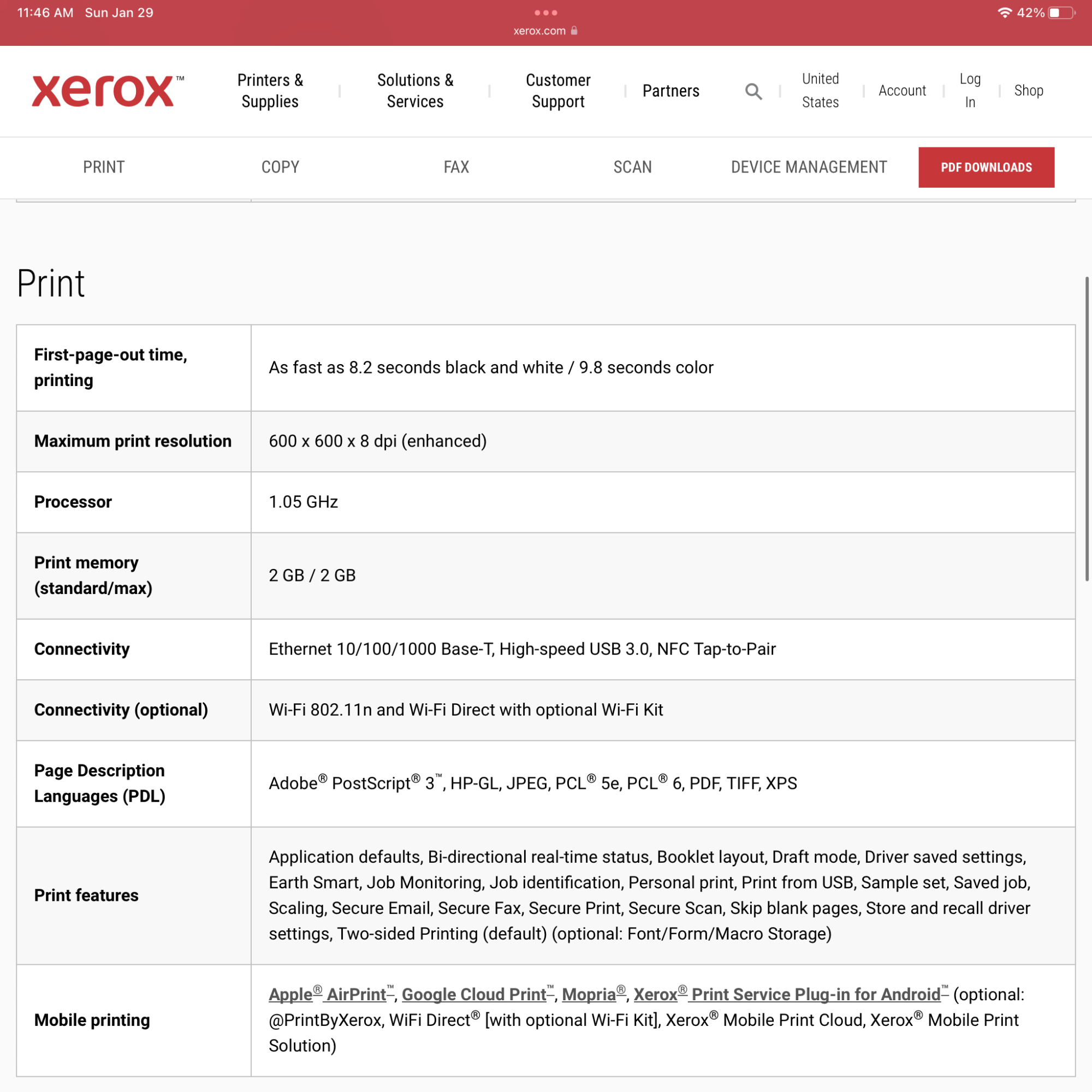

Out of curiosity, why so interested about resolution? I’ve seen printers with lower resolutions produce better results than models with artificially high numbers.
ive always found it’s best to get your samples printed and compare them.
Perhaps you could tell me what those printers are. There is a versa 405 printer that Xerox has and it produces 8bit color per printed pixel, but only does 600dpi.
I asked Xerox about it and they said the higher resolution printers did photos better but perhaps you’re right, when I do this math about how much Info per square inch is used to render an image, is it this:
600*600*256=92,160,000 bits of color info (or if it’s only 8 colors it’s 600*600*8=2,880,000)
2400*1200*4=11,520,000 bits of color info
So should I be checking out that Xerox 405 versa that supposedly does 600x600dpi @8bpp (ie 256 colors)? Maybe there are some other better color laser printers that do more bits per pixel that would be better for photos?
Also I may be mistaken, I was assuming the versa can do 8bits per pixel, but perhaps it can just do 3bits of color instead of 2, ie, only 8 colors? Here is a grab of the spec sheet:
Anyway, maybe my entire thesis that the more information per square inch will make the photo better only works in theory and in reality other factors trump?
I think the old inkstick/phaser printers did do 8bits per pixel, ie, 256 colors per printed pixel. Perhaps other printers out there can still do that?
