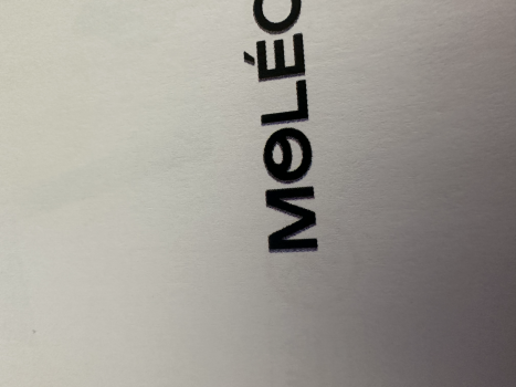

Well, I posted here some time ago about buying a Xerox VersaLink C7000. I bought it on March came to my house on June and its all have been a mess. The big problem is the printer drivers, the good ones are made for Windows, not for Mac. So the issue is that every print that has some kind of image it prints pixelated. It`s unreal. If I try the same exact print done with the AirPrint driver it prints perfect, but the options are very limited on that driver.
Ive tried everything, even 2400dpi pdf resolutions etc etc. With an HP 454dw I get a better result than with the c7000 (250$ vs 1.300$) so surreal. So I asked the support because it was clear that the software or something was not good. They just said, the machine prints like that, and that was all. So Im in the process of returning it.

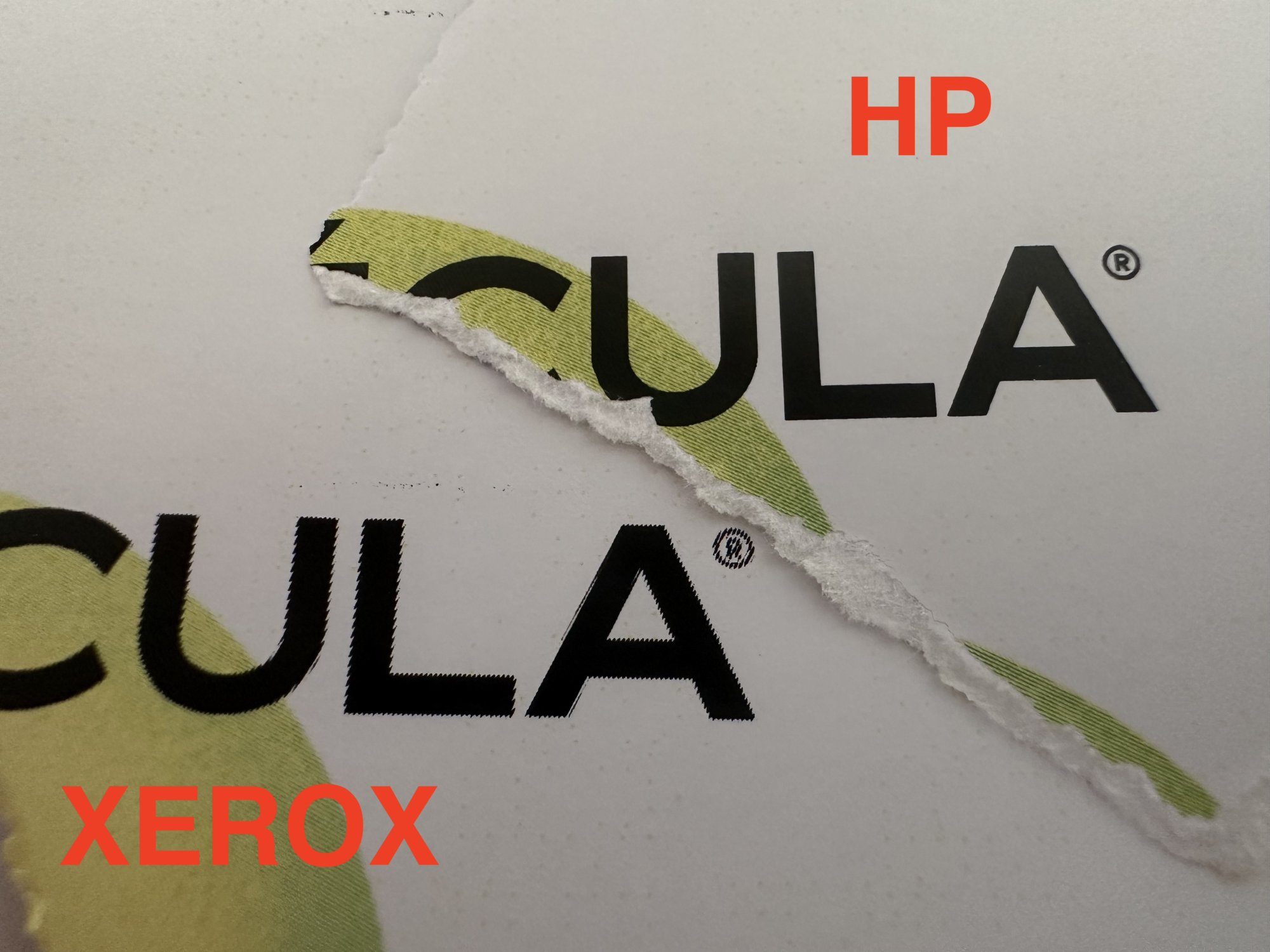

@diegopampin Xerox (slowly) sent me a sample of the C7000... which arrived after I had already bought and received the used M776. The halftoning scheme the C7000 uses allows for fine detail, may be better than the HP, but the color gamut is definitely not better. Getting an apples to apples comparison would be ideal.

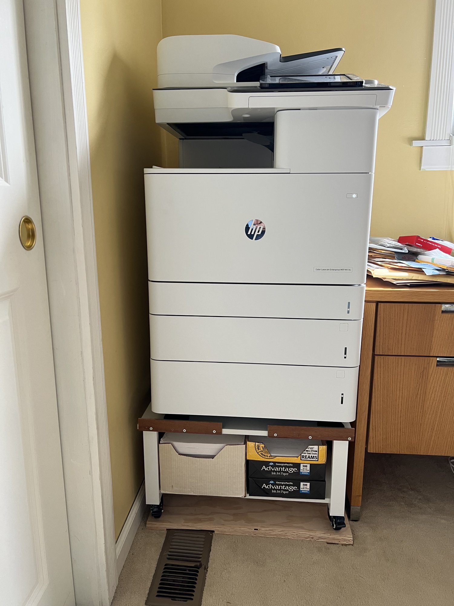

I went on vacation for a week, and them ordered a buddy for my MFP.... which came in the box the size of a whole printer!
Yes, I ordered the two paper tray base. I also managed to roll it into the office... after removing the door lol! This is one chunky boi.
I put it on a base to hold paper... and also to lift up the printer so the manual feed tray can clear the adjacent counter. Ofc I was off by 1/2" so I had to throw a piece of plywood under everything! Hah!
Yes, I cut a slot out of the bottom of the plywood to work around the end of the heater vent :D
More on the printer soon but: I love it! I am glad I got the MFP with scanner; you can scan even books open flat on the tabloid size glass; it will even cut the two page scans into two pages for you if you want. I can also get all the printer reports on the touchscreen without printing them to paper.
Three trays is my perfect sweet spot (letter, legal, tabloid on hand) and I have a manual feed tray for special papers and sizes.
I am super happy with my purchase. I would never have tried it at over $6000 list price, but at nearly new for under $3300 it is an amazing value. Thank you, @ZombiePhysicist for starting this thread and encouraging me on my journey.

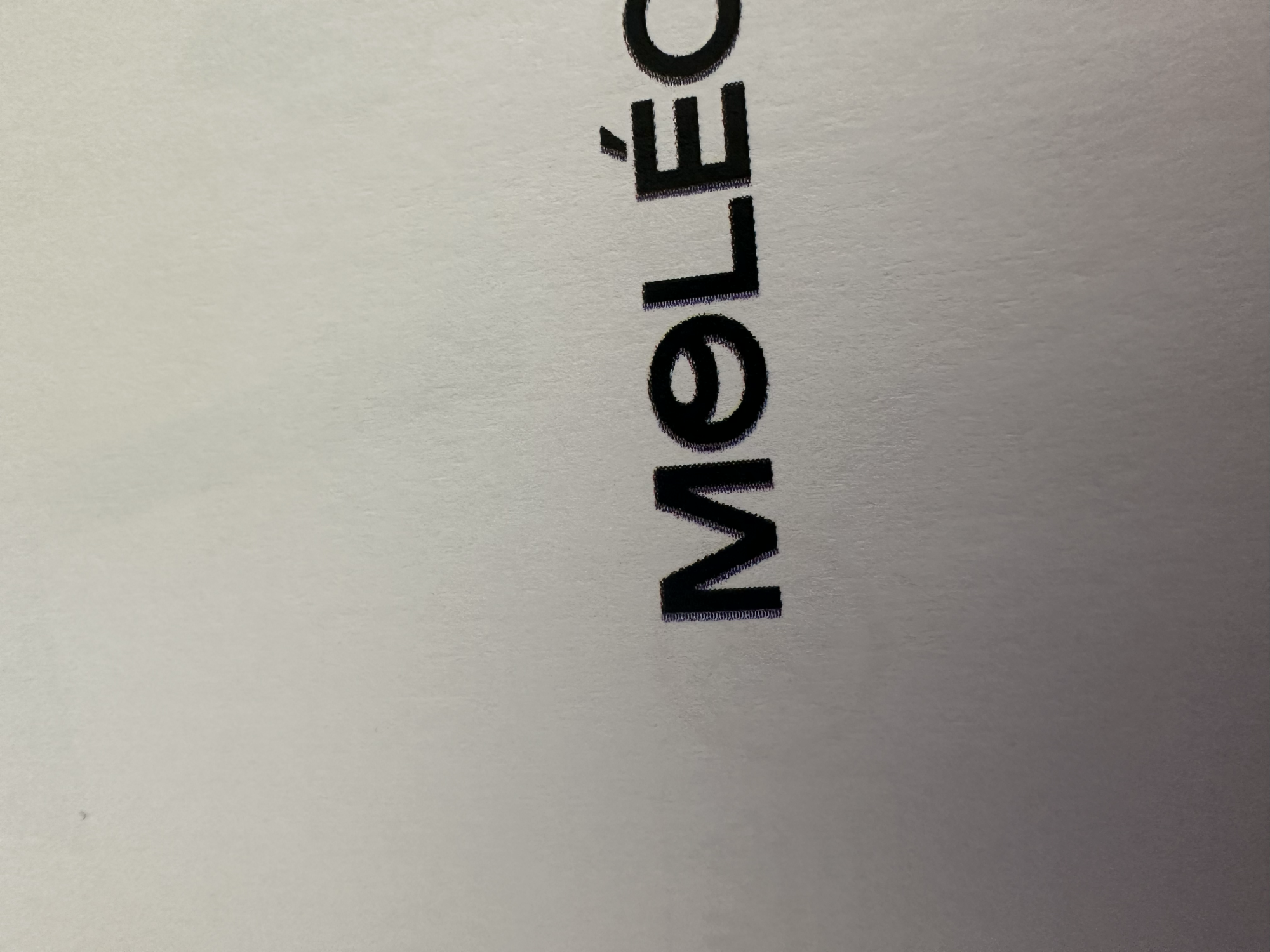

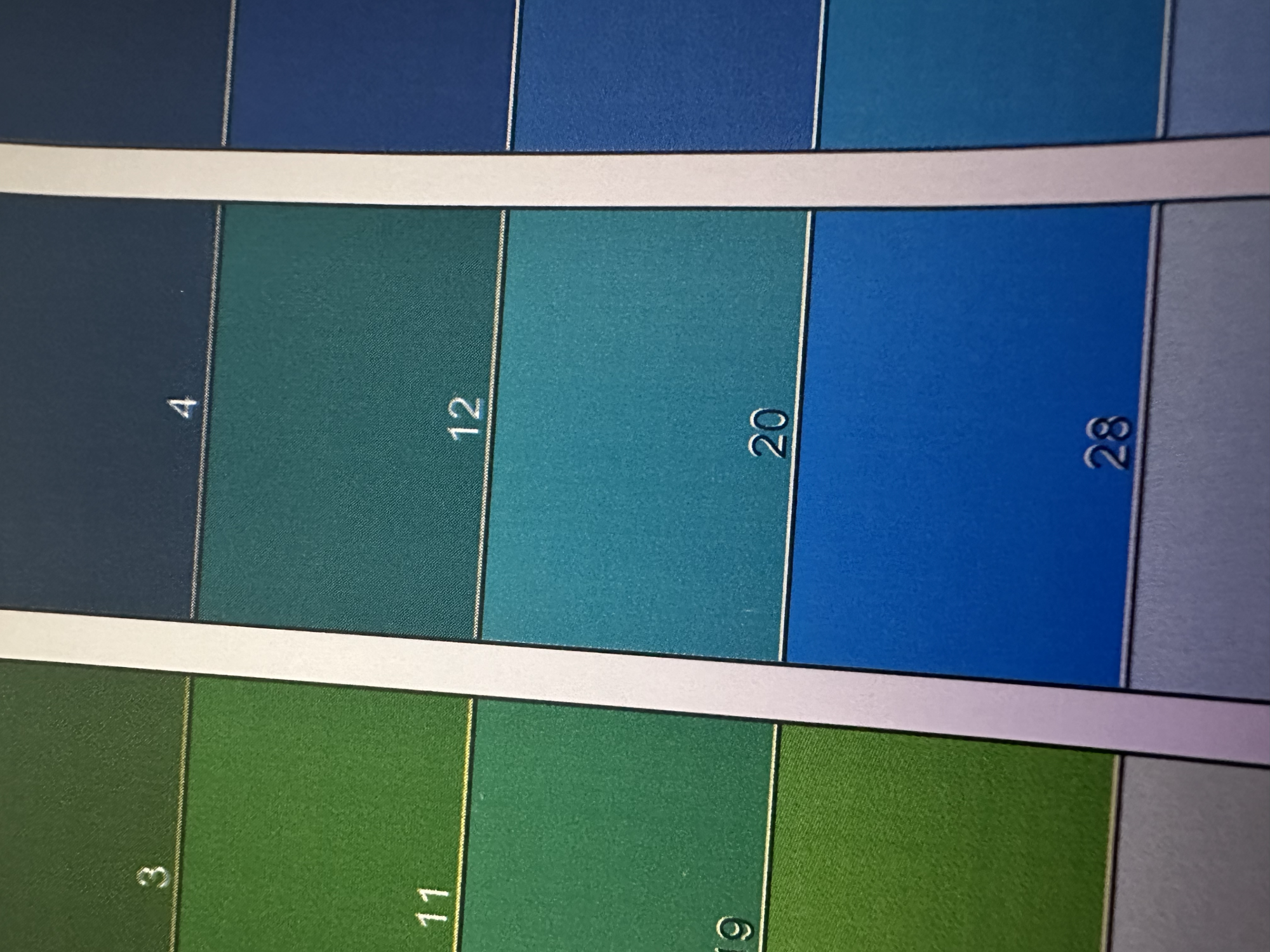

I got my OKI printer but all the things got out the printer misaligned. A technician came to my house and couldn't solve the problem. I had no other option than return the printer again and just give up on A3 printing.

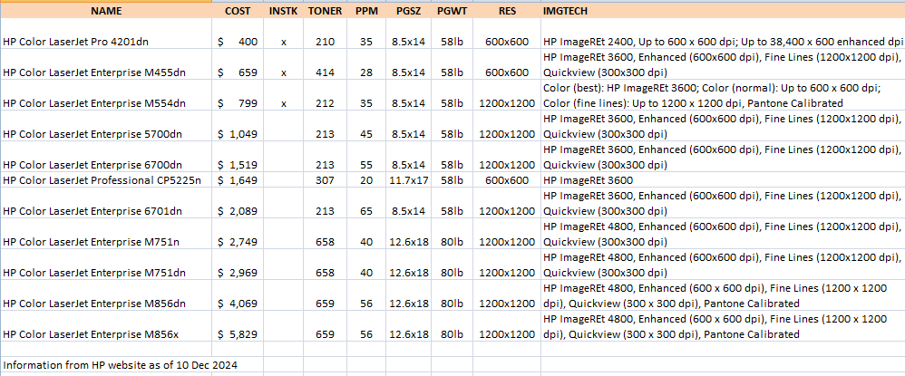

After reading through this entire thread I was convinced to go with HP and ImageREt. As ZombiePhysicist noted, there's no way on the HP site to filter by ImageREt, so I went through all their offerings and made a list of all the current models that offer it. I don't include MFPs in the list, for reasons of cost and durability.
I wanted at least ImageREt 3600, and at least 1200x1200 dpi max res even if it didn't use that for ImageREt. I was willing to do without tabloid size.
I didn't really have to waffle much. The M554dn meets the minimum and came in at $799. To get ImageREt 4800 at lowest cost would be the M751n at $2,749. Getting ImageREt 4800 at and tabloid was tempting... but at 3.5x the price just a bit too much.
I ordered the M554dn from Amazon and received it in 2 days. It was up and running in short order (some setup hiccups, of course, but no support calls required. Printing from a Win10 system. Will connect a Mac later.).
I printed out some samples of photos I had printed years ago with the i9900 and it's pretty impressive. Using HP 52lb gloss. As long as viewed from a distance beyond which the half-toning disappears, a bit less than arm's length for me, they're virtually indistinguishable. Probably the most noticeable difference is in light skin-tone highlight areas, where the laser tends to fall apart a bit more. But it's not nearly as bad as I worried it might be, and acceptable to me.
