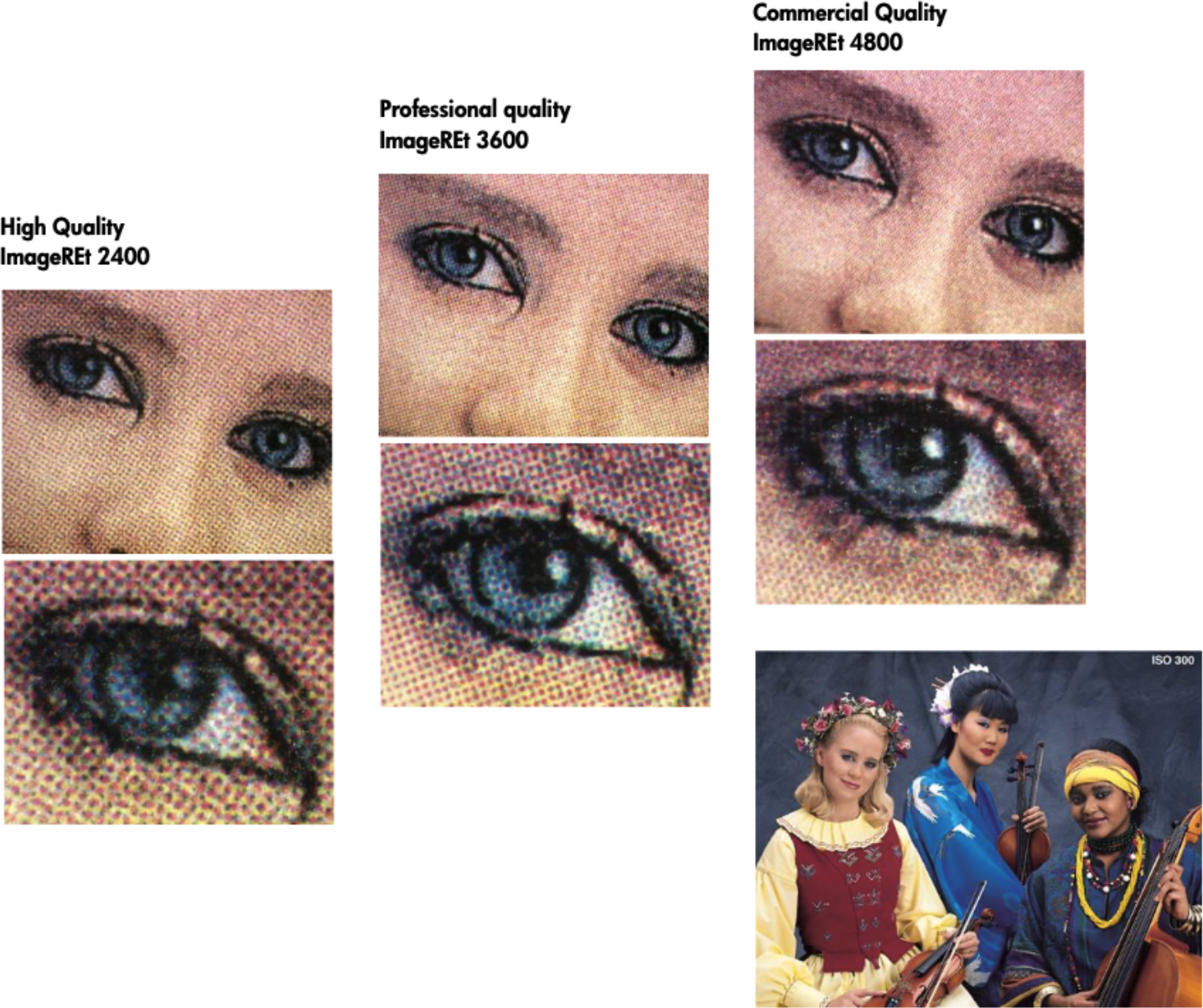

So I found this article which has some really nice explanations but still confused.
The TLDR kind of summed up in one photo is this:

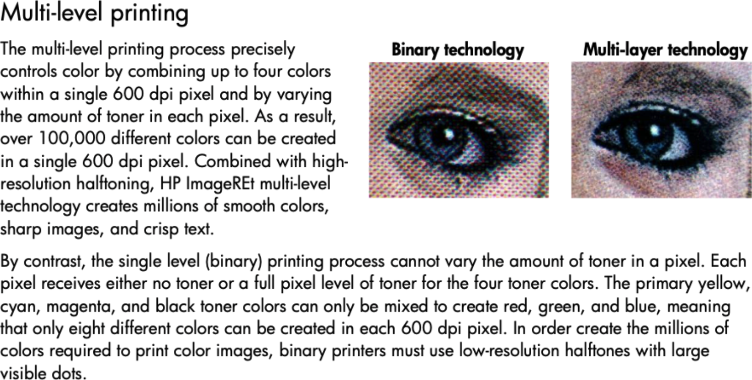

And this explanation, if true, matters a lot:
If you have 100k colors inside 1 pixel, that is hella bit depth. That's a bit more than 2^16bits per dot color bit depth. Which is huge.

That's quite the find. Personally, I'm partial to the "binary technology" because it feels most like a magazine and I particularly like that aesthetic, but I can definitely see how the multi-layer is definitely the better one. And here I was thinking that like scanners, printer technology hasn't really advanced much in the last 20 years.
I'm generally hesitant when I see "enhanced" technologies in place of actual resolutions (makes me think of the megapixel arms race on camera sensors), but if the marketing claims are even half true, that's pretty good.

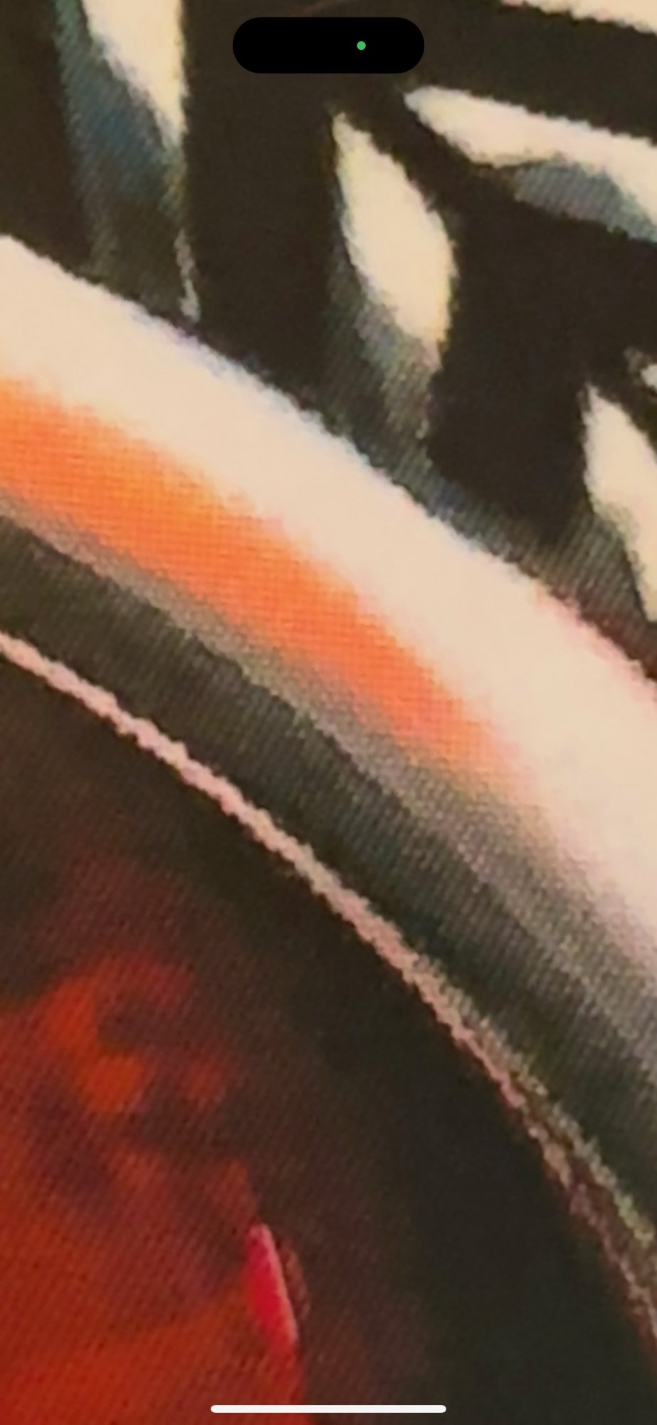

So check this out at close up you can see it has a very very interesting half toning.
This may be the most interesting view, not in too much and you look hexagonal grid looks like solid watercolors:

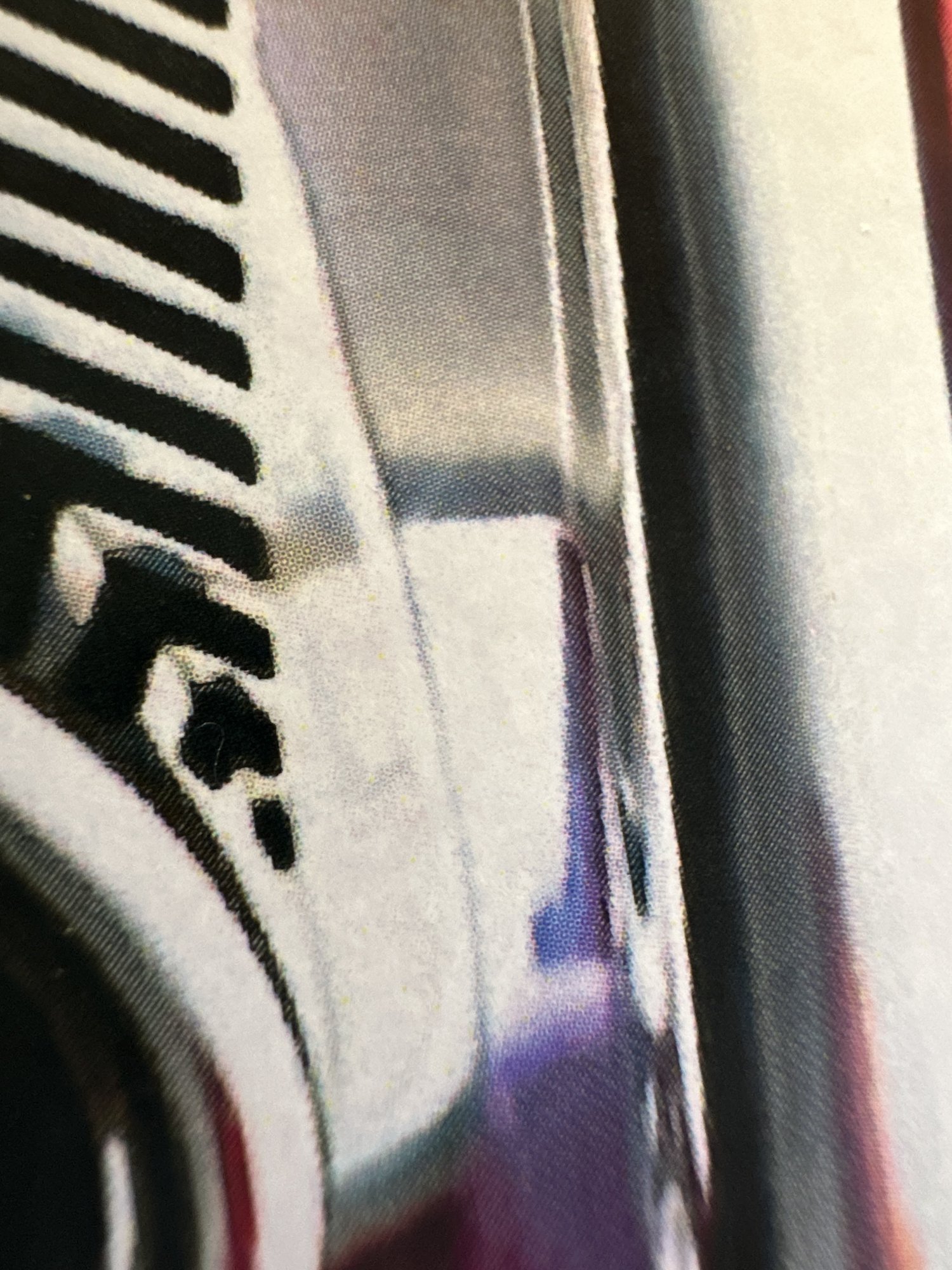

If you look at that above you would be absolutely convinced the printer is mixing colors unlike any laser color printer I've ever seen. But I zoomed in even more and you get to see what's really going on, which is still super impressive.
So below you can see teh half toning. But even here while it is halfoning, it's better than anything I've ever seen. It looks better than magazine half toning I've seen. And it clearly is still mixing toners to make true real colors its halftoning with:
Color lasers usually print chrome like poop. This thing is total rockstar territory. Really super super impressed.
