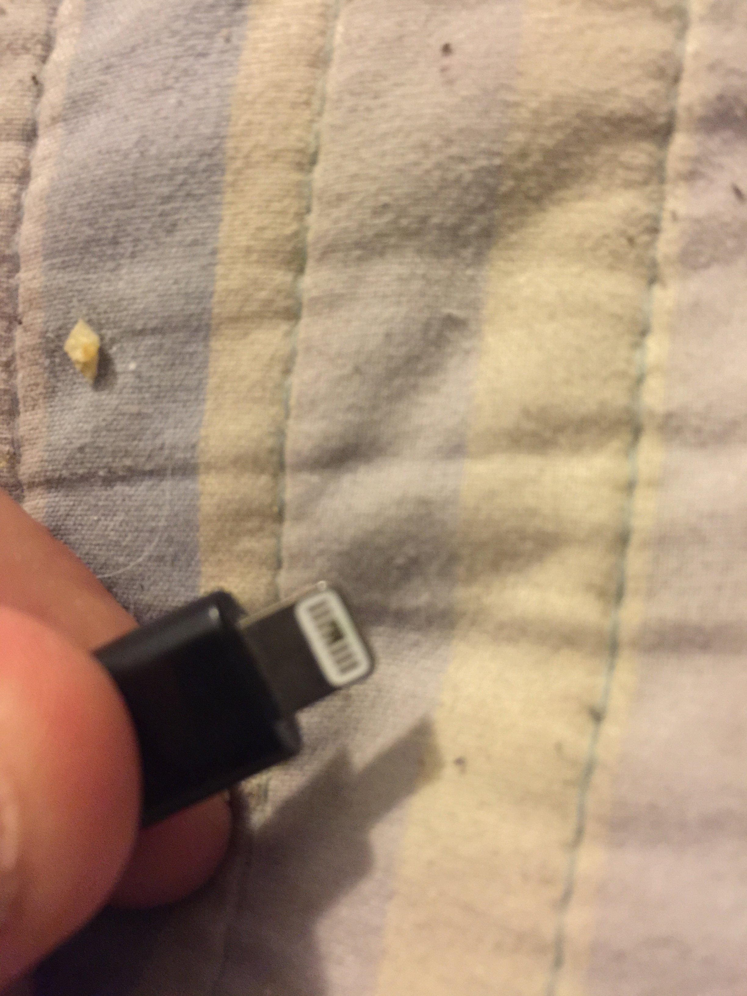

As anyone experienced this? I seem to get it on every single lighting cable I ever had
Reactions: autrefois
Pic is too out of focus. Anyways, that doesn't seem to be an official Apple cable - does it happen to them too?
I noticed something similar on one of my official cable. In my case it looked like corrosion on one of the contacts, and the charging was a bit wonky, so that cable is now retired. Possibly that is what has happened to your cable, but maybe not.
Reactions: input_expunged
