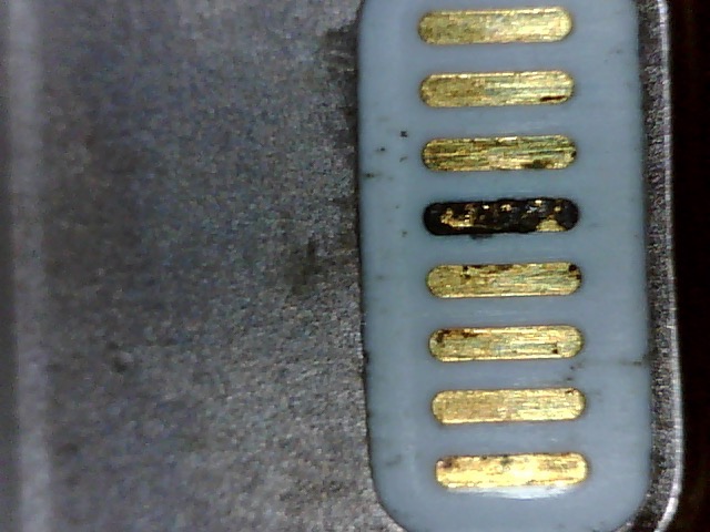

I would say the black spots are coming as the plugin contacts have worn out from the surface and the black spots are because of the low voltage sparking on making and breaking contacts. I have bought an adapter from the 8 pin to a micro USB from Amazon for a mere 1.5 $. Now I have purchased the adapter, and have put it onto the phone slot and use the micro USB cable to charge when at home. I remove the adapter only when I go out. Its working fine for the last two days. Shall revert after a fortnight with my experience.

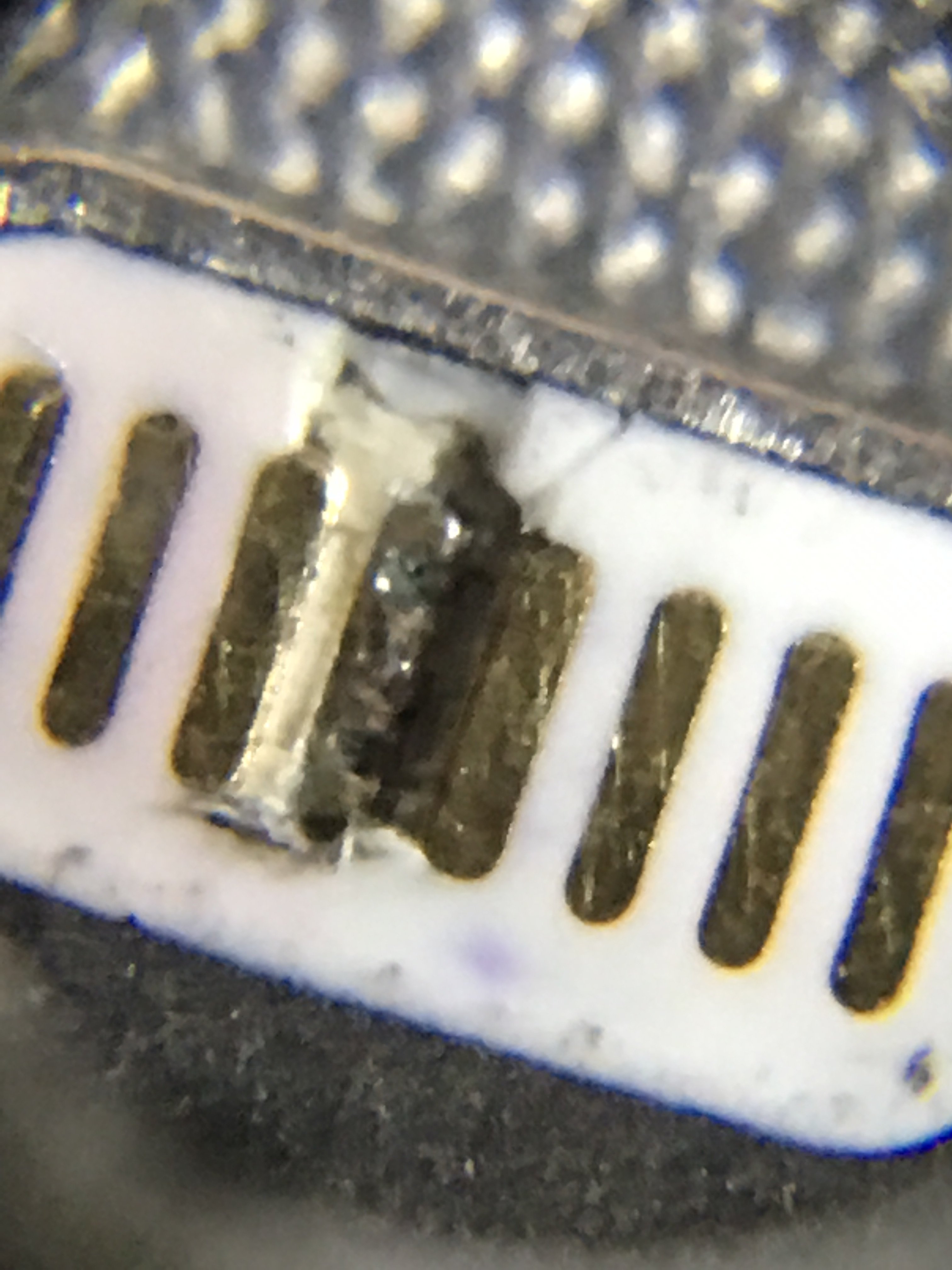

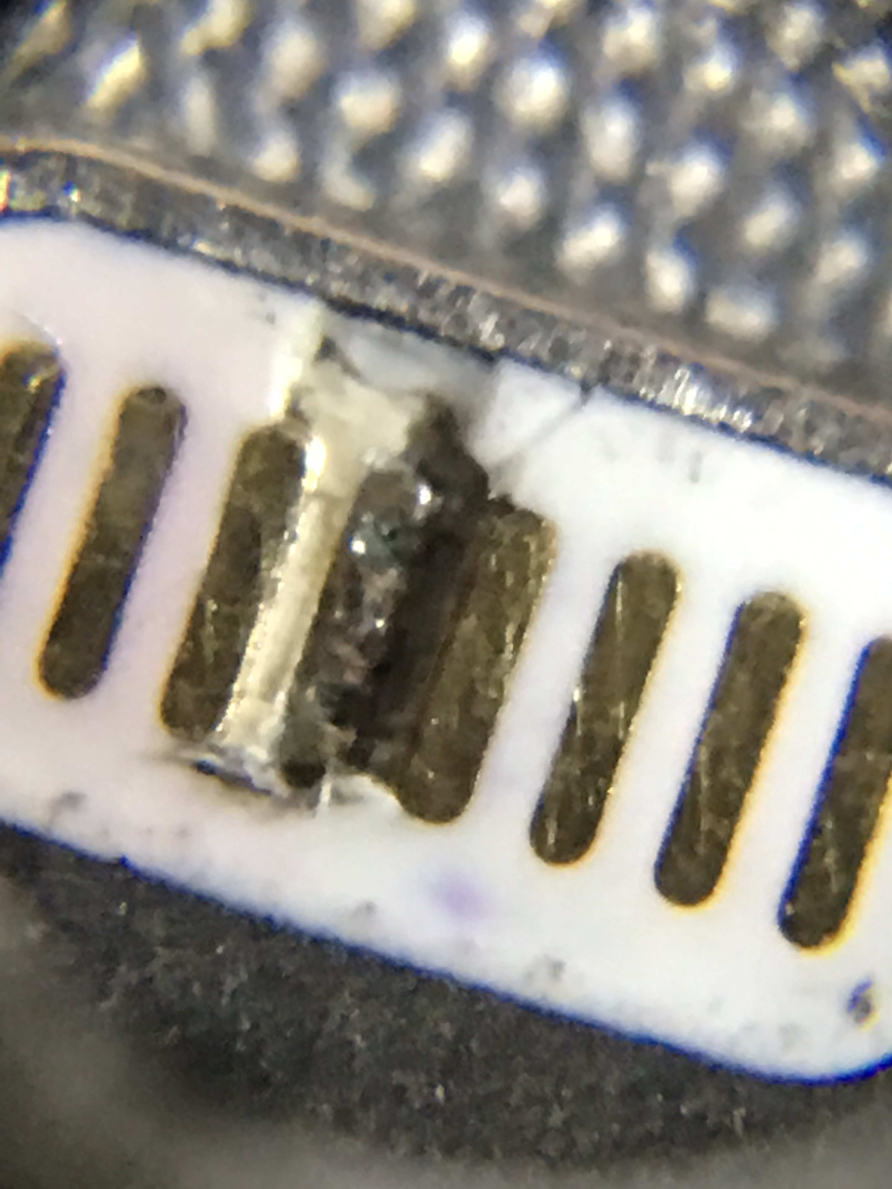

Please note these microscopic images of a failed Lightning cable - this caused the attached phone to keep "beeping" as if the charger were just attached.
View attachment 741484 View attachment 741485

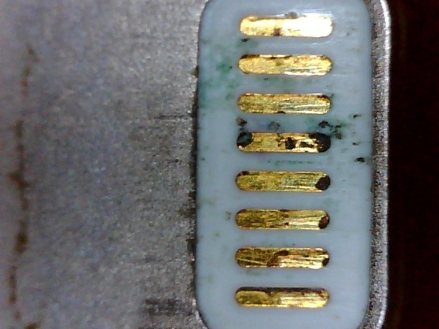

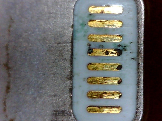

I havent read through every single post prior, but i do have some input into the black mark scenario. I chew through iphones and reviewed this thread prior to my last visit to the apple shop. I constantly break phones with the black mark and apple are shady when it comes to dealing with it. When i went back with my previous phone that was working they classed it as water damaged and refused to replace the phone that was under warranty, so i bought a new one and six months later the same thing. They then informed me i was classed by apple on there system as a high risk user. So i had to figure out what was going on, cause you dont want to be classified on there system in that category. They will not deal with you. I have done two things that have changed the situation in relation to my use 1, I do not charge my phone over night, like i did previously. The additional hours of charging through the port are detrimental. 2, I always clean off the cable pins before putting it into the port, i also put the charger in a drawer after charge. A lot of the time it was on the floor or carpet picking up fluff. From my experience, only charge the phone when it needs to be charged 1-2 hours every 24hrs. If you already have the black mark your phones on the way out, you've damaged the pins already. Flicking front and back when inserting the cable will only work for awhile, replacing the cable will only work for awhile. You need to change your phone habits to avoid the issue in the future.
[doublepost=1526091271][/doublepost]Hi Guys,

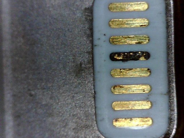

... there's a black/burnt mark on the 4th pin....
That is pin number 5 (you may have been looking at a numbered diagram of the socket).
This is relevant, rather than pedantry, if you want to be able to read pin allocation table.
Pin 5 is the 5V power line. If it still works don't worry about it. But it is worth preventing dust / fluff build up in the socket (in any socket) using a suction cleaner (don't poke things in it).
Particles that get trapped between the power contacts can burn.

I have done a ton of reading. The explanation on the previous page is fantastic; check it out. However I have been digging further. A commonality is that this is especially bad when lightning cables are left out in cars. I have now, finally, found someone else with my issue - the mysterious teething child. I don't understand why these things look delicious. They aren't.
Both those things have the same symptom; the introduction of moisture. Cables left out in the freezing cold car all the time (overnight) and toddler saliva allow that arcing to get worse when it's used. That's where the carbon comes in via chemical reaction.
Two bone-dry metals will not exhibit this; or at least not as bad or as fast as we in this thread are noticing. Working out with our devices (sweat; light rain, high humidity) being left in a car (condensation) toddler teething (saliva) will all leave a trace of moisture on the cables even after being wiped off, and when plugged in, that arc zaps a nice little deposit of carbon remnants on the dreaded 4th pin (which I've seen and forget offhand its particular purpose).
So that's my input. The pencil eraser trick of rubbing the crud off works like magic; carbon vs eraser should be obvious but I have to say I wasn't the one to think of it! Eventually, that carbon corrosion eats away enough of the contact that the cable will be ruined someday anyway. This problem is like rust on a car - once it starts, it isn't going to stop, and you can either spend countless hours combating it or just start fresh and prevent it in the first place.

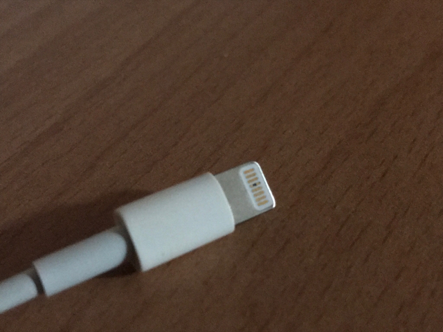

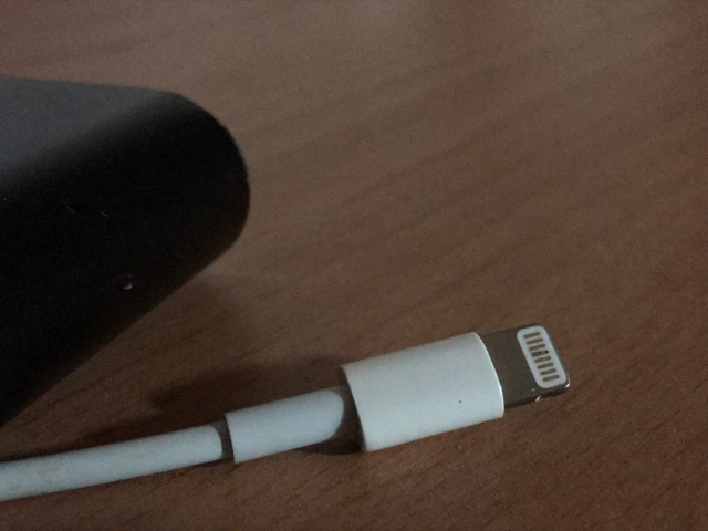

Bought an iPhone 7 about a month ago and I noticed that on each side of lightning connector there's a black/burnt mark on the 4th pin. This was the stock charging cable that came in the box. When charging the one side seems to work fine but when I flip it to the other side it tends to disconnect intermittently. Is there any particular reason why this should happen?and what are my options, should I worry that this damage could extend to the lightning port of the iPhone as well?
[doublepost=1540692075][/doublepost]That’s what it looks like up close

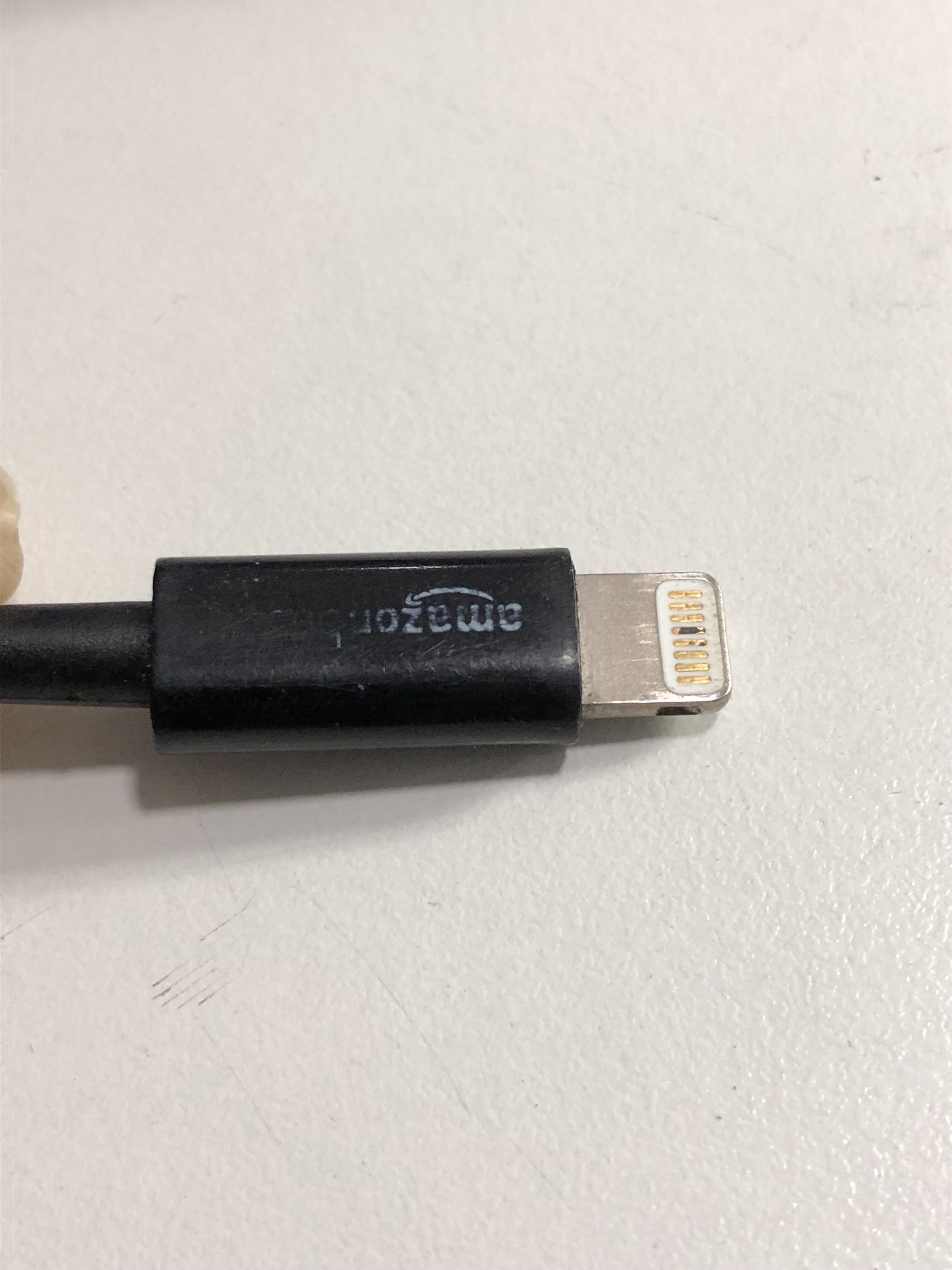

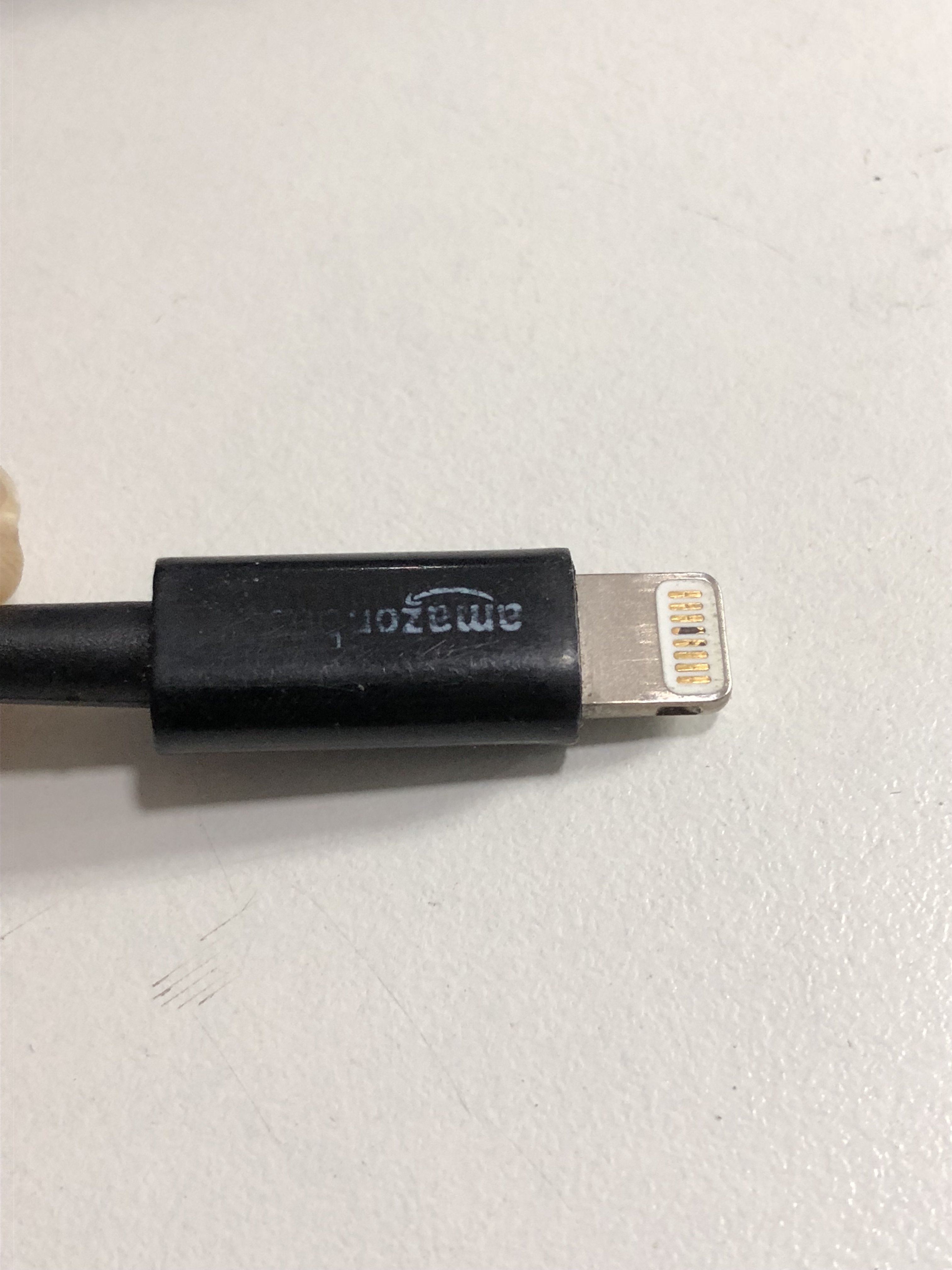

As anyone experienced this? I seem to get it on every single lighting cable I ever had
[doublepost=1543453391][/doublepost]Based on my experience the black residue is copper oxide produced during sparking/arcing as cable is connected. I would suggest that you plug in the power adapter AFTER connecting the charger to the device. Should prevent sparking at the connector. Of course my theory fails if the referred to contacts do not carry power,.... haven't checked.
