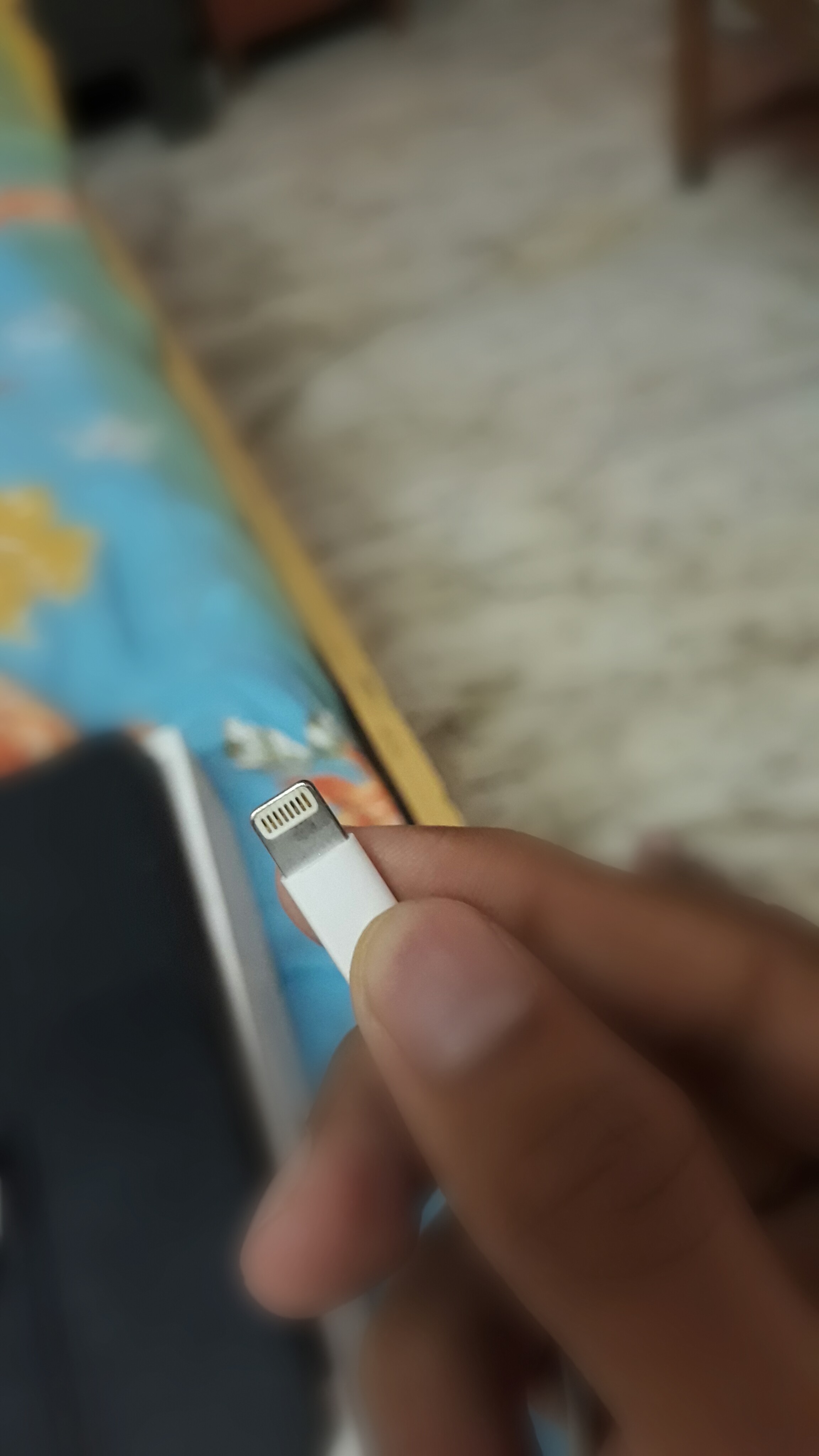

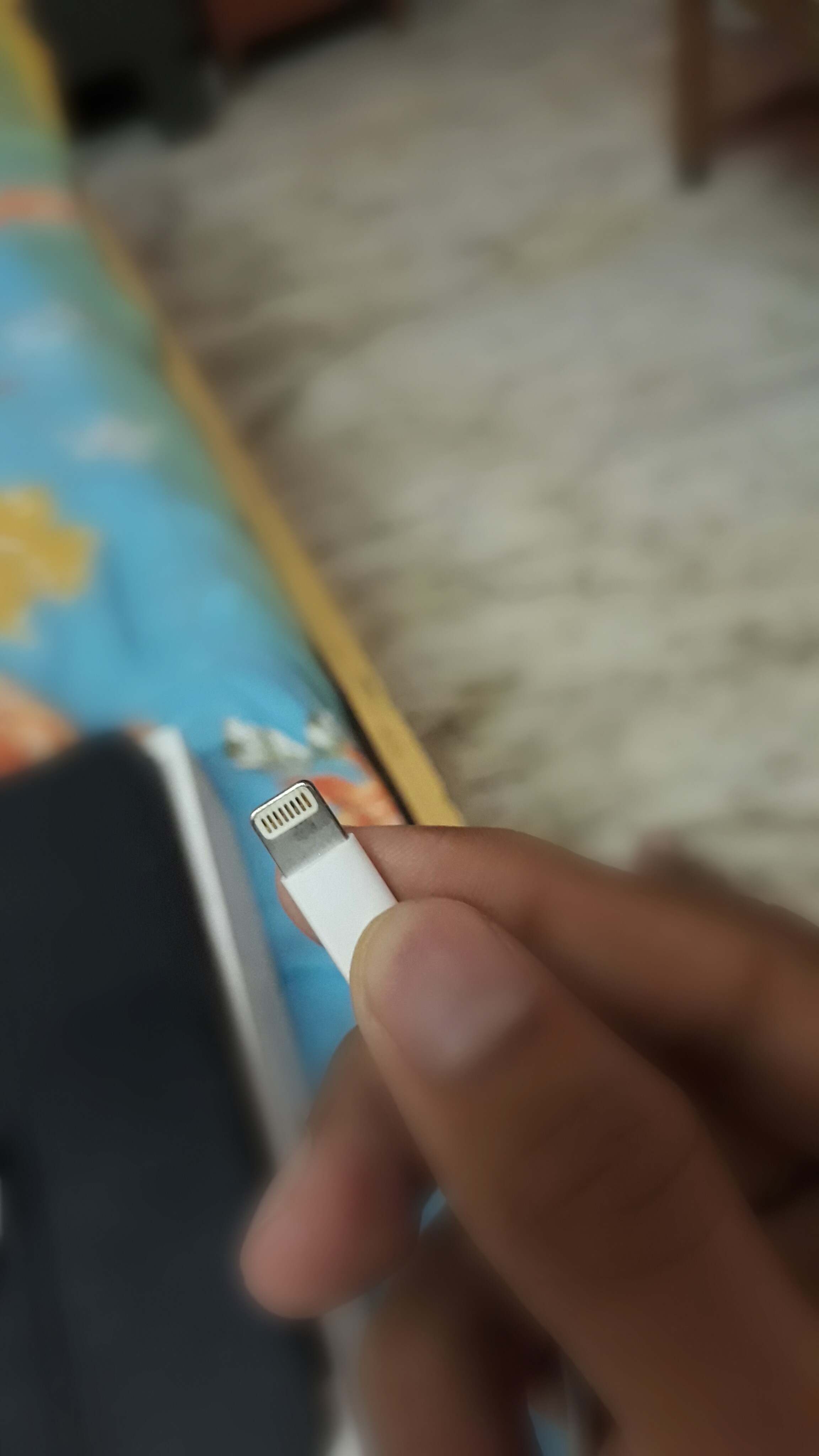

Not sure if this is in the correct forum but can anyone be kind enough to help out
Thanks
I have faced this both with the original cable of Apple and replacements. The solution I have found is NOT TO PLUG IN OR REMOVE THE CABLE WITH THE CHARGER POWER ON. SWITCH OFF THE POWER AND THEN PLUG IN OR PLUG OUT THE CABLE. This has prevented any such blackening for last two years.
Try it, it works.
Might be casued by a little arching... Either way, you can probably clean it with a pencil eraser.

Bought an iPhone 7 about a month ago and I noticed that on each side of lightning connector there's a black/burnt mark on the 4th pin. This was the stock charging cable that came in the box. When charging the one side seems to work fine but when I flip it to the other side it tends to disconnect intermittently. Is there any particular reason why this should happen?and what are my options, should I worry that this damage could extend to the lightning port of the iPhone as well?

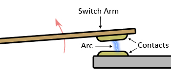

When you connect the cable, electricity arcs between the contacts before they touch each other. It's literally a mini-lightningbolt. I guess that's why they called them the "Lightning Cables" (just kidding).
This is what arcing looks like:
When the contacts touch, there's no lightning bolt anymore. But there is one in the brief moment when the contacts make contact...
The lightning bolts leave carbon (coal) deposits on the contacts... aka burnmarks.
Those marks can build up thicker and thicker carbon deposits until they no longer conduct electricity.
The biggest danger is if the buildup happens inside the port on the device, and ruins the port instead of just the cable.
