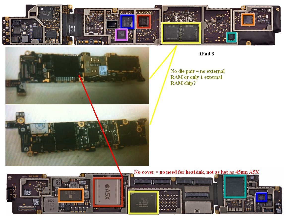

If it's not a quad-core GPU, it's not an A5X variant, it's an A5 variant. Also, as OP mentions, RAM on package is essential. So while through process shrink and underclocking it may be possible to fit the RAM without the heat concerns of the iPad 3, I think we're much more likely to see a 32nm A5 variant with tweaked GPU and/or CPU cores (including quad possibility).
I don't think we'll see quad CPU or GPU though because it seems excessive given how iOS runs and the iPhone resolution.

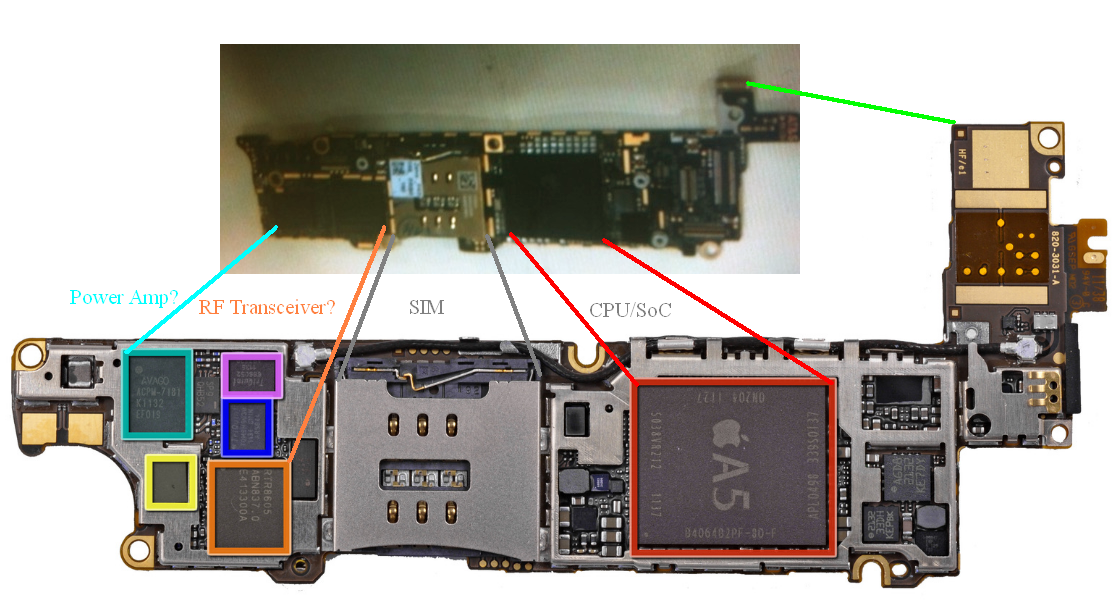

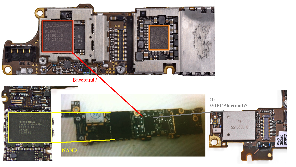

Let's dive in. 4S/iPad 3 photos courtesy iFixIt.
http://www.ifixit.com/Teardown/iPhone-4S-Teardown/6610/2
http://www.ifixit.com/Teardown/iPad-3-4G-Teardown/8277/3
