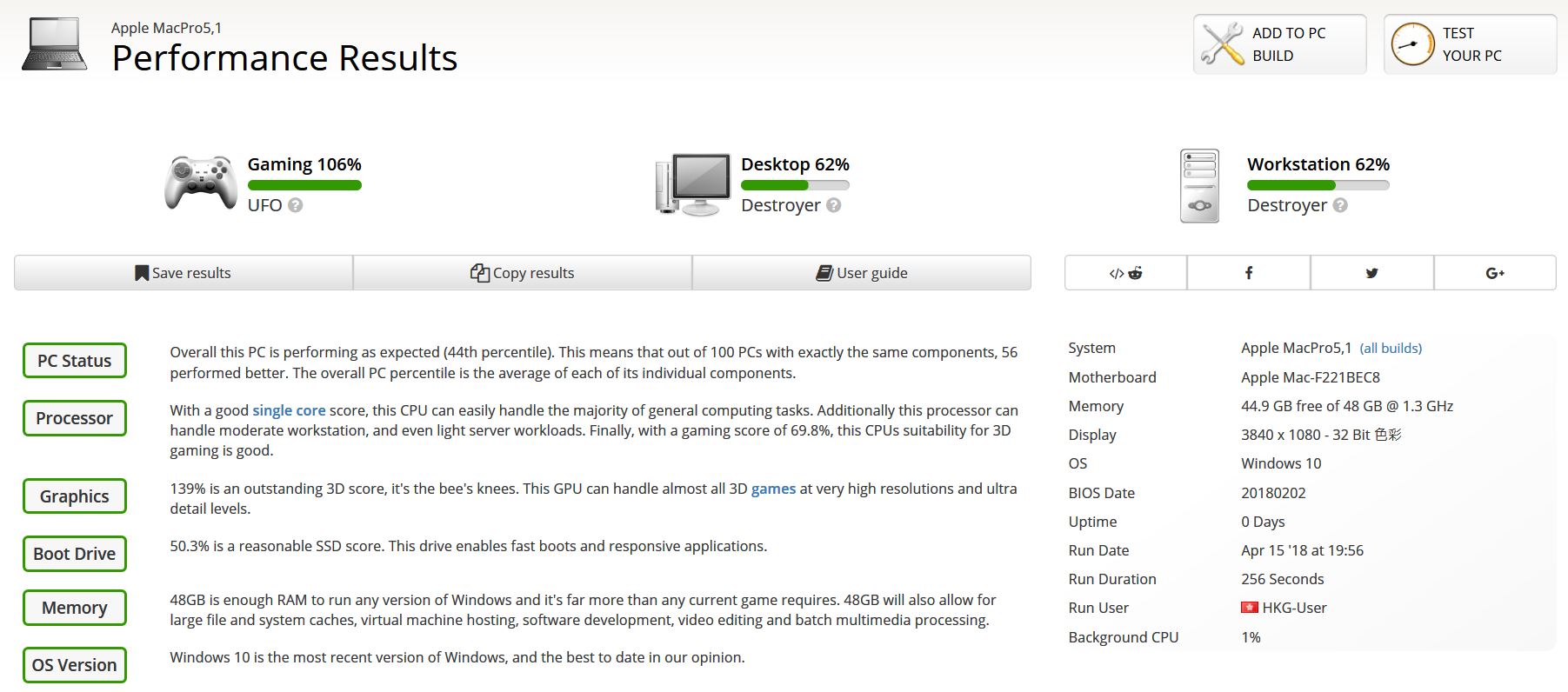

I think you’ll want to max out your CPU from the start, which would be the x5690. Ive found that a single x5690 performs fairly similar to the i5-7500 in my iMac on most things. Yes, the 7500 has newer instructions and all that, but the extra coresand threads of the x5690 help make up for that.
The 3.46GHz Xeon is actually not that bad for most day to day task.
