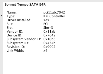

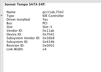

I knew it Caldigit RAID card - total crap.So many ppl on here braging on a card they neva saw LOL = ill stick with my CRAPPY(just kidding)Tempo SATA E4P😱

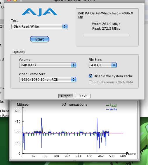

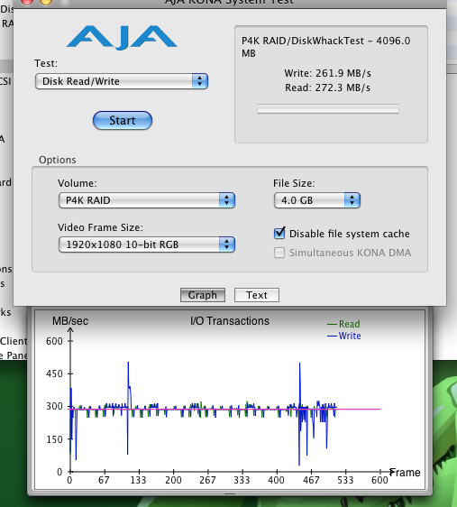

I love it driver updates every few months stable as a table being able to hook
up 2-20 yes 20 hardrives is more thane enough speed get it you cant go wrong.

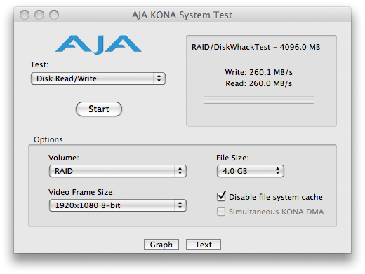

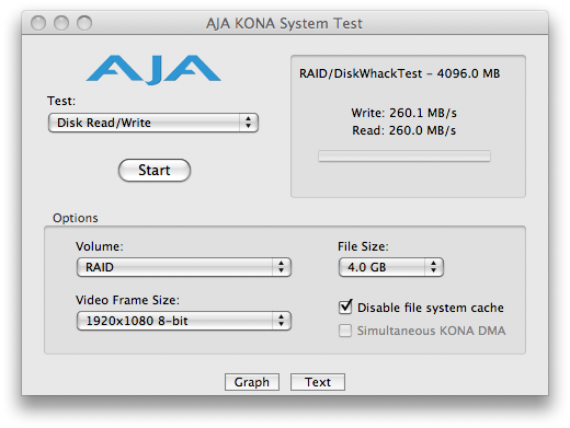

I've got the CalDigit card running properly now. Creating a RAID 5 array with two slices (300Gb and 1.7Tb) worked and it will now boot.
Although it's been a pain in the arse to set up I certainly can't fault the performance. 260Mb/s in RAID 5 with 4 drives is pretty good.
