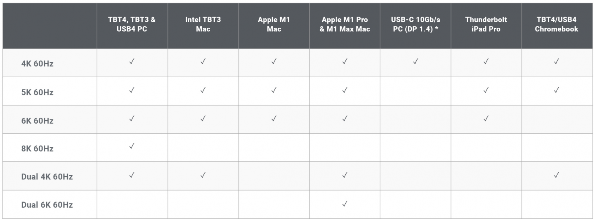

There are people claiming in another thread that this dock can connect (2) 6K displays to an M1 Pro.
There is no other Thunderbolt 4 dock in existence that can do this, and they all use the same tech. So I'm curious where this claim comes from.
It's a claim that CalDigit themselves are making on the product page. Also very curious about that, because as I understand it, Thunderbolt 4 don't have the bandwidth to allow two 6K60 displays over a single Thunderbolt port
I truly think people are just getting confused here, because this doesn't look like a chart of what the Dock can do. It looks like a chart of what the machines can do.
I see now that its not just the chart, the website text says dual 6K displays, but that makes absolutely no sense. There is no reason why this dock could do that while every other Thunderbolt 4 dock cannot. This is not made possible by the dock.
There's a picture of it on their site with two Pro Display XDR connected.
