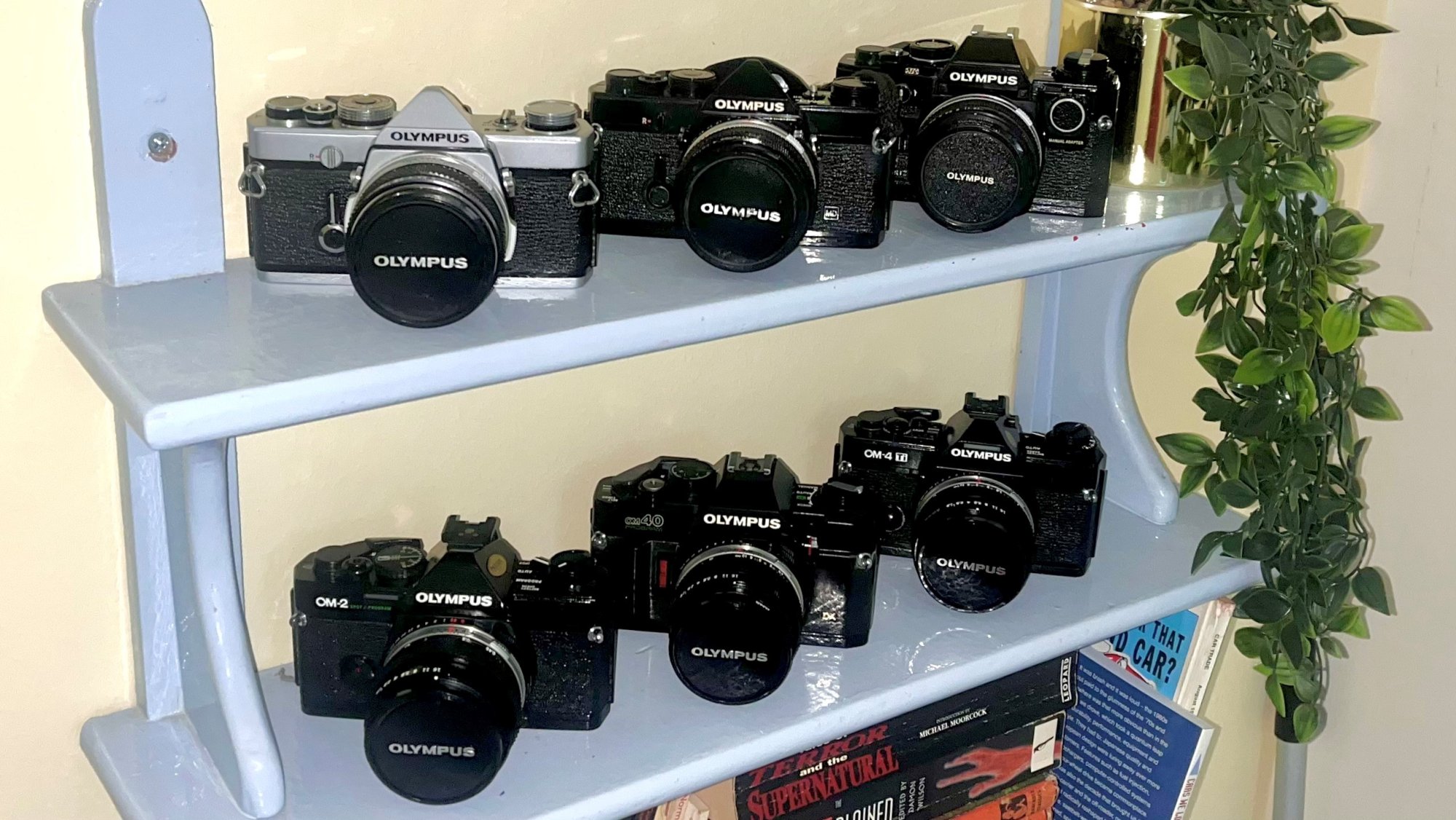

Is it OK to post photos of our gear here? I guess I'll find out.
On the analog-photography front I'm a bit of an Olympus-holic, which all goes back to my dad's Olympus OM10QD which he owned when I was an impressionable young teen. I now have six Olympus SLRs (pictured below), plus a 35RC rangefinder, a Trip 35, and a Yashica FRII, which was the camera my dad owned directly before the OM10QD.
I was always impressed by how Olympus cameras did things just a little bit differently, such as having the shutter-speed dial round the throat of the lens aperture so that speed/aperture/focus could all be adjusted with one hand with the camera to your eye. Of that collection, my most recent aquisition has been the M1 on the top left, which took me years to find in great condition. My most treasured would be my Dad's OM10QD (top right) and my OM4Ti (bottom right) which i purshased second hand for £350 in 2001 and was the camera I took into hospital to take photos of my premature twins in their incubators in February 2002. The OM10QD needs a fresh lens cap because I dropped the original overboard a boat in Torquay, Devon, England, in July 2000, taking this shot (film was the much-missed Fuji Sensia):
