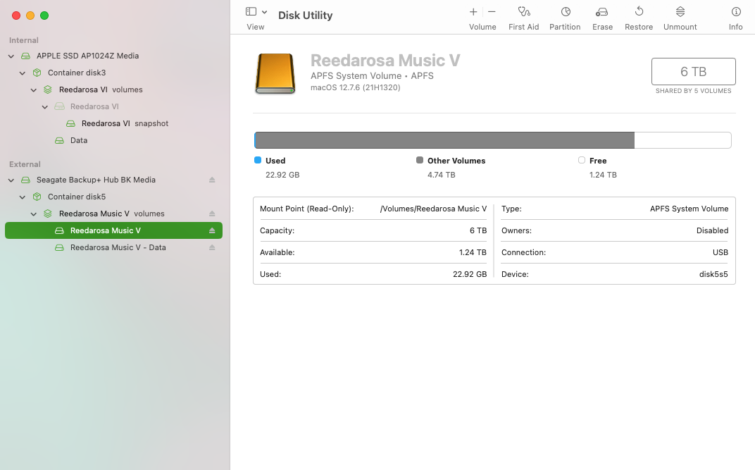

My Mac stopped booting up. It was stuck on the Apple logo, so I installed an OS on the USB drive so I could fix the internal drive. That worked fine until I went to access the USB external drive (6TB) and found out I could not access any other files. Disk Utility shows the files are still on the drive but under the name “Drive Name - Data”.
How do I gain access to the other files?
Thanks in advance.

In Disk Utility it shows up:
Disk Name -
Type: APFS Data Volume
Owners: Disabled
Available: 1.24 TB
Connection: USB
Used: 22.92 GB
Device: disk5s5
Disk Name - Data
Owners: Disabled
Available: 1.24 TB
Connection: USB
Used: 4.74 TB
Device: disk5s1
I hope this helps and is not too much information.
Thanks again.
I really was hoping for the output from "diskutil list" Terminal command and that would still be useful. You also haven't said what "My Mac" is. Is it also running Monterey like the 2013 Mac Pro? Is it also an Intel Mac?
But from your screenshot, your Seagate drive appears to have a macOS system in it using Music V and Music V - Data. This is where diskutil output would help to clarify things. And both seem to be mounted.
What do you see if, in Finder or Terminal, you look in /System/Volumes and in /Volumes?
Without more evidence I am just guessing that there is a mismatch between the operating systems on "My Mac" and on the 2013 Mac Pro and in some way this has messed up the mounting of the Music Video - Data volume.
