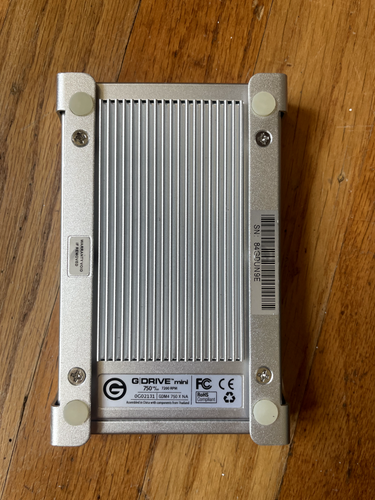

Im a huge fan of the Hitachi mini G Drives. Ive got a couple, they're small, solid i/o options, they're powered through fw800 and the fit and finish is awesome. Plus, if you want, you can totally stick a high capacity SSD in there without bricking it which is what Ive done with both of mine as I picked mine up real cheap due to small capacity drives. The linked one however has a pretty decent 750gb drive in it already.
Not my auction but an excellent example of what I'm talking about and Good luck 🙂
