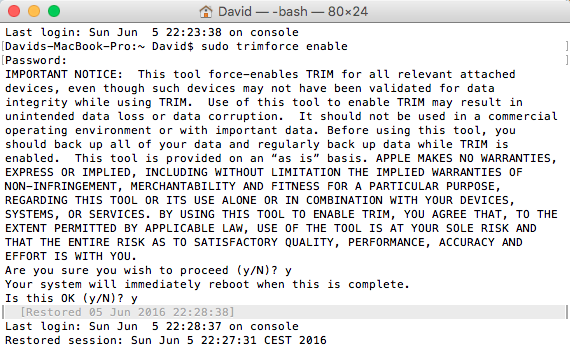

Hi,
I've replaced the hard drive of my MacBook Pro Mid-2012 running 10.11.5 by a Kingston SSDNow V300. Once installed Mac OS X, the first thing I've done is opening terminal to enable TRIMby using "sudo trimforce enable". After automatically restarting, I've checked the TRIM status on the System Information app, where it shows that it's still not enabled. Trying again I've realized that after confirming with the "y" twice when enabling TRIM, Terminal should show "Enabling TRIM...", then two more dots in the lines below and then "Operation succeeded. Your system will reboot momentarily, please wait...", as I've seen in some snapshots of the process I found on the internet. I my case, however, it's shown the "Enabling TRIM" and one dot, and then the system suddenly restarts. After restarting, Terminal is still open and it shows something like this:
"[Restored 05 Jun 2016 22:28:38]
Last login: Sun Jun 5 22:28:37 on console
Restored session: Sun Jun 5 22:27:31 CEST 2016"
It seems that the SDD I bought indeed have support for TRIM, but somehow it can't be enabled in my case.
Does somebody know why I'm not being able to enable it, or have it happened already to somebody? I've searched for a while in the forums but I haven't found the answer.
Many thanks!!
i've similar problem, Sandisk X400 SSD - no problems enabling trim - now on this computer, after the terminal command to enable, system restarts, but trim support remains - NO. Bizarre... this is not a clean install, it's a restore from standard drive.
While the 10.11 betas required SIP to be turned off, it's hit or miss with SIP enabled for production 10.11+. For maximum reliability, it's best to disable SIP before using trimforce to enable TRIM.

That SSD uses a SandForce SF-2281 that is very commonly used with SSDs and you should have no issues using TRIM. I have not seen reports of TRIM under OS X with that specific SSD mode, but there are many reports of it working fine with that controller.
Thank you all for your help!
I can't remember if I had SIP enabled or disabled, but I eventually got to enable the TRIM support. I think I didn't change anything, I just tried 2-3 more times and finally got the "Operation Succeeded" message. A few seconds ago the Mac restarted and when it rebooted TRIM was enabled.
When 10.12 was released, after formatting the SSD drive and installing, I was able to enable TRIM after the first attempt. I actually had disabled SIP before for other purposes, but recently I replaced the HHD for a SanDisk SSD on a friend's MacBook Pro and I was able to enable TRIM also after the first attempt without having to disable SIP.
