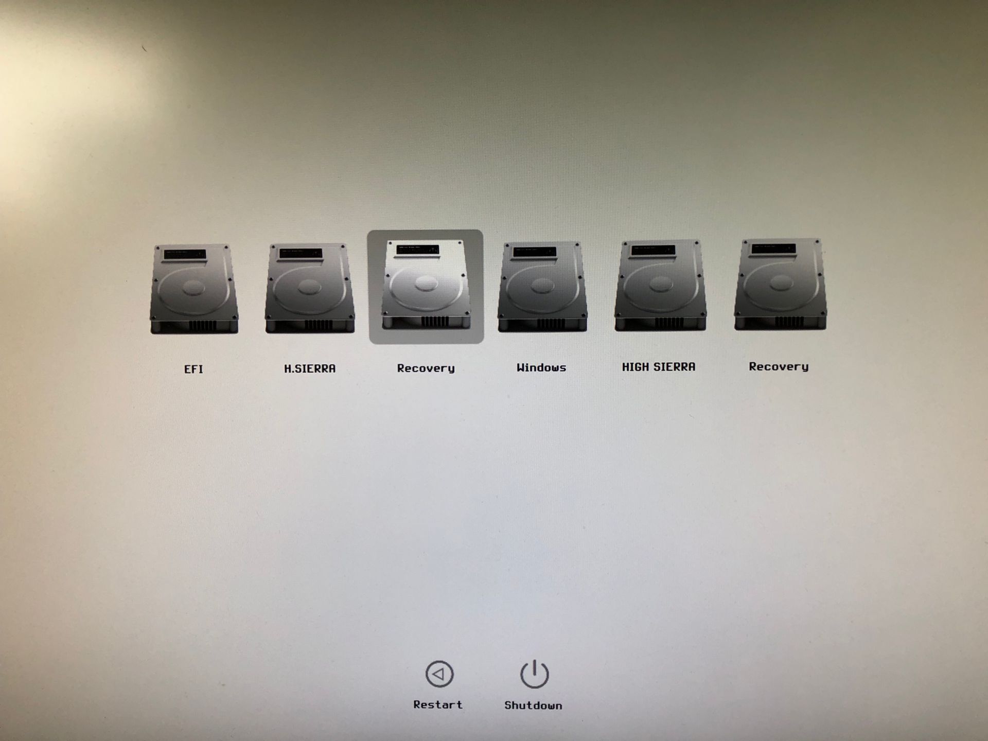

You know I actually wouldn’t mind going through the hassle of doing that. Is there a guide on YouTube for since or already a thread that I could follow ?
OpenCore window 10 and macOS on single nvme with adapter
