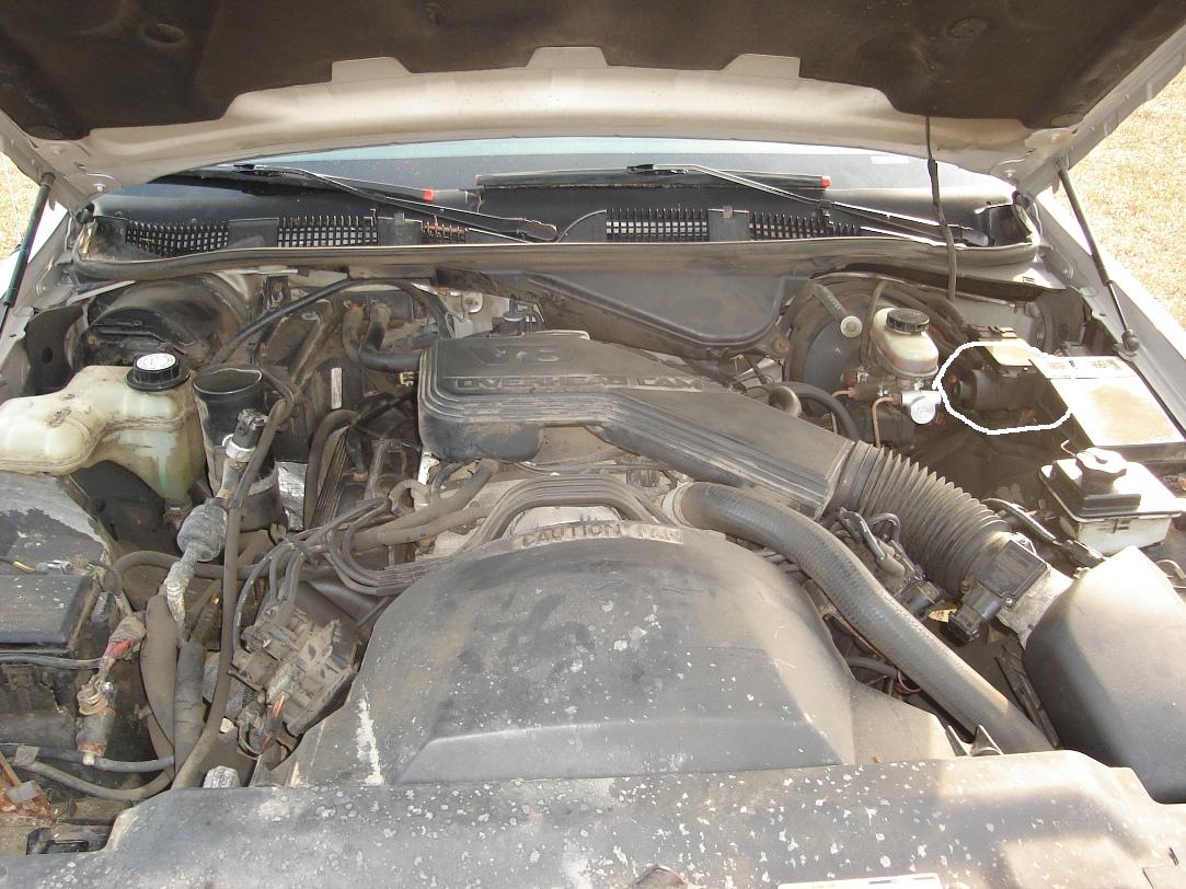

I found a picture of a Grand Marquis (older but probably similar as the platform is shared. The starter is the part I circled.

The starter is on the bottom of the engine and can be be seen from below. It is about 4 inches in diameter and about 6 inches in length. After listening to your first video it sounds like the throw-out solenoid is is stuck or bad. You can lightly tap, with a hammer, on the starter about 4 times and if it is simply stuck it may loosen up.
Pictures of Ford/Mercury Starter Motors
The solenoid is the smaller cylinder attached to the starter motor in the pictures.
edit: Please do not jack up your car and crawl under it to tap the starter without using jack stands
