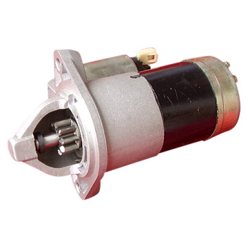

What is the starter/what does it look like/how do I hit it while the key is being turned?
Trust me, you won't be able to hit a starter and turn a key at the same time by yourself. Unless you are Mr. Fantastic. Also, I highly doubt that'll work in your case.
It is a black (usually) small thing near the back wall of the engine bay.

Starters are slightly bigger then a pop can and have a few thick wires coming out of them.

So if I call my local junkyard tomorrow morning and say "I need a starter for a 2000 Mercury Grand Marquis" then I am doing the correct thing?
And they say "That'll be $50".
Yes?
Then I say "Fantastical, I'll be there shortly (or longly)."
I go and get the part and it looks like BLANK.
Then I go to my car and start taking the same looking thing off of my car and put the new one back where I found the old one?
And I'm in great shape, yes?

Yes but who knows how long a junk yard starter will last...just take the old one out, go to the local napa, and get a new/reman one...they will probably knock 15-20 bucks off if you bring in the old one (core charge they call it)
Yes?
Assuming everyone here (including myself) is right about the starter being the problem. We have all guessed by the sound of it; we are not 100% sure, nor are we licensed mechanics.
