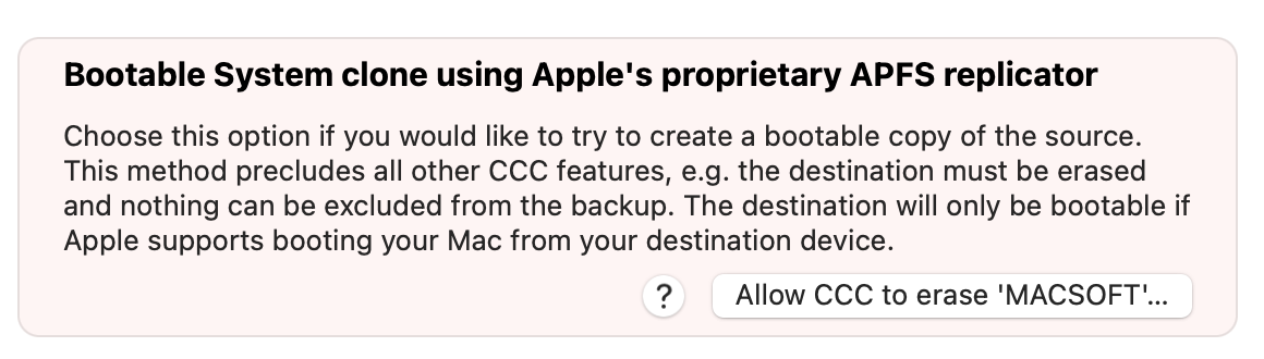

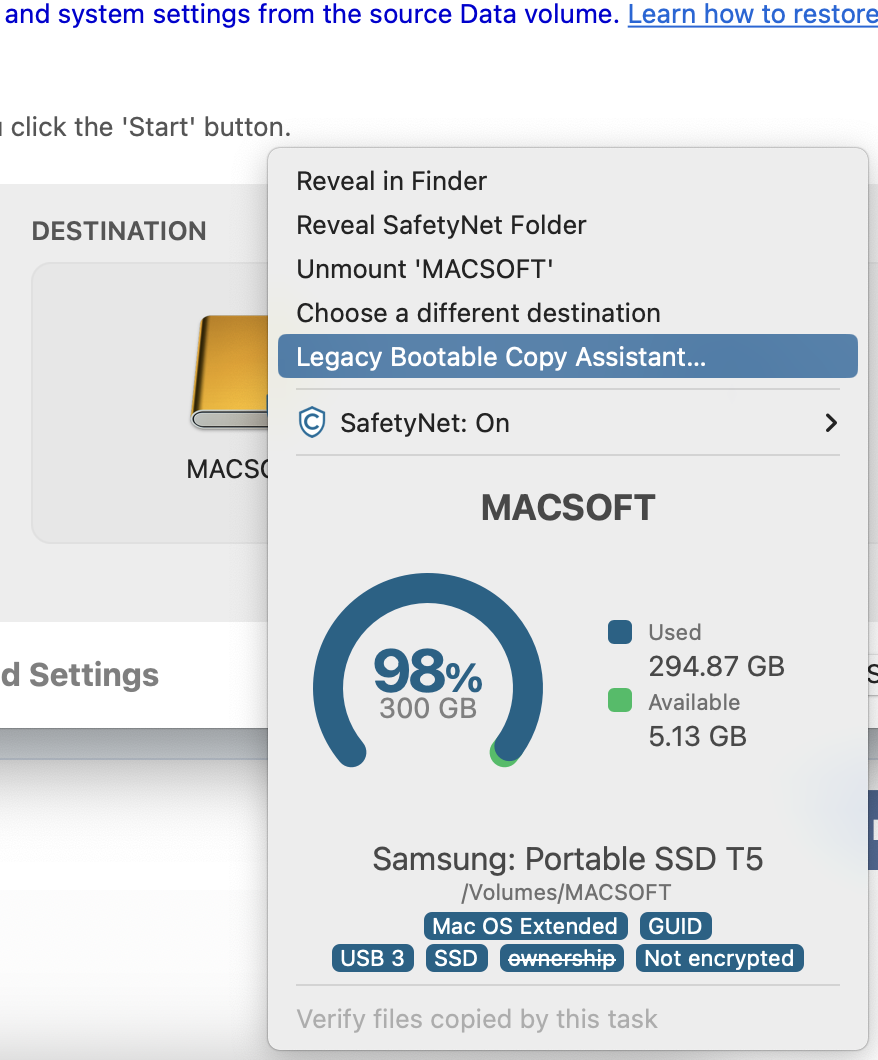

You need to right-click your destination disk, and then click "Legacy Bootable Copy Assistant".
On the next screen choose "Bootable System clone using Apple's proprietary APFS replicator". You need a empty disk for this type of backup.
