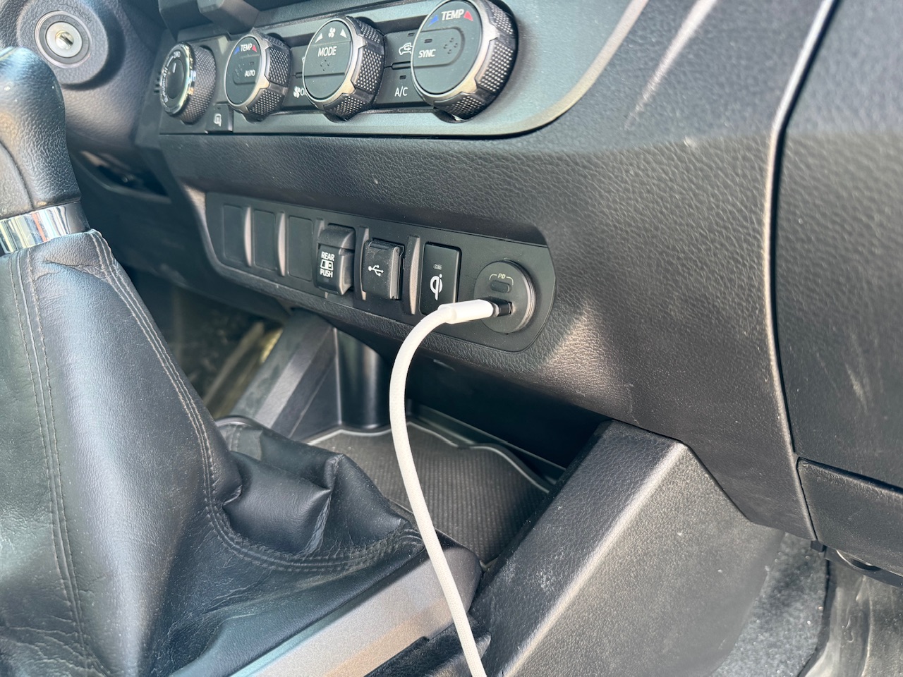

I bought a Scosche PowerVolt port to put in my Tacoma and it comes with a USB-A port for CarPlay pass-through. It gives you one of those adapters in case you want to use a USB-C to USB-C cable. I’m using the new 240W Apple C to C cable with that provided Scosche adapter and it all works great.
I am making the assumption that since Scosche gave me this piece literally for this function, it’s safe for the purpose.
All that said, the day Scosche makes a PowerVolt with dual USB-Cs (one for CarPlay, one for fast charge), I’ll definitely swap to that and keep the Apple 2m cable with it.
