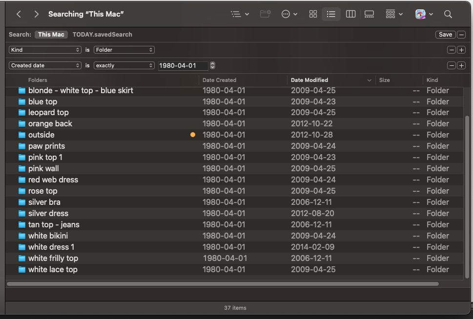

Hi does anyone know if there's a way to fix broken file & folder creation dates?
& also, how do I get folders to show the sizes, since it only works sometimes?

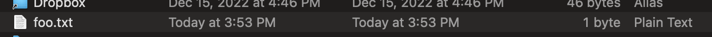

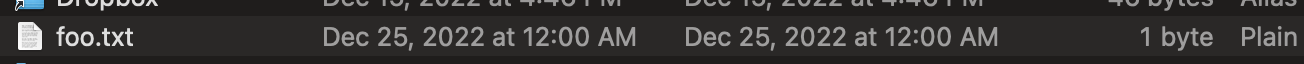

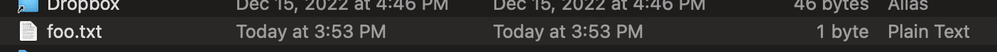

touch will modify create date.
Eg:
Code:
% echo "" > foo.txt
% touch -t 202212250000 foo.txt
Yields (Modified date, create date):
And with other switches, can change only modified, access

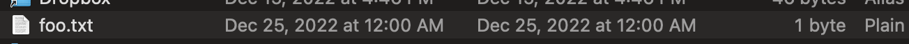

I think only when new modify date is earlier than current create date.
After following your example, try: touch -t 202212260000 foo.txt. Modify date is advanced to 26/12/22, but the create remains at 25/12/22.
The OP will be wanting to advance the create date, and likely without changing the modify. Hence setfile or ABetterFinderAttributes.

Is there something specific about the origin of these folders? Copied from the same external disk or network share?
No. They (& the other normal-dated folders & any new folders have correct dates are all on our external harddrive)
