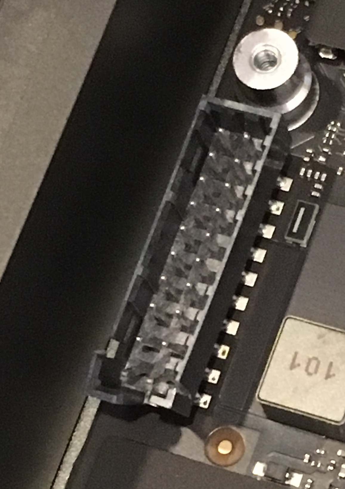

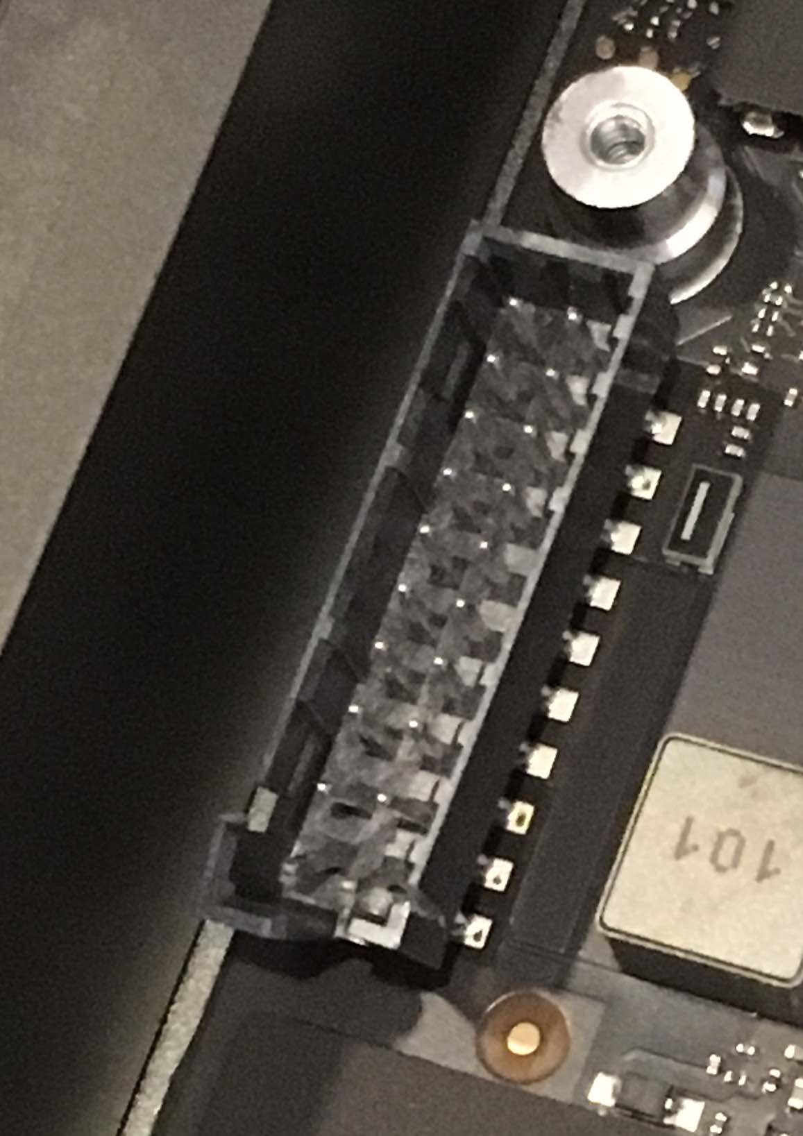

I just upgraded my ram and clumsily managed to damage my mini. I had troubled disconnecting the power cable and thought I'd slide the logic board out a quarter inch for more room. BIG MISTAKE!
It took a fair amount of force to pop out the logic board and when the logic board suddenly shifted the half connected power cable pulled free, broke the bracket, and bent four pins.
Fortunately for me I was able to bend the pins back into position for reassembly and everything still works, but lesson learned: fully disconnect all cables before attempting to move the logic board.

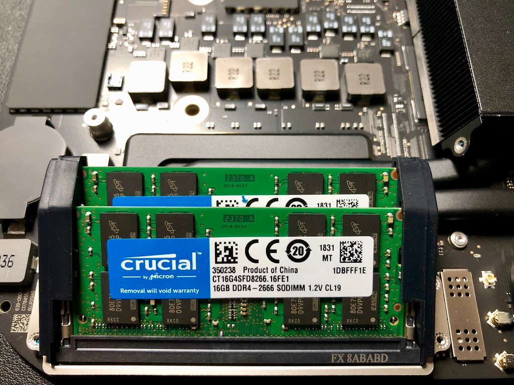

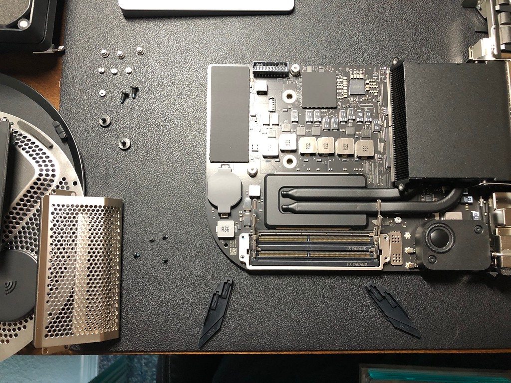

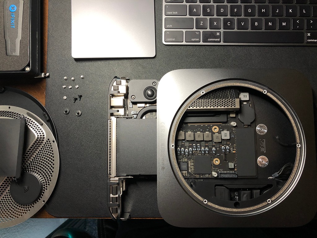

My BTO mini finally arrived and after unboxing it I went right in and took it apart to install the Corsair Vengeance 32GB kit (16GB x 2) that I bought for the mini.
Taking it apart wasn't too difficult. The part that took me the longest was putting those rubber covers back on the memory clips, heh. Pretty simple to do after watching a sample video on how to go about it.
Not sure why my pics didn't come out that great, maybe because of my ROG mousepad/mat?
All spread out (case/bottom plate was off to the side):
Up close with the new RAM installed:
After I booted up and went into macOS, the 32GB was properly showing at 2667Mhz. No problems so far. I went for the i7/8GB/512GB/10 gigabit ethernet mini (now at 32GB).
You can spread the clips to remove the memory without removing the rubber covers.
Not really. The covers are there to protect the clips and they actually slide into the clips in a very specific way. Even though they are a little fiddle to take off the whole process still only takes about 10-15mins
Agreed, the rubber covers are also spacers for the little Farraday cage that sits over the memory. The rubber covers slide on and off very easily, as long as you pull them off/on in the angled direction of the installed memory boards. If you try to pull them off/put them on sideways or straight up, that is when you have issues with them.
