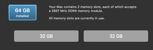

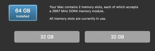

Mac Mini arrived yesterday i7 with 8GB RAM. Purchased 2 x 32GB Crucial RAM for £165 each (no dual pack available) and fitted it. It would have cost £1000 on purchase, so saved about £700!
Only tips I have is to purchase the iFixit tool kit and take your time. The only real parts for concern for me were the antenna cable and the LED cable. Oh and make sure you have both RAM sticks in properly. Did it in 25 mins first time and only one stick shown. Took 15 minutes the next time and now have 64GB RAM.
Oh and it FLIES!!!!!
Good luck to all that try - it is worth it 🙂

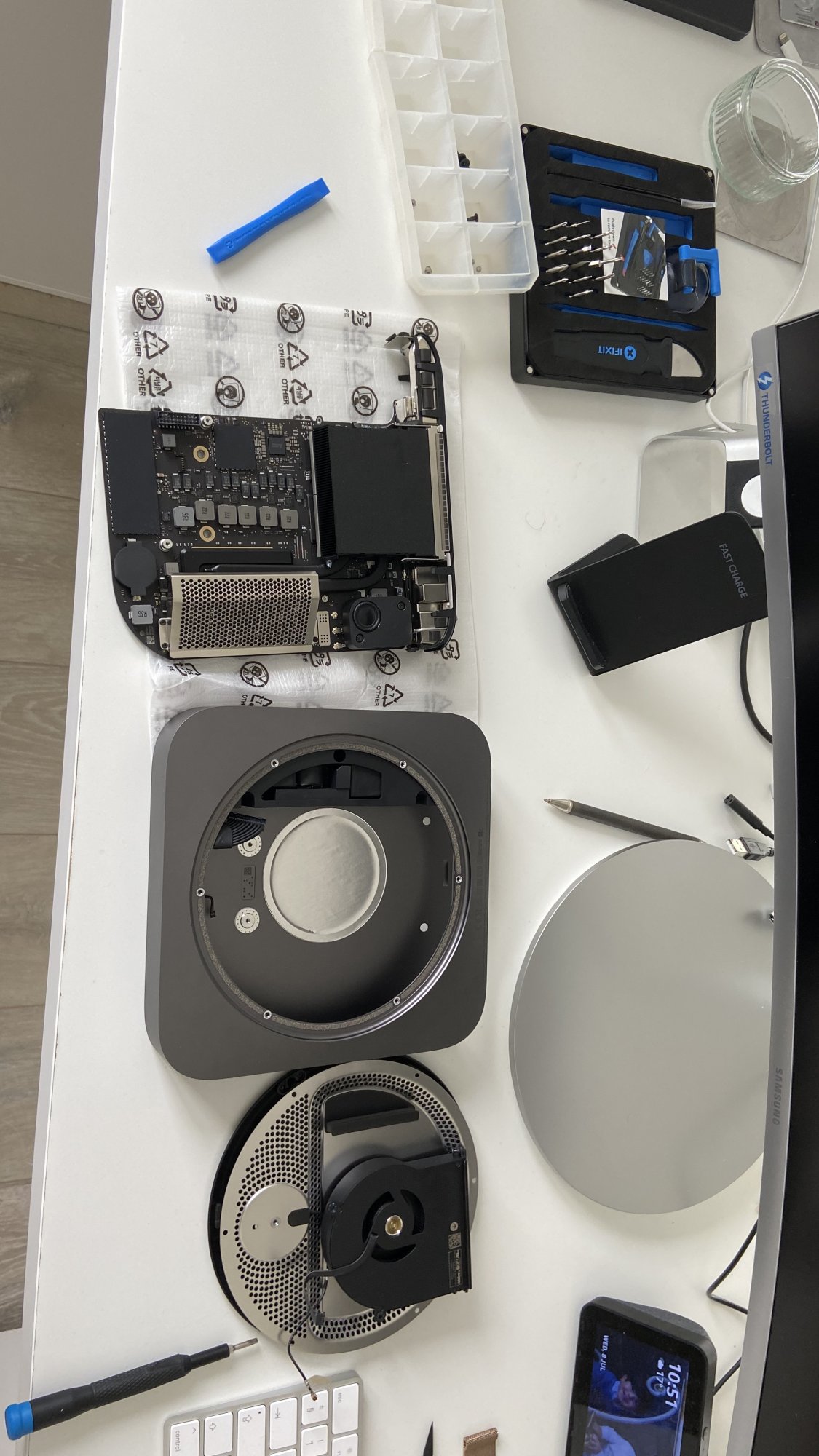

Anyway, the refurbished mini (2018 i7/512GB/16GB-->64GB) is working out fantastic.

It's easy. Just strip some screws, break a few wires and pull that logic board out the back. Boom. All from the comfort of your couch.
  • Haha
Reactions: Boyd01
To me the only slightly challenging part was getting the wifi cable connected again. It's got that tiny little circular connector and getting the tip of it in the slot is hard, especially with the really short antenna wire.
