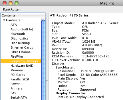

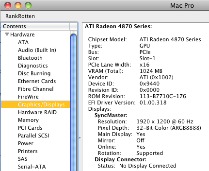

My card is a Sapphire 4870 1GB, don't see why the other brands won't work fine with OS X in an x58 board as long as the device id is the same. Perhaps Cindori could confirm?
Sapphire Radeon 4870 Device ID: 0x9440 using ATI drivers built into Mac OS X:
