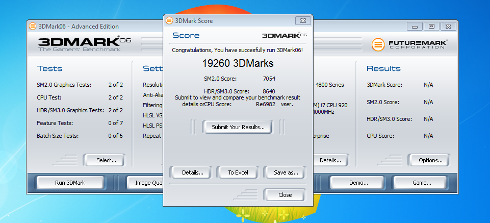

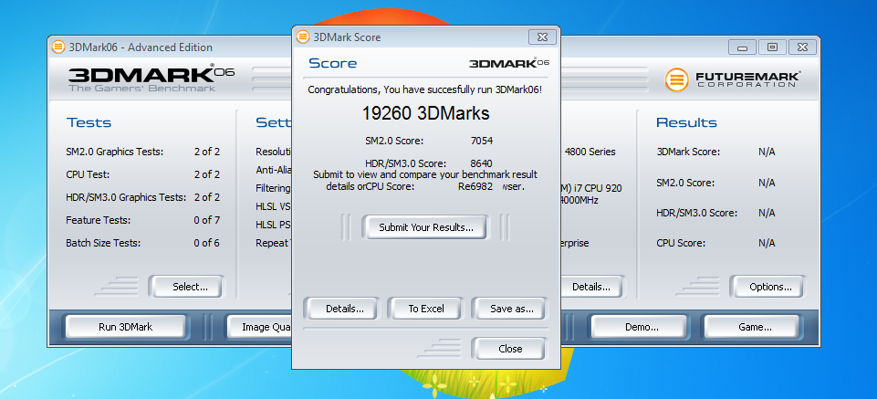

Nope... 3dmark06. But... a little bit different video card setup than my original 9800 gt oc...
That score was with 2 4870's in crossfire. 😀
Unfortunately the fan on the 2nd card runs WIDE OPEN the entire time I'm in OS X... and I'm there more than win 7... so have pulled one card and am going to sell that off as well as my Sparkle 9800 GT OC.
I still get a somewhat respectable 18409 with a single card.
LOL
That makes more sense 😉 I get around 18,900 with a singe HD4870
I had 2x running in crossfire but like you said the second one just sits there and makes noise in OSX (a lot of noise) and I could never get the second one to work at all in SL.

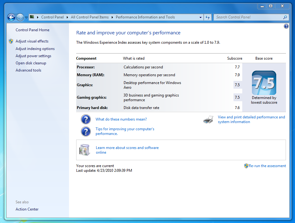

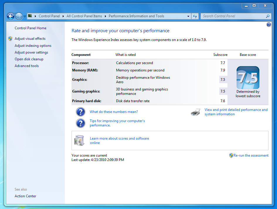

She is, however SMOKING fast!!
Specs:
Gigabyte GA-X58A-UD3R
i7 920 @ 4.00 Ghz
12gb DDR3-1600 Corsair @ 1600 Mhz
Diamond Ati 4870 1gb (slightly OC'd, not the best OC'ers)
Corsair Hydro series H50 - push-pull config exhausting out the back
CoolerMaster CM690 II
OCZ 600 watt ModXStream-Pro
100GB OWC Mercury Extreme Enterprise SATA SSD
