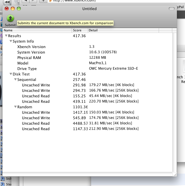

I agree 100%... and I have abused this drive as far as installs... (multiple, running a hackintosh after all) with win 7 install as well, you name it.
I''ll just run X-Bench to get some numbers. It's not the perfect benchmark app but it should give some idea of performance.
I have run into an issue with updating the firmware... actually a complete no-go on my machine... will not detect the drive. Who knows... but will post some XB results shortly...
X-Bench Results - OWC SSD
Here are the results of the hard disk test only in X-Bench on the OWC ME SSD... not bad... 😀
Excellent! I use X-Bench for stuff too, so this gives me a direct comparison with my current boot drive.

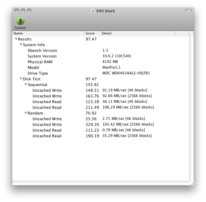

Just for fun, here's my 640GB WD Black. (It's an older test from when I replaced the stock 500GB HDD since it was quite slow; only got a 47.57 in x-bench)
Quite the performance difference! 😱
