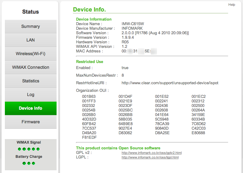

Did the 'whitelist' expand beyond the 18 prefixes on the original firmware?
ispot/super (super for admin/password), click on 'device info' and check the whitelisted MAC prefixes listed under 'restricted use'

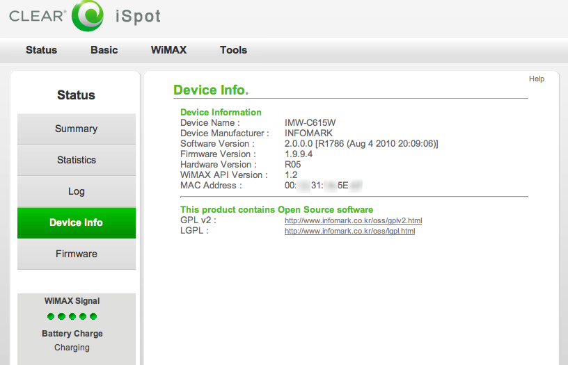

My iSpot gave me the connectivity (unrestricted, so far,) I reported without any modification by me. That is to say, I did not spoof any MAC numbers, nor did I set any whitelist.
I don't remember the 18 prefixes from the original firmware, and can not find them on the new version. (I did sign on as admin.)

Did you to what 'ncbill' suggested in post above?
In Safari, you type in:
ispot/super
-or-
192.168.1.1/super
and then use password 'super'
This is not the normal 'admin' prompt.
In the log (which can save or copy from), you will see lines that end in:
/RestrictedUse/Organization/0/OUI=0026B0
Those lines are what ncbill wanted to see. I suspect he wants to see if any lines were added/deleted by the firmware update.
Restricted use: 37 prefixes
Thanks, jasg49. Now I understand.
I now can count 37 prefixes.
log said:
<29>Aug 8 18:59:50 sdkd: [OMA] ./WiMAXSupp/Operator/clear/Apps/RestrictedUse/Organization/0/OUI=001B63
<29>Aug 8 18:59:50 sdkd: [OMA] ./WiMAXSupp/Operator/clear/Apps/RestrictedUse/Organization/1/OUI=001D4F
<29>Aug 8 18:59:50 sdkd: [OMA] ./WiMAXSupp/Operator/clear/Apps/RestrictedUse/Organization/2/OUI=001E52
ispot/super
-or-
192.168.1.1/super
