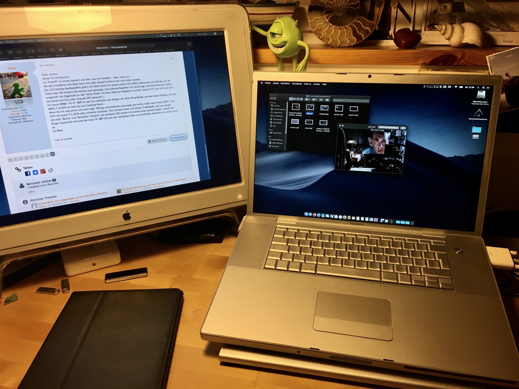

Just seen this thread and realised I should have posted my MBP 17" 2.0 GHz Core Duo DVT on here! Here's the thread with picture: https://forums.macrumors.com/threads/the-original-macbook-pro-17.2201100/
img_6363-jpg.862873
I bought it as parts from a recycler, and reassembled it. It's all working and original apart from the display panel and drives, which I sourced from a broken 17" MBP 2.16 GHz Core Duo, and the firewire chip failure which affects these.
A1150 (incorrect!), Core Duo 2 GHz, 120 GB HDD, 2 GB RAM. 820-2023-01 logic board and 820-1970-04 daughter board

That's a cool one 🙂 When was it built according to the serial number?
I wonder if there are pre-production 1.66 GHz 15in MBPs out there...

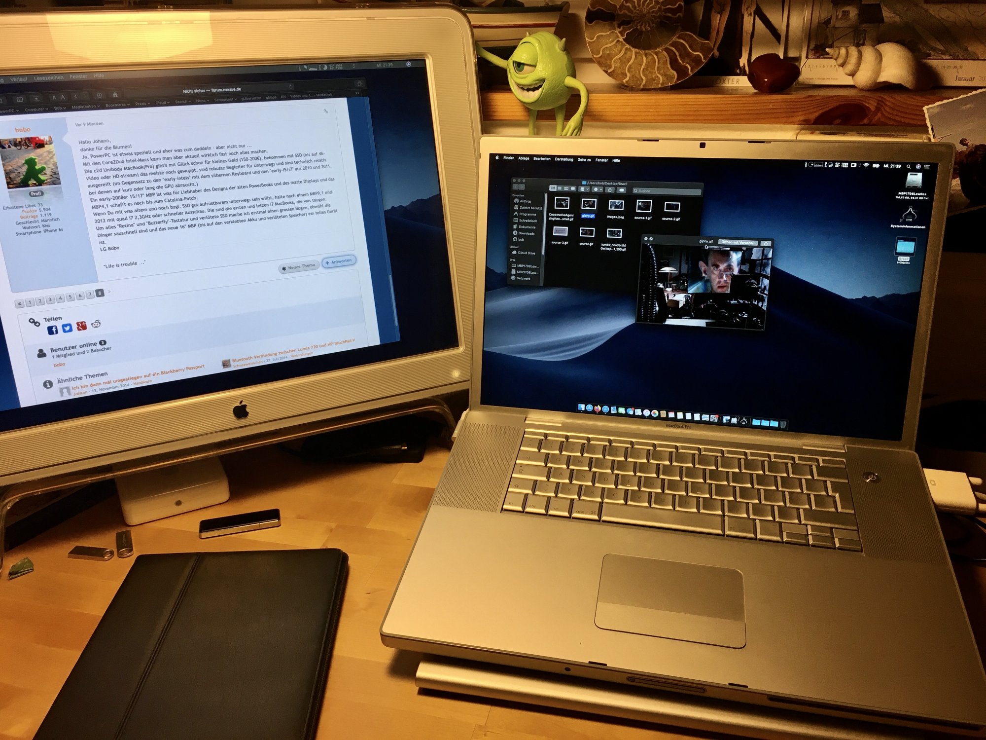

img_6363-jpg.862873
Very nice. I had no idea Apple had a 2Ghz pre-production model. Have to wonder where the recyler got it from. 😉
Week 11 (March) 2006. I bet there are some - I've seen another of these on eBay before, too.
This is a really fascinating find. I was aware of there being dev tests of 15 and 17in Core Duos, though the only models whose clock speeds I was definitively aware of were the 1.67 and 1.83 15in models cited on Everymac. As you know, the ”A1150” you have isn’t noted on there.
What’s doubly fascinating about your DVT MBP, personally speaking, is that my 17in PB G4 was built on week 12 of 2006 — meaning not only was it among the very last of the PBs made and produced a week later than your MBP, but also your DVT MBP was an example which reveals how they were still tweaking model internals before its April début.
Have you ever run Geekbench 2.2.7 to gauge its overall performance?
