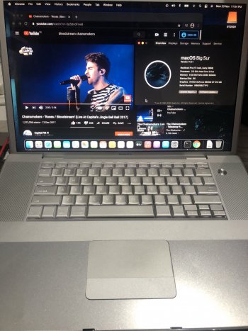

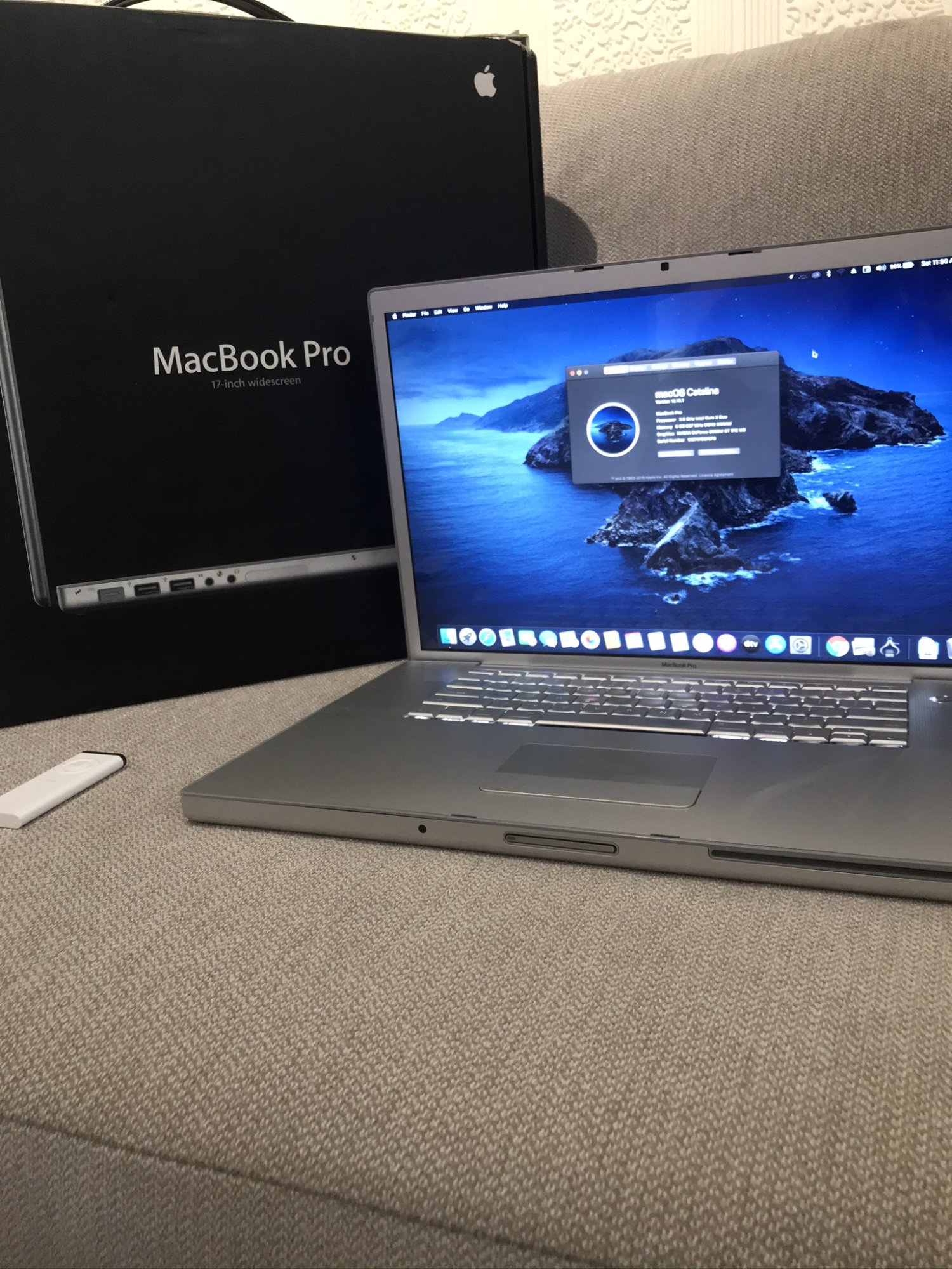

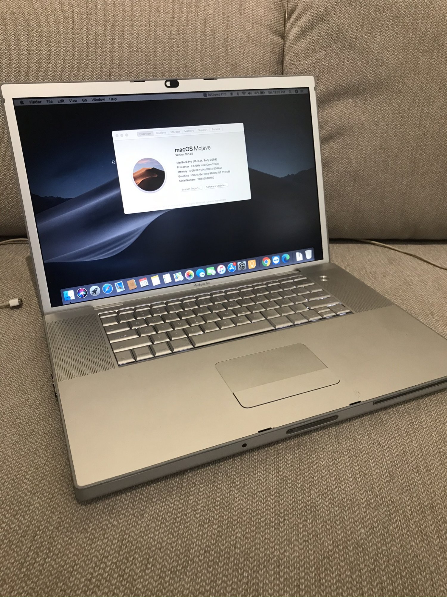

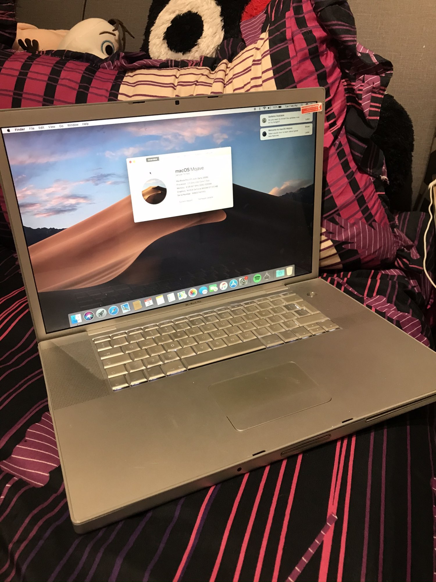

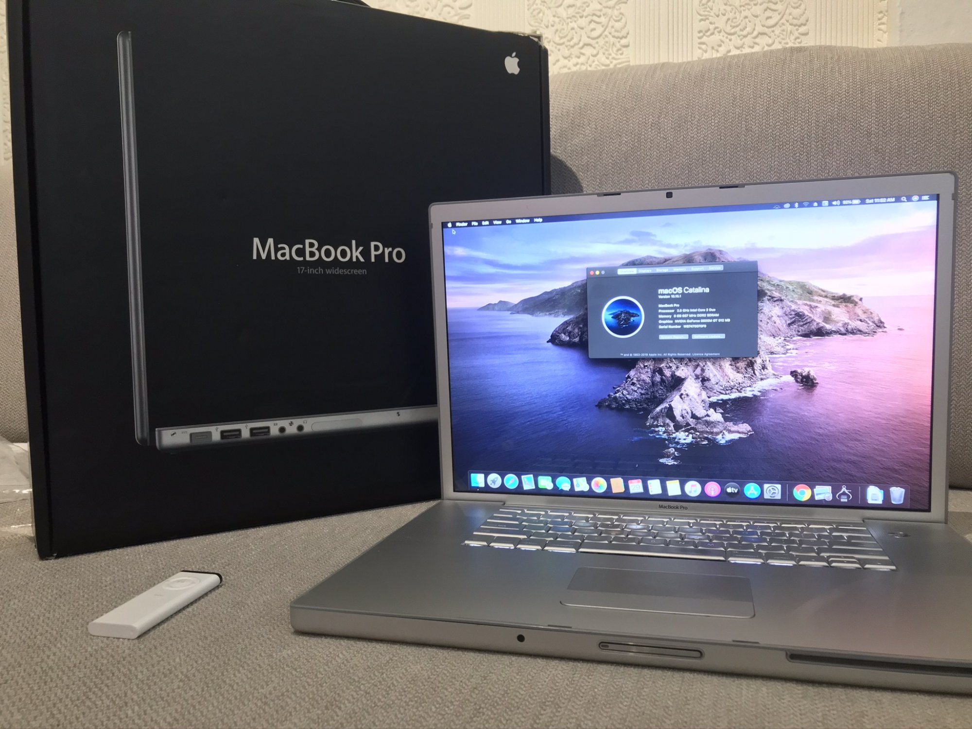

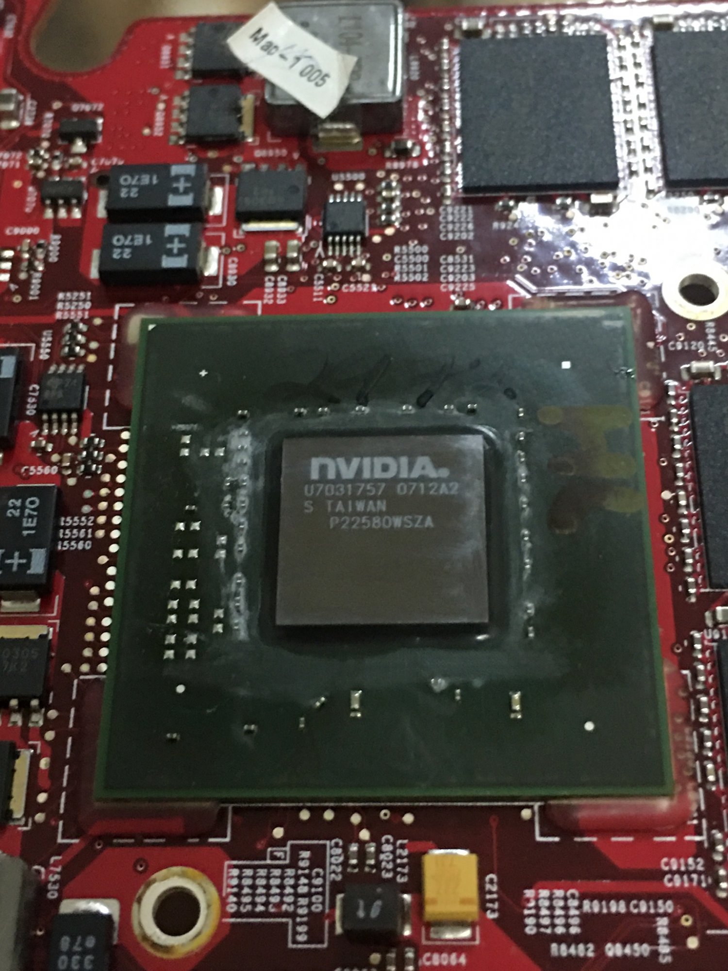

New to this thread! Thought I post my various MacBook Pro 17”. @bobnugget recommended me here.
Used to own a few 17” PowerBooks but gave it away sadly.
I own a MacBook Pro 15” 2008. 2 MacBook Pro 17” 2008 2.5GHZ both with revised chips and a MacBook Pro 17” 2007/2008 hybrid prototype. All in almost pristine condition. Huge fan of 17”!!

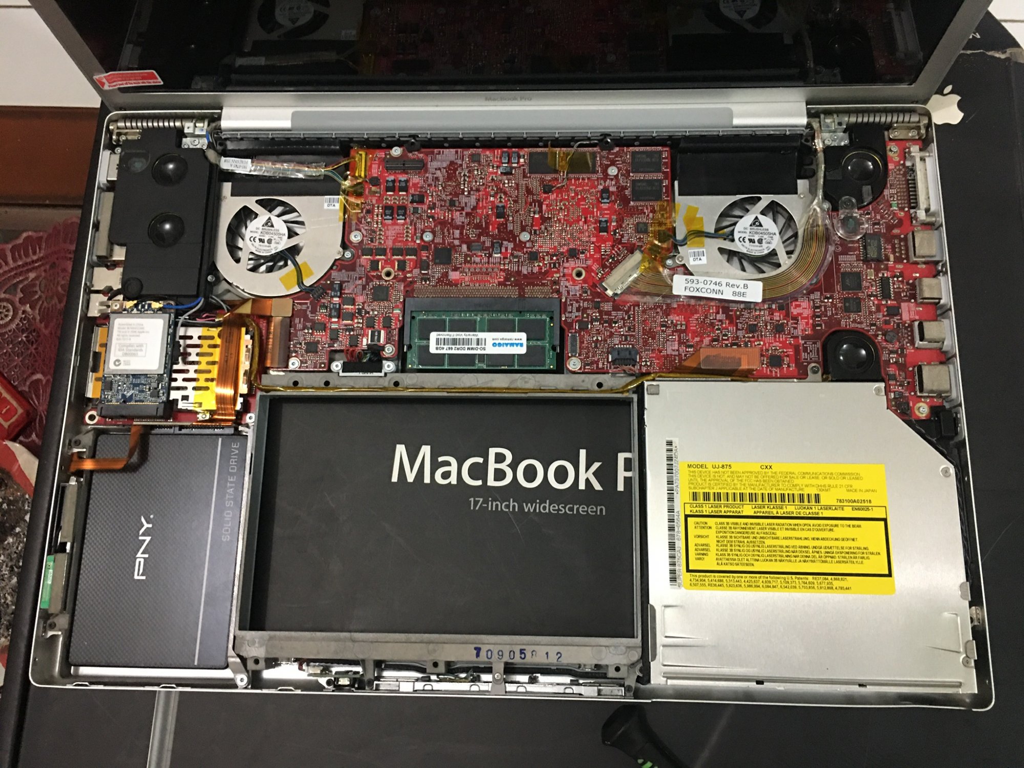

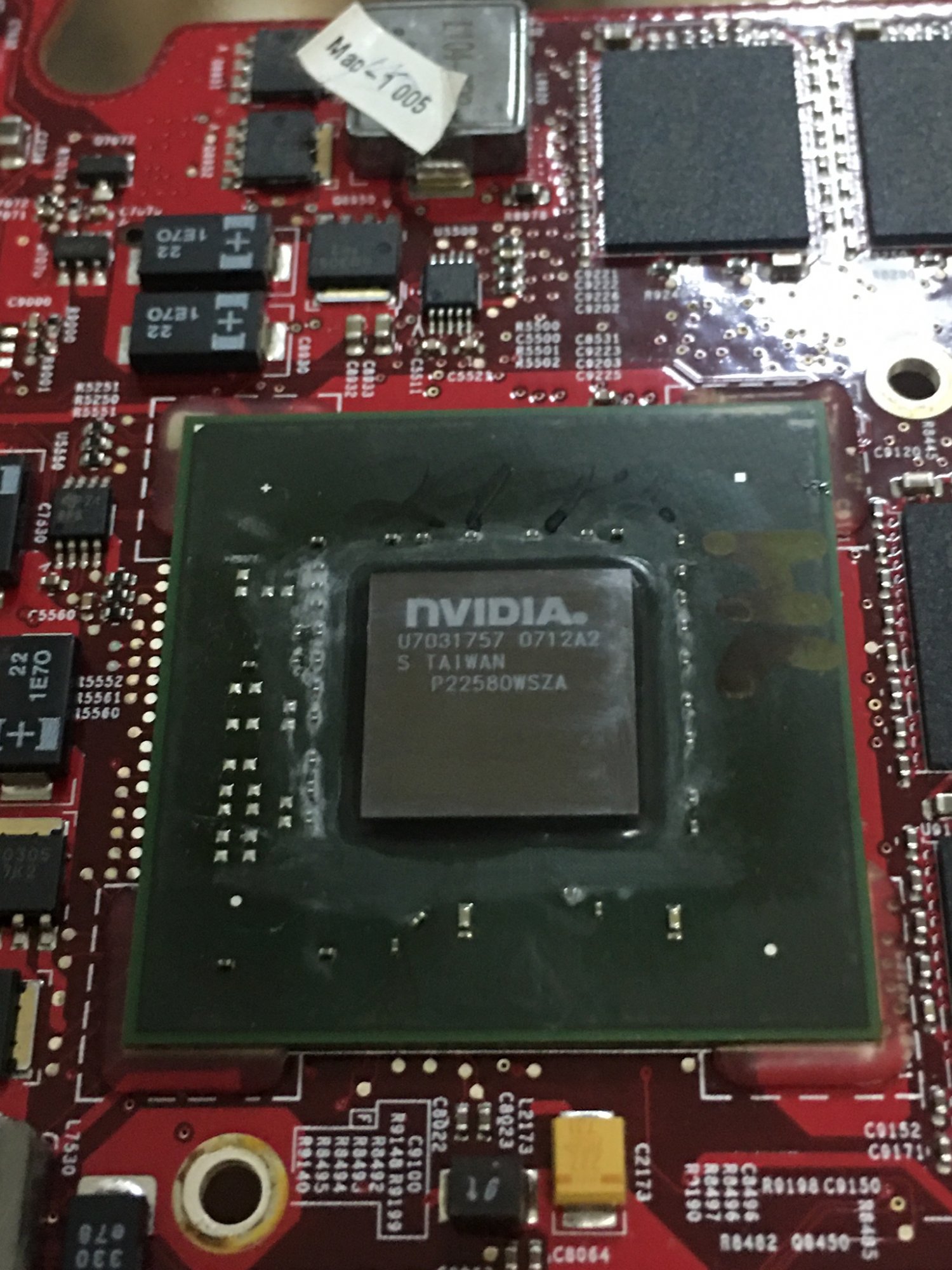

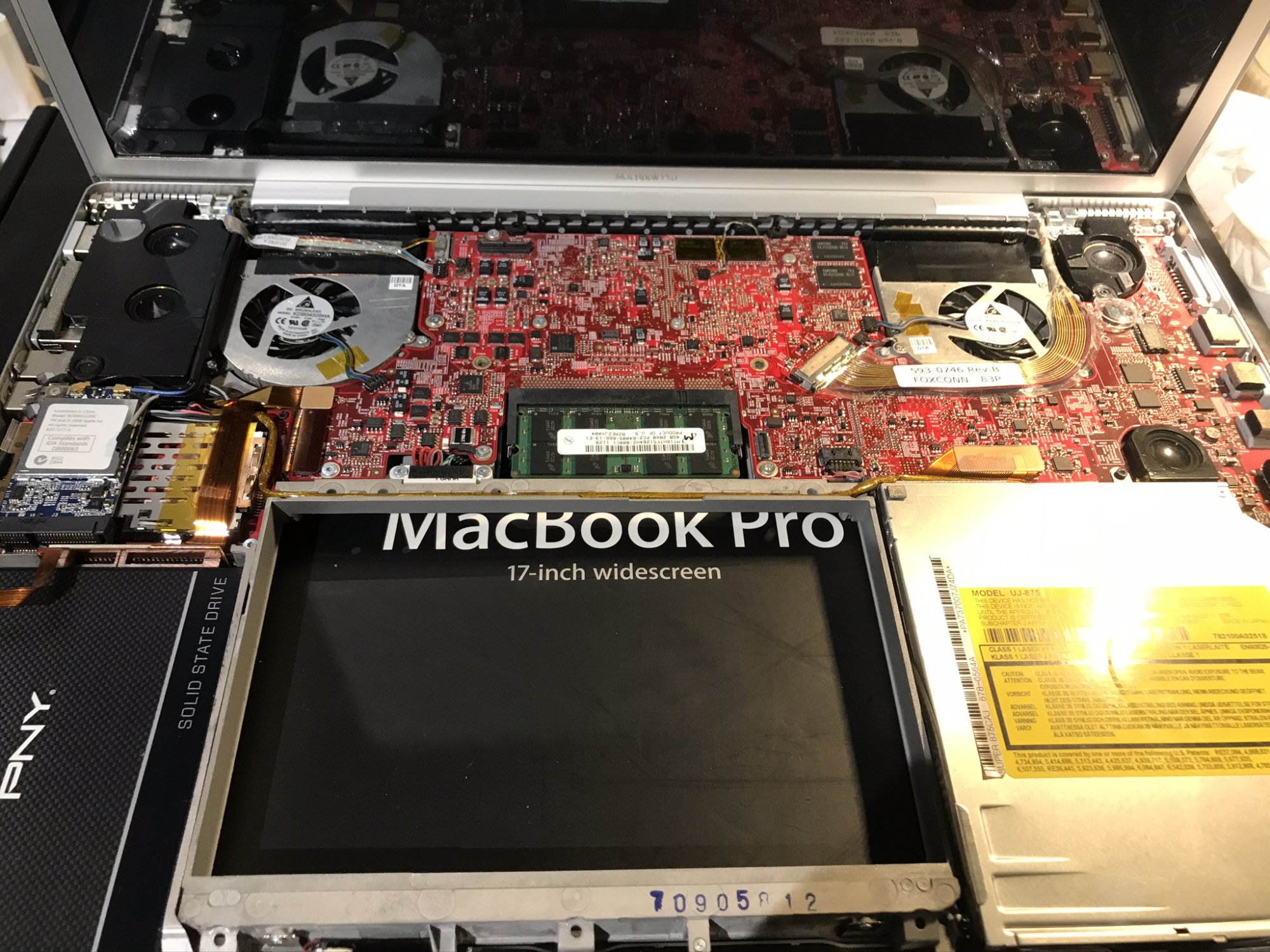

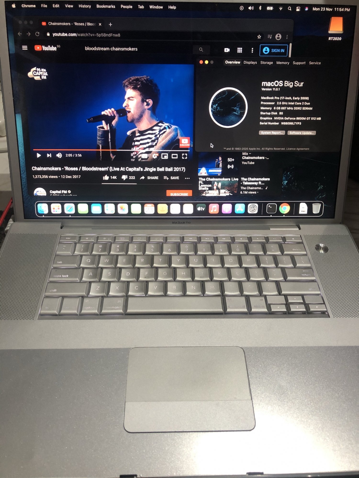

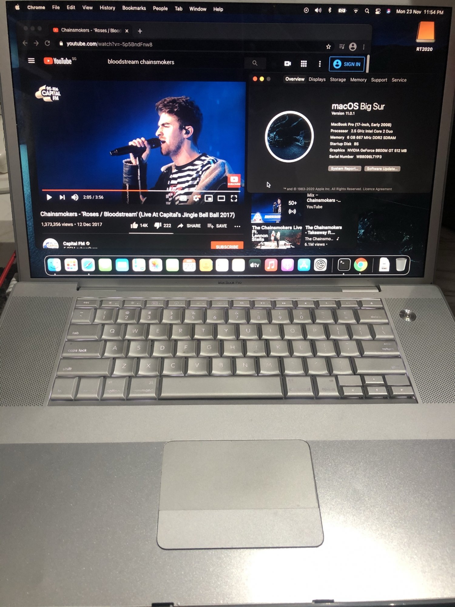

Hey yeah totally forgot to share.
Big Sur runs surprisingly fine but no graphics acceleration so the minor lag that’s kinda annoying. Still working on getting it right if that’s possible. Hahah

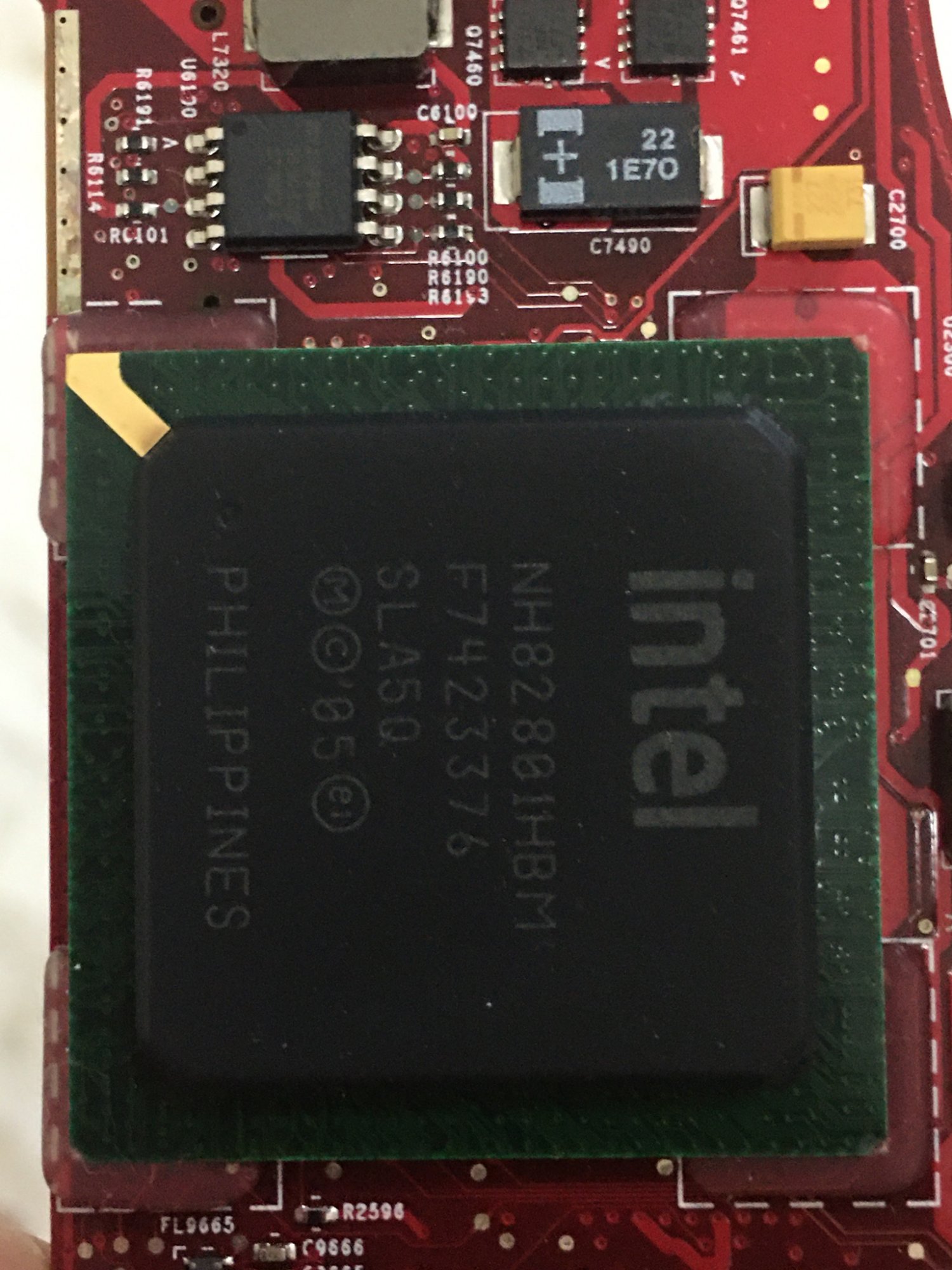

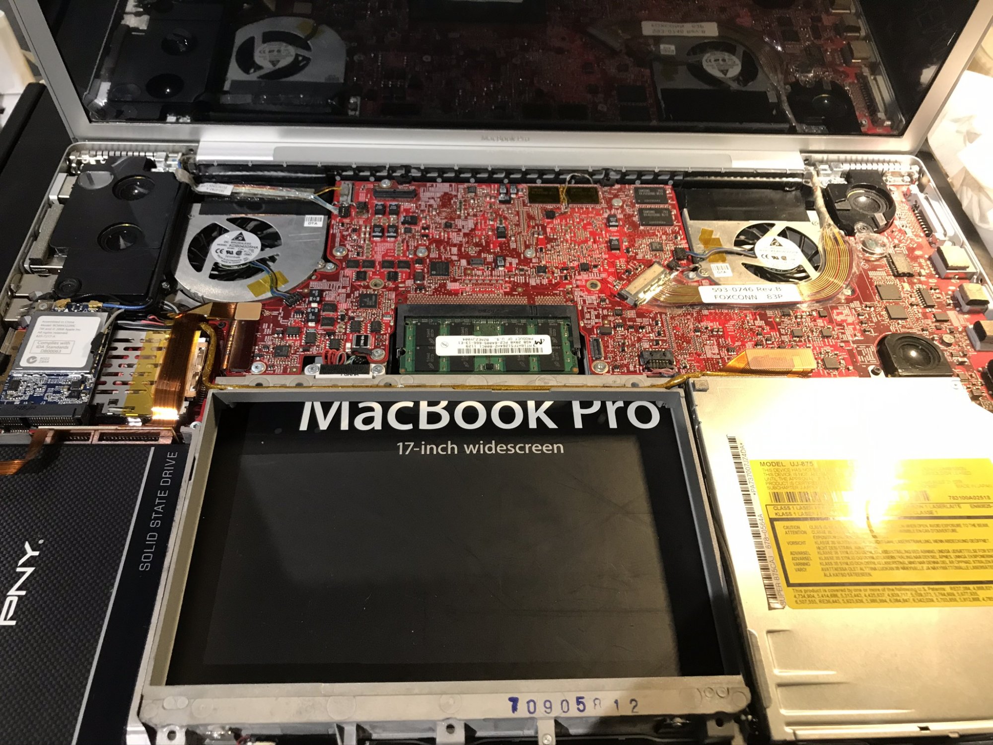

The prototype has 2 different serials which are unknown and not found on apple serial database.
Most parts are original except for the hdd, ram and battery.
Code name: #Lucky4
EVT: Engineering Validation Test Unit
DVT: Design Validation Test Unit
Unique Debug connector

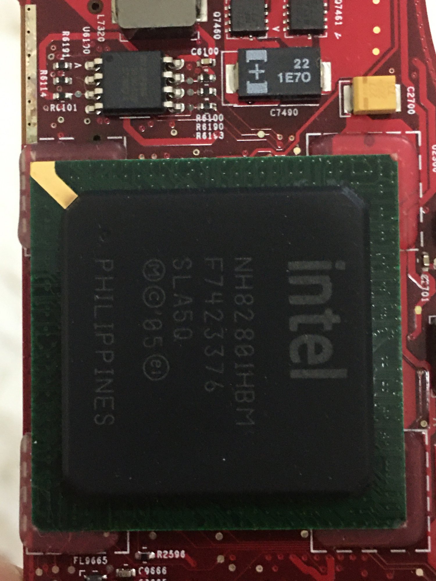

Intel processor chip is ES (Engineering Sample)
Wifi card is marked as M35D LUCKY4 EVT sample
Bluetooth prototype board is green
Sleep indicator prototype board is green
Apple Superdrive DVD prototype is marked as SUPER CXX UJ-875
Logic board is 820-2262-#04
17” Glossy widescreen TFT LED backlit display”. Speakers are surprisingly louder than any normal macbooks.
Has 2 different unique serial numbers.
interestingly it has 2 different serial numbers and is not recognized by Apple warranty checker. Logic board has its own serial number and the bottom base cover has a different serial number.
Body EMC is marked EMC:XXXX and also marked as an A1229 model but has the same specifications as the A1261 red logic board.
Oh yeah, so no chance of Metal support for these, Big Sur requires that for acceleration to work.
Maybe try the eGPU route, although it wouldn't be a nice thing with a laptop (for mobility).

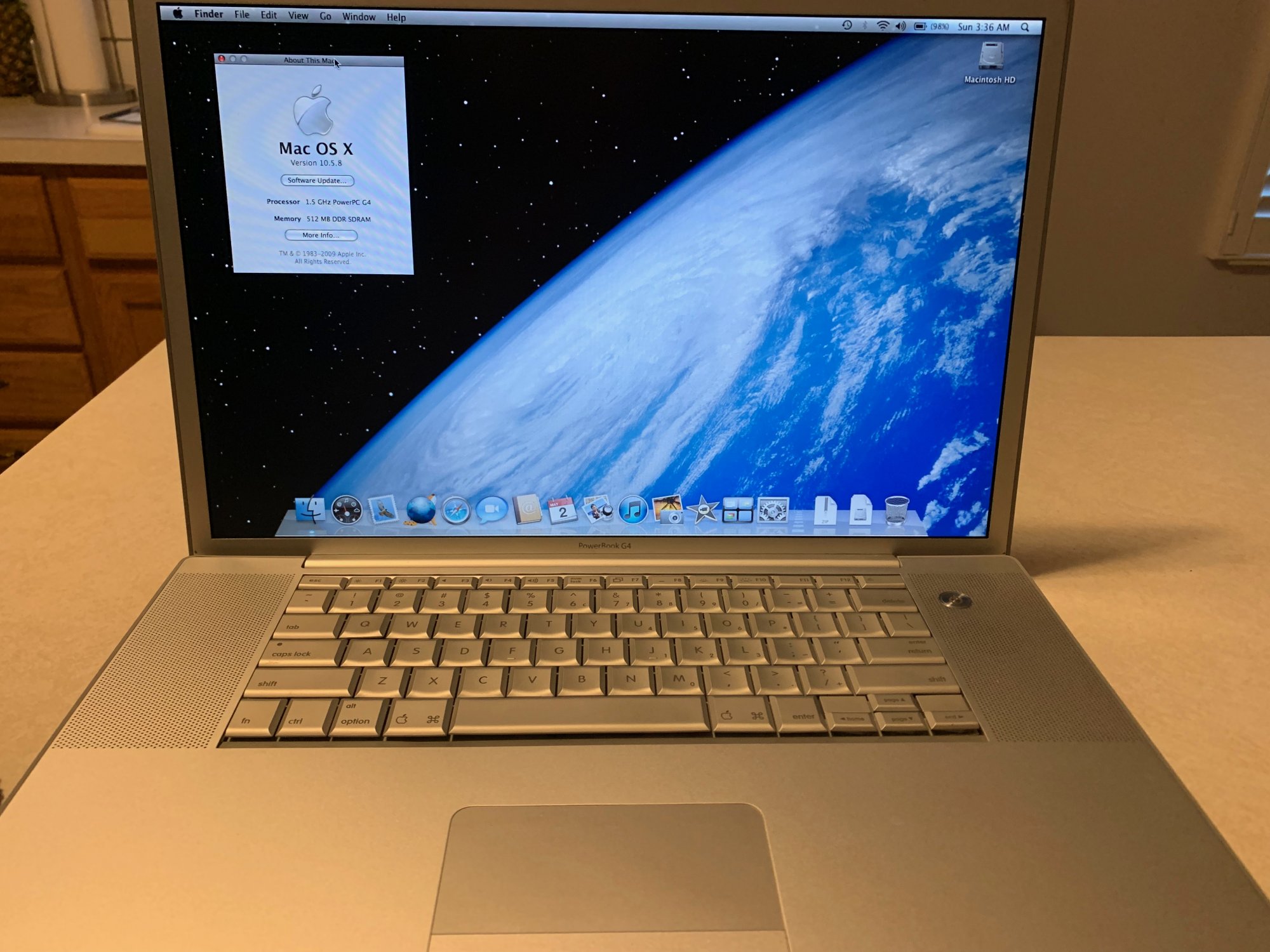

The PowerBook G4 17" (1.5 GHz, 2004) arrived yesterday and is working well so far. This post is made using my new PB G4.
I have 2 17" Mac laptops, so I will post pictures and a little info about both.
PowerBook G4 17" (2004)
  • It has 512 MB of memory. My first upgrade will be to get 2 GB of memory (probably from Other World Computing, I have had good experiences buying from them).
  • 150 GB HDD. I may replace this some variation of an SSD. Maybe a PATA SSD, or more likely an M.2 SSD in combination with an IDE to M.2 adapter.
  • The battery is almost brand new, it only has 17 cycles and it looks like I can get about 3 hours after recharging it. This was an unexpected bonus.
  • Keyboard and trackpad do not have any issues and the screen looks very good.
  • I have only tested the left hand USB port. I will try out the others ports for which I have something I can plug in. I don't have any Firewire devices and I don't think I have any PC Cards any more.
  • Overall the outside looks very clean.
I am using TenFourFox as my web browser with the TenFourFourPEP prefs.js file. The performance is quite good. It isn't as fast as a newer Mac, but at least with MacRumors and eBay I am seeing good performance. I will try other web sites as I use it more.

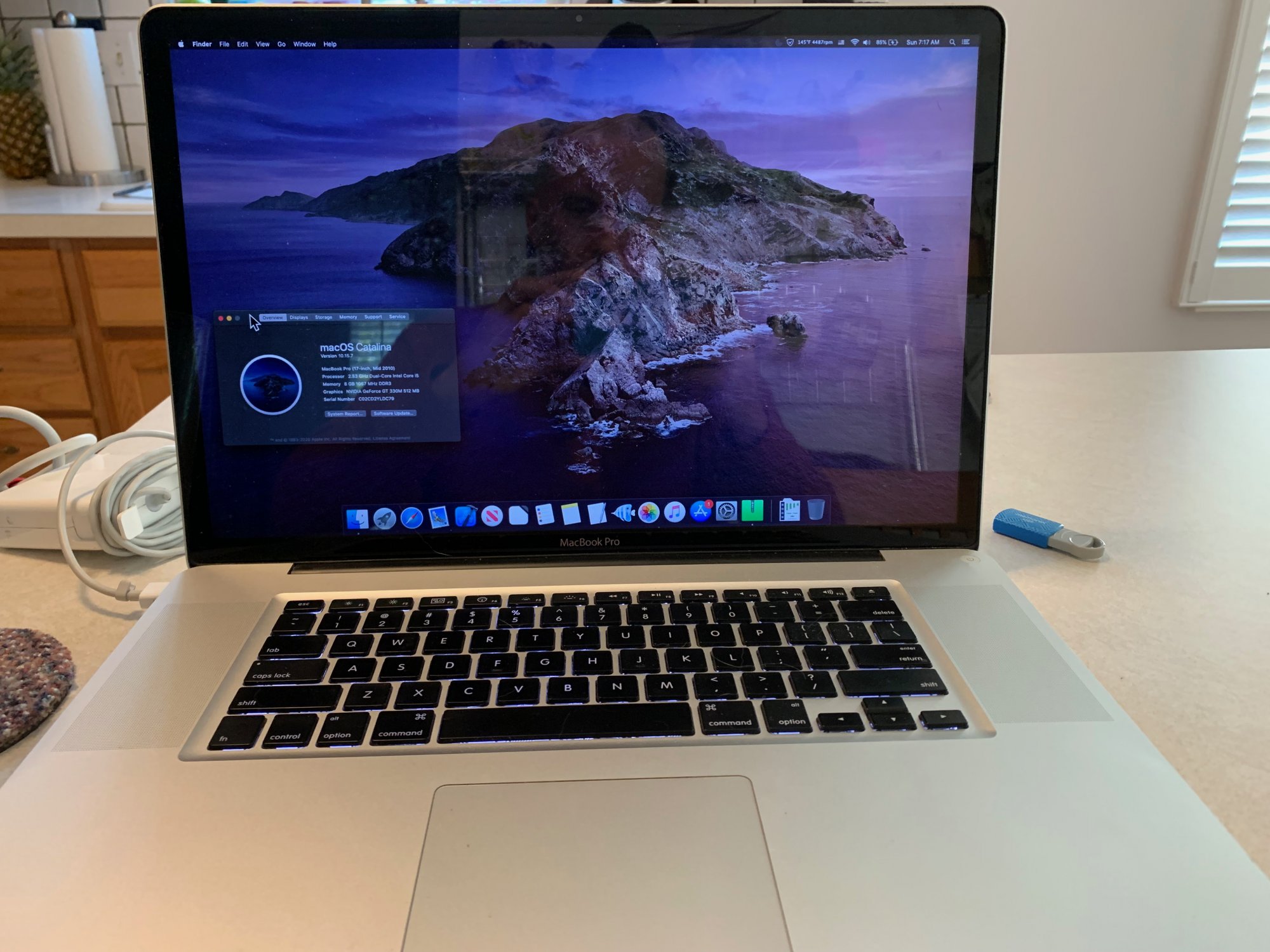

MacBook Pro Intel i5 17" (2010)
  • I bought it off of eBay last September, to tide me over until I found an Apple Silicon (M1) MacBook that I wanted. I did by a MBP (8 GB, 256 GB), so it has done the job I purchased it for. At this point in time, any additional use I can get out of it is a bonus. Well, that and it is a 17" Mac laptop. 🙂
  • It came with 8 GB of memory (maximum), so it was nice not to have to upgrade that.
  • It came with a 500 GB HDD, I replaced it with a 500 GB SSD. It is working well, and for all 3 Macs I have replaced an HDD with an SDD I have seen noticeable performance improvements.
  • I have installed a patched version (from DosDude's sight) of Catalina and that is working well so far. That gives me an up to date version of Citrix Workspace (so I can connect to my work VDI) and I can still connect to an external monitor (34" AOC Ultrawide).
  • The battery was almost dead (the eBy seller was up front about this) and I ordered a new replacement battery, from eBay, that arrived yseterday. I instealled it this morning and it is indeed new (cycle count of 1).
  • I am using smcFanControl, but the addition of the battery (I took the dead battery out about a month ago) seems to be making it run hotter. I need to play around some more and see if there are other things I can do beyond using smcFanControl.
  • The screen, keyboard, and trackpad all work well.
  • The ports that I have tried so far all work as expected.
