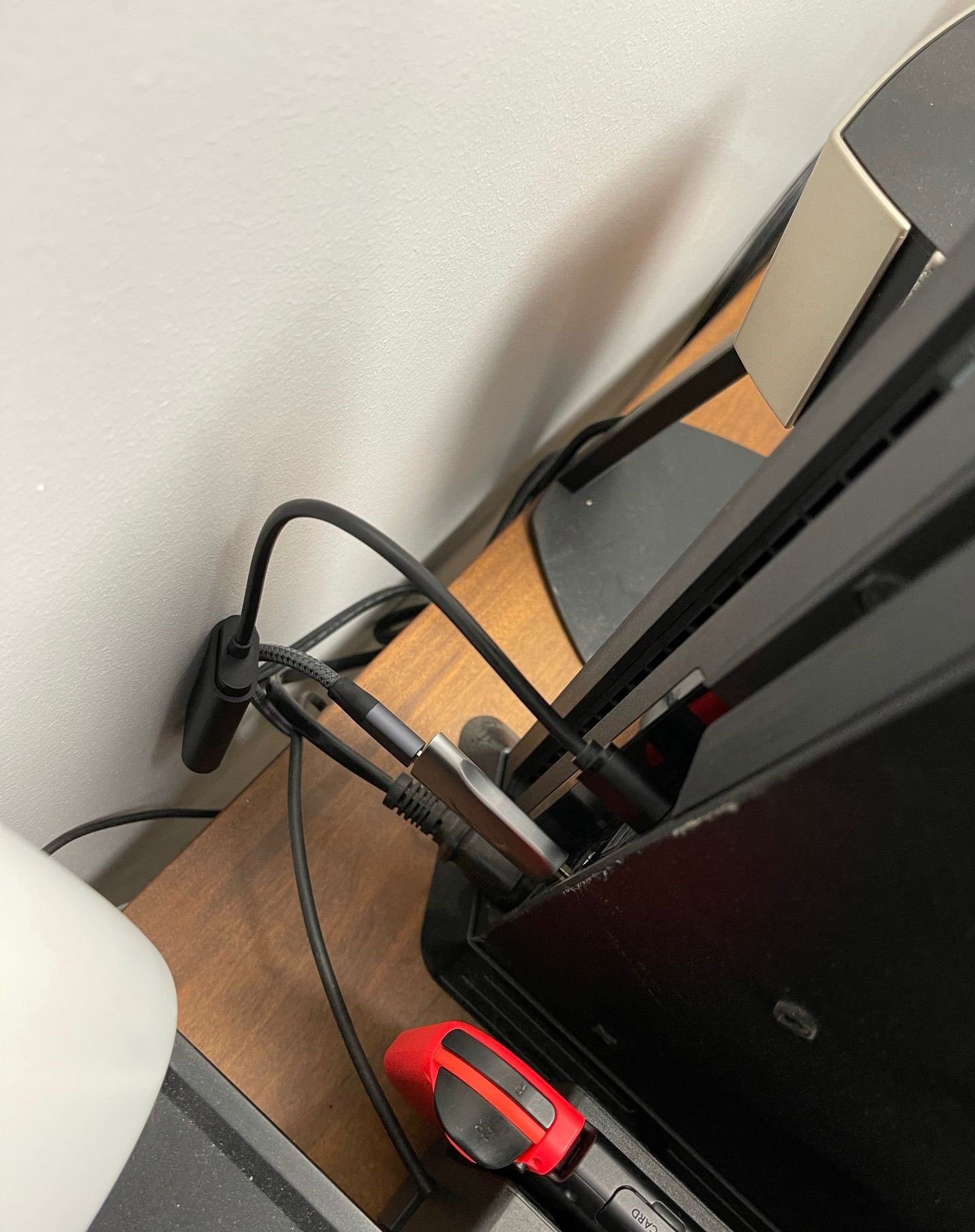

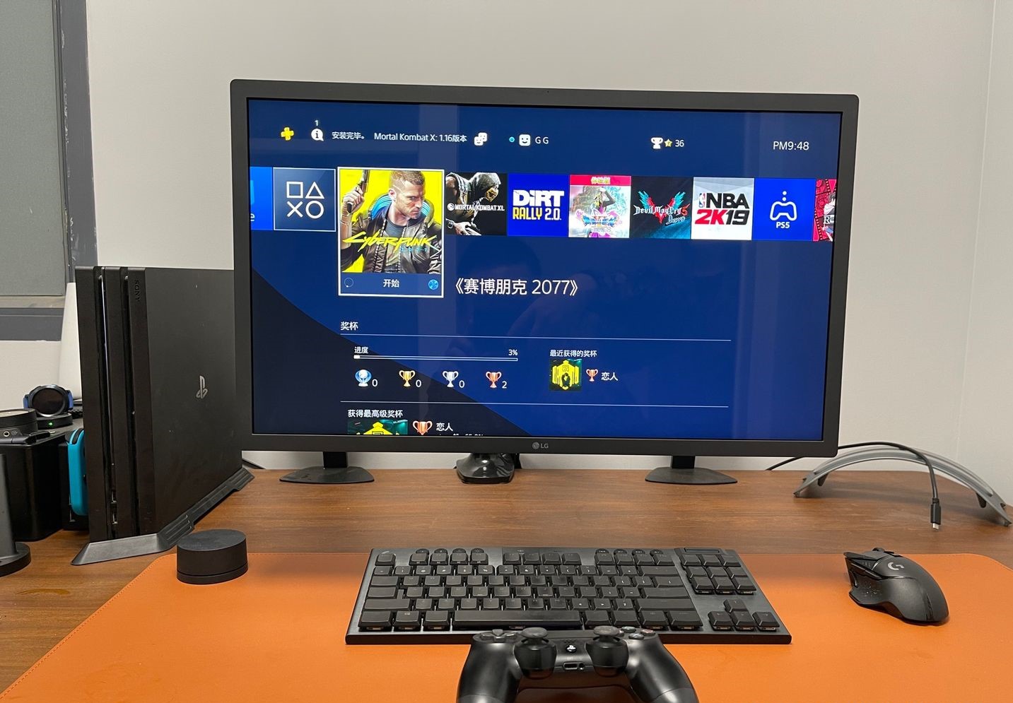

I found a HDMI output to USB-C input cable. The only option in the world. It work perfect.You can also add a DP adapter to directly become HDMI to DP.
I bought this cable and received this morning. Here I'm reporting that I tried with my Razer Blade Pro and XDR, and YES it works perfectly. With the connection of the USB cable, I can even adjust the brightness from the bootcamp panel. The resolution is only 4K, but based on this set up, I think those 1080p source, such as Switch and Xbox one, couldn't be happier.
I am glad I helped.I really found this cable in a super hard way for a long long time.
