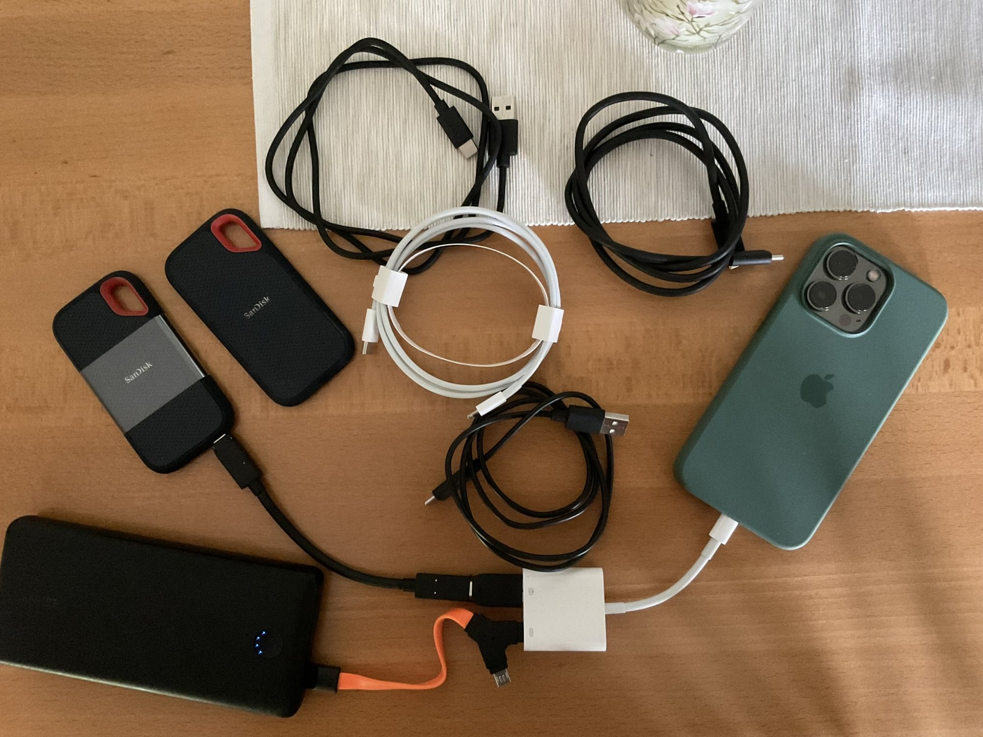

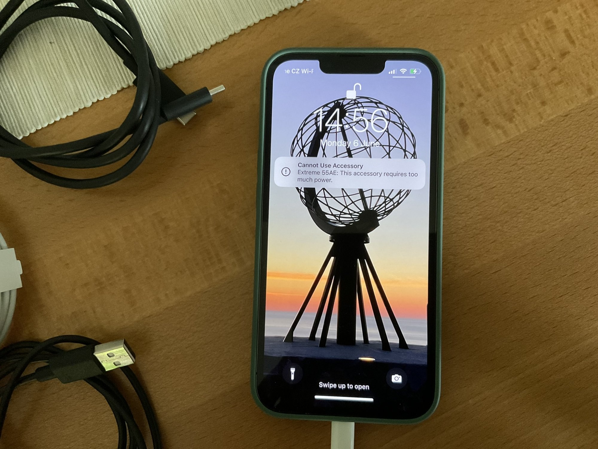

Here we are in 2022, latest iPhone Pro. I am preparing for my holiday in Australia, this time trying to shoot exclusively with my phone. With a gimbal, in Filmic Pro, where every 10 seconds counts for ~100MB.

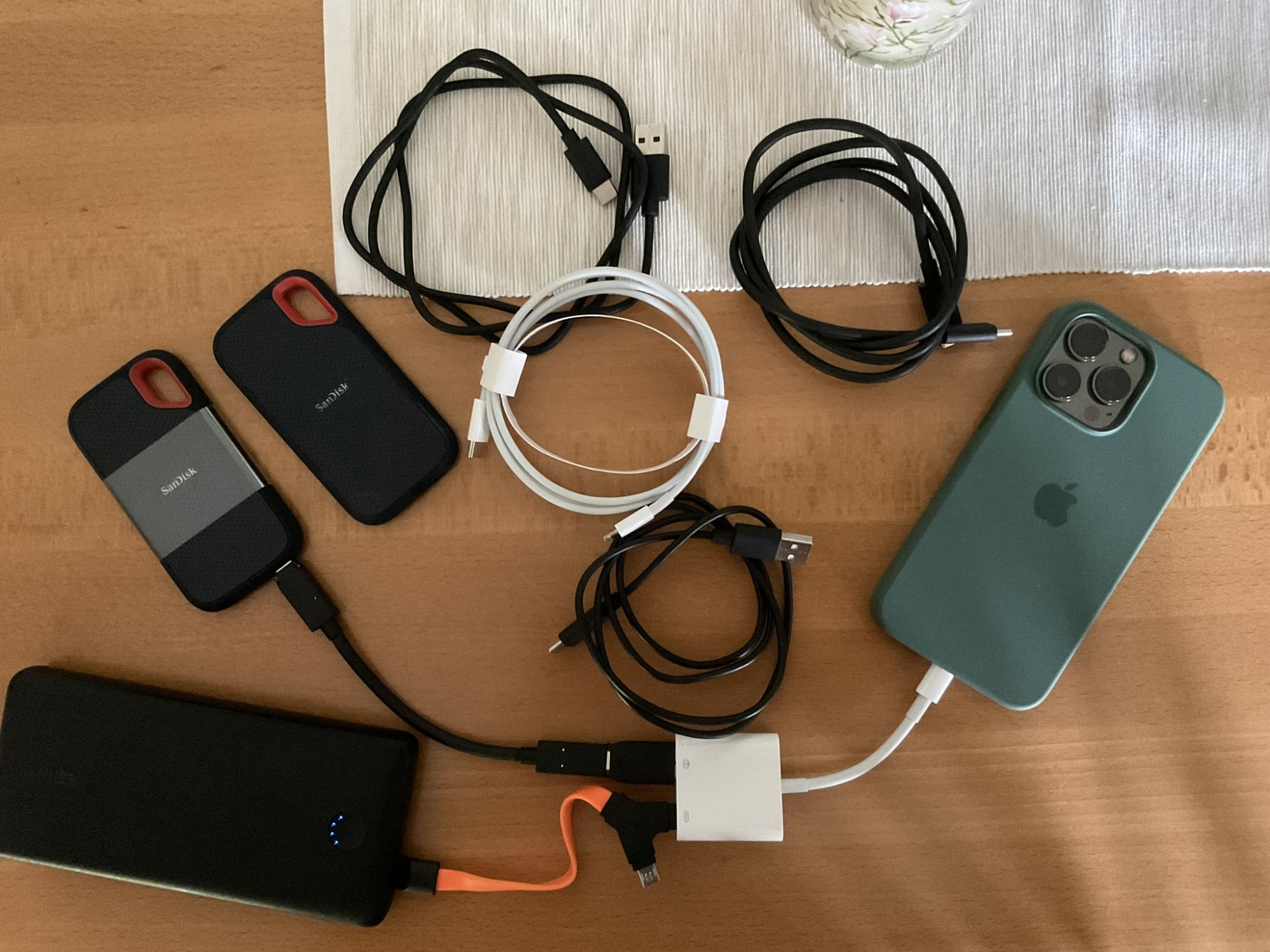

So, I wanted to shoot in Filmic, then export the videos straight to an external SSD. It worked, couple of times. Sometimes it ended with an error, but the videos were copied successfully. Now it doesn't connect to either of my SSDs, one formatted to APFS, other to exFAT. Just a couple days before my holidays start.
Any ideas? it worked with the exact setup as shown in photo. I then tried several other cables for the SSD and charging, even powering the Apple Lighting to USB 3 Camera adapter with 20W charger straight from line. No success.
This is the message I'm stuck with. It flashes every 5 seconds when it's all connected. I rebooted couple of times. Paused optimized charging. Nothing.
"This acessory requires too much power".

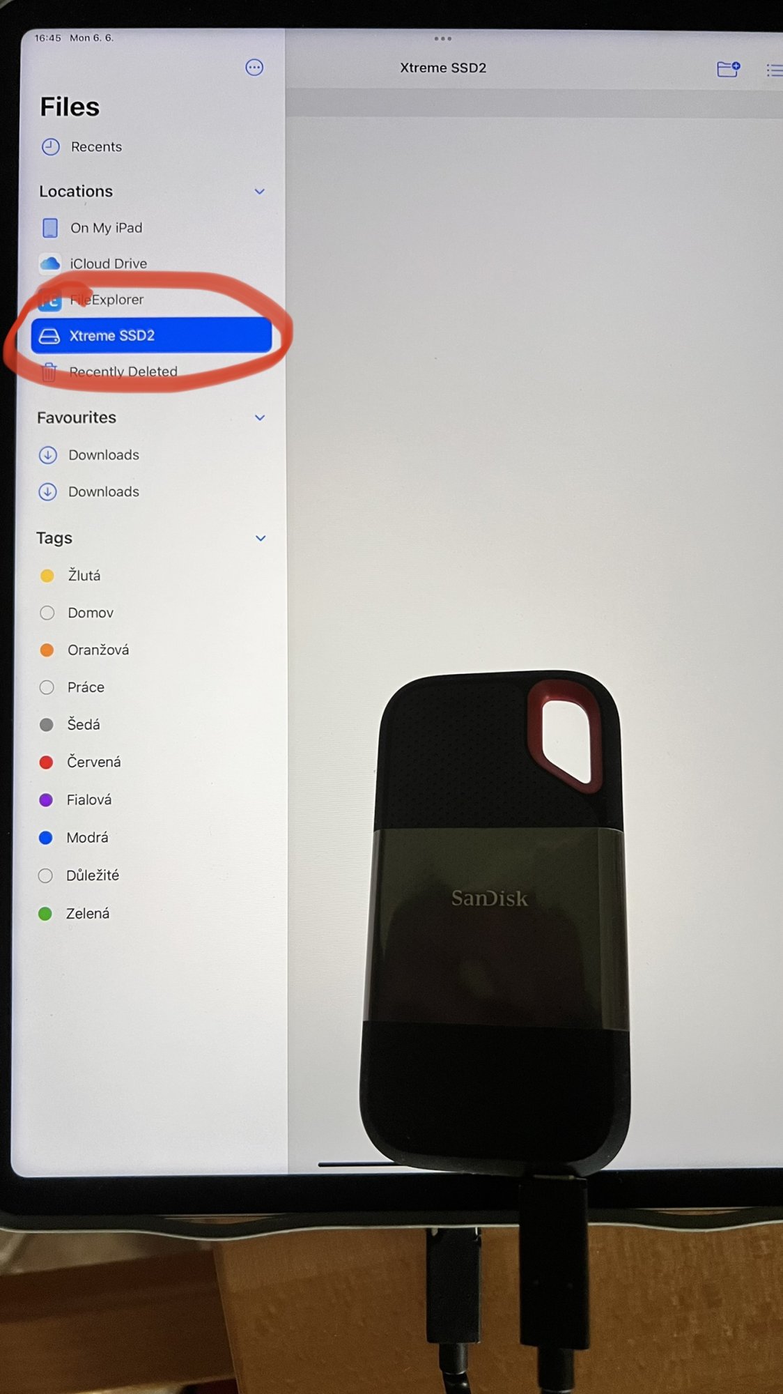

No problem with USB-C iPad Pro (where you need exactly 1 less cable, 1 less adapter and 1 less power bank/wall socket).
Any ideas? Is this the SSD? Or the iPhone? Or could it be the Camera adapter malfunctioning? I have no idea what should I replace, or just give up.

Looks like the SSD needs it own separate power supply. iPhone doesn’t have enough juice to keep it powered up.
That means even more cables and another battery bank.

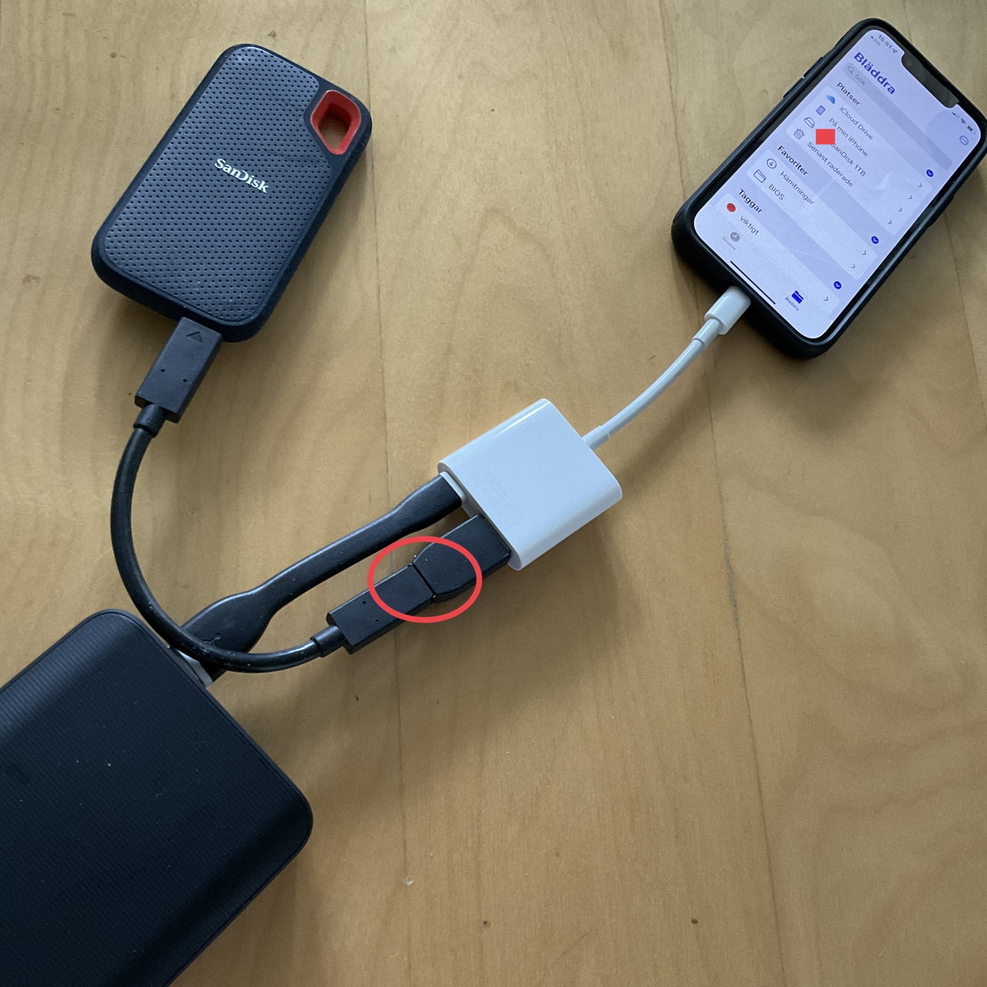

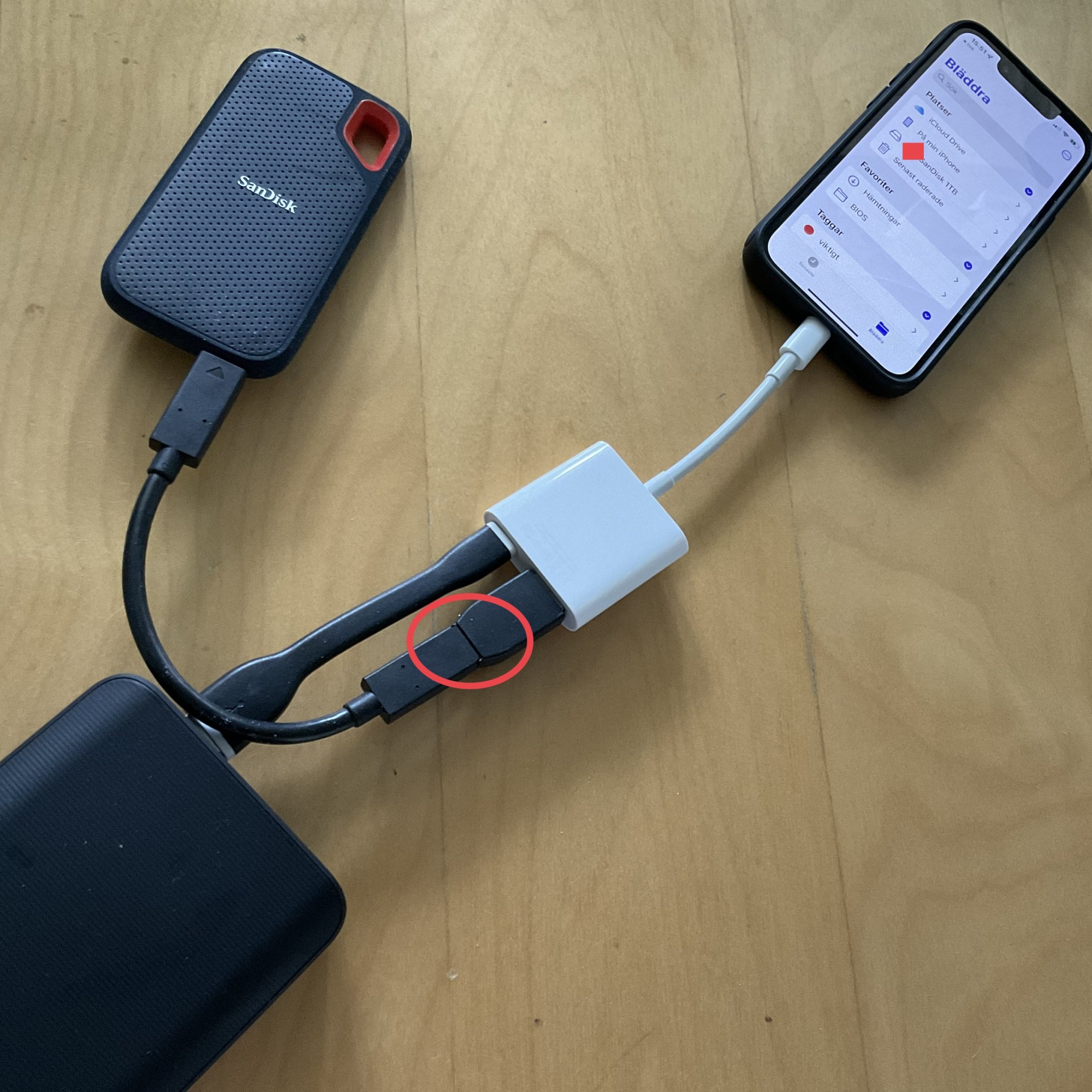

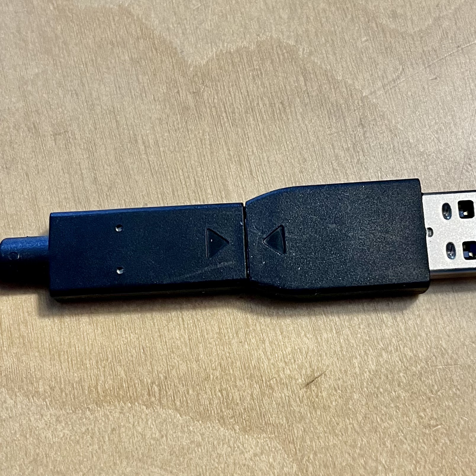

Should be no gap between cable from SSD and USB-adapter, turn it around.
Glad it works for you, at least. I must have flipped every cable at least a dozen of times. Almost went crazy yesterday. It worked before so why it shouldn't now? Nothing has changed. I connected the SSD cable and the adapter the same way as on your photo, no success. Wasn't sure if I should perform some Voodoo dance or order Samsung T7 SSD with another Camera adapter, but I went safe with the other option.

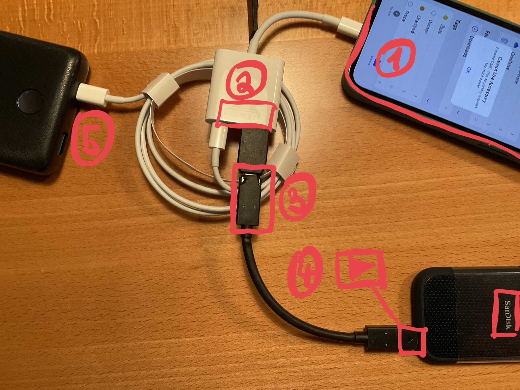

I got the thing connected exactly as you:
1. iPhone on its back
2. USB3 Camera adapter flipped, showing back imprint
3. USB-C cable flipped on this side, hiding the ▶ ◀ marks (got to chop the corners to fit in iPad case :D)
4. SSD on its back, showing the logo, top of the cable showing the ▶ mark
5. Power bank with PD
You are using a device which is more for laptops/desktops and wonder why a phone doesn't power it? Have you looked at other solutions that don't involve using an SSD? Like for example, OneDrive, DropBox, iCloud or even Google Drive?

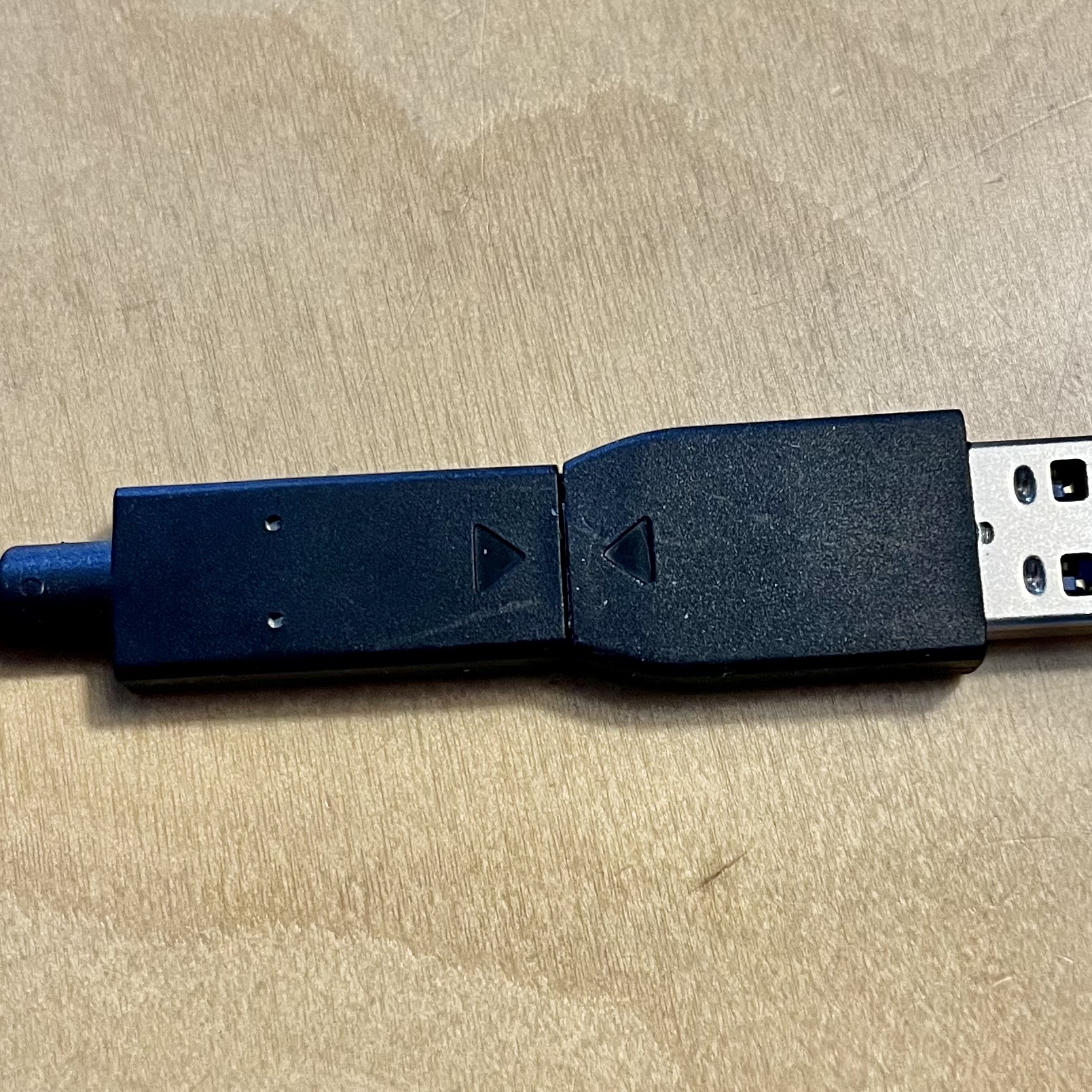

This little adapter wasn't designed for USB-C connections, but USB-A.

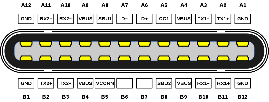

The USB-C jack has connectors in each side to work in any side. It was designed as a rotationally symmetrical connector. In the picture bellow you will se that the same pins on the upper side are flipped to the down side.
So, my advise would be, flip the SSD until it works. It sounds strange but It may work. (which sounds stranger)

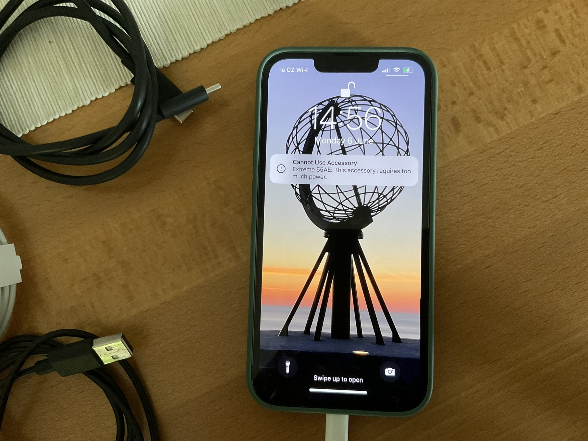

Thanks, I'll try flipping it in all possible combinations. I wish I saved the the one it worked it, to be sure if it's adapter problem or not. Let's play a game, Apple.
It could be the SSD(s). During the COVID lock-down I got 3 SSD's from 3 different manufacturers (including one from SanDisk) in a row that failed.

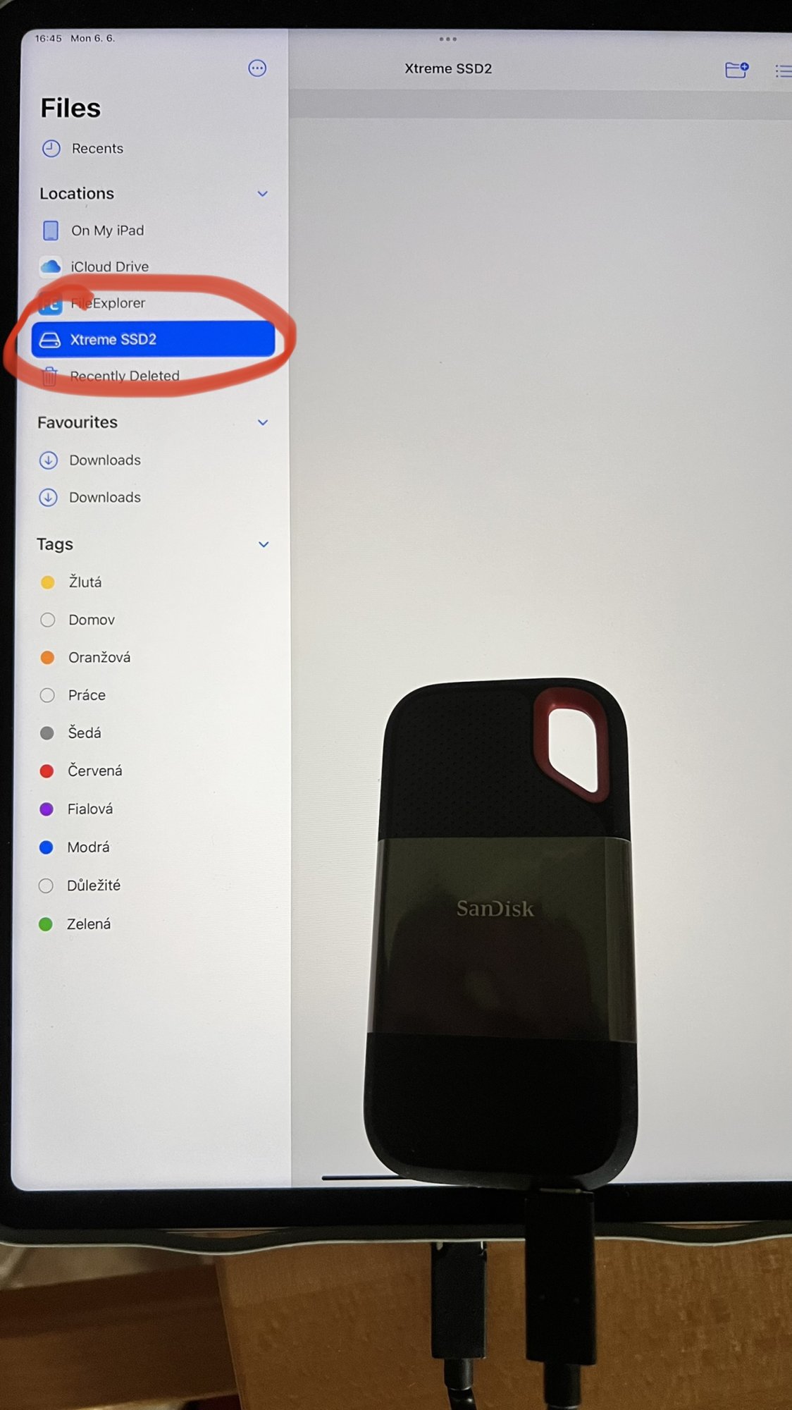

Thing is they both work instantly on my Mac and iPad.
I tried I tried and I tried. Flipping the ends of the cables, rotating the conectors. Biggest success was when iPhone didn't show the annoying pop-up error. I think those were the posititions you talked about, there was no connection.

This may be a very stupid question but I'm curious as I've never done this - would it work to use the USB C to Lightning cable with that SSD? I'm going to guess no because of power requirements.

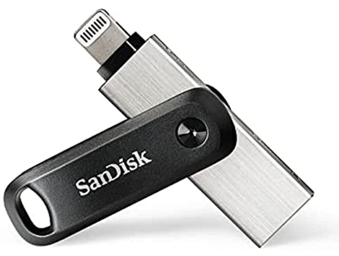

Figured if I had to do just my iPhone and connectivity was bad I'd get something like this: https://www.amazon.com/SanDisk-256GB-iXpand-Flash-iPhone/dp/B07VQPDM56/ref=sr_1_1?crid=IQXLHPYT80F7&keywords=lightning+flash+drive&qid=1654532284&sprefix=lightning+flash+driv,aps,165&sr=8-1

Could you try a 27/30 watt or more USB-C power brick, with the original Apple Lightning to USB-C cable?
It shouldn't need that much power, and Lightning's max is 27 watts (more power would work but it won't draw more power than its maximum). But maybe the iPhone is sucking down the full 20 watts and you need a bit more to power the drive.
Also just to make sure, a regular old USB flash drive works, right?

I can confirm neither SSD has problem with import or export.

I guess the OP could try a powered USB hub connected to the adapter. That way it's not dependent on the camera kit adapter for power.
Reactions: BigMcGuire
Blame iPhone for this because lightning port is not designed for powering up accessories that require lots of power. […]
I want to second what this poster said. I believe the error message is telling you what the problem is. Actually, some computers run into this same issue if you plug too many external HDD’s (the spinning platter variety) into them at once.
On computers, the way you get around this issue is to use a powered USB hub that you plug the hard drive into, and the you plug the hub up to the computer. But I don’t know if iPhones work with hubs. Here’s an example:
It looks like you tried a variation on this idea by plugging your power bank into the same adapter as the usb drive. Shame that didn’t work. It’s possible the adapter only sends power one way (to the phone) and not also to the external SSD.
