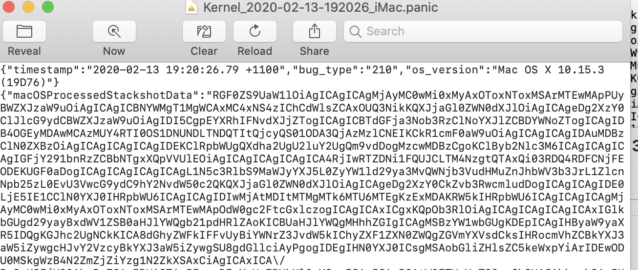

It suddenly started about a week ago. Every time I leave my 2019 iMac alone for a few minutes (maybe ten or so) it freezes and then restarts. However, it never happens during the time I use it.
There are many threads online about this issue, but no solution yet.

Happening here as well.
panic(cpu 2 caller 0xffffff7f98d9da8d): watchdog timeout: no checkins from watchdogd in 95 seconds (83 total checkins since monitoring last enabled)
Backtrace (CPU 2), Frame : Return Address

Can you try the instructions I provided above to see if you can reproduce it? All you have to do is download and play that 4k video for 30-60 seconds.

Add me to the list. I have noticed it maybe 2 or so times in the past few months. Then it happened two times within a week or so. The most recent time, I was in the middle of a school assignment typing a paper. 2015 27" iMac. All of a sudden Ill notice that the keybaord isnt responding (but music is still playing through the speakers) and after about 2 minutes of frozen, it will display the warning screen and restart.
panic(cpu 1 caller 0xffffff7f92cabad5): userspace watchdog timeout: no successful checkins from com.apple.WindowServer in 120 seconds
service: com.apple.logd, total successful checkins since load (22330 seconds ago): 2234, last successful checkin: 0 seconds ago

The same is happening here. New MacBook Pro running macOS 10.15.3 Catalina. Now seems to be kernel panic/restarting 3-4 times per week.
Does anyone know if Apple is fixing this?

Contrary to previous macOS versions, WindowServer seems to have higher CPU usage in Catalina when enabling Reduce Motion, Reduce transparency and especially Increase contrast in System Preferences - Accessibility - Display.
Maybe it can prevent timeouts.
