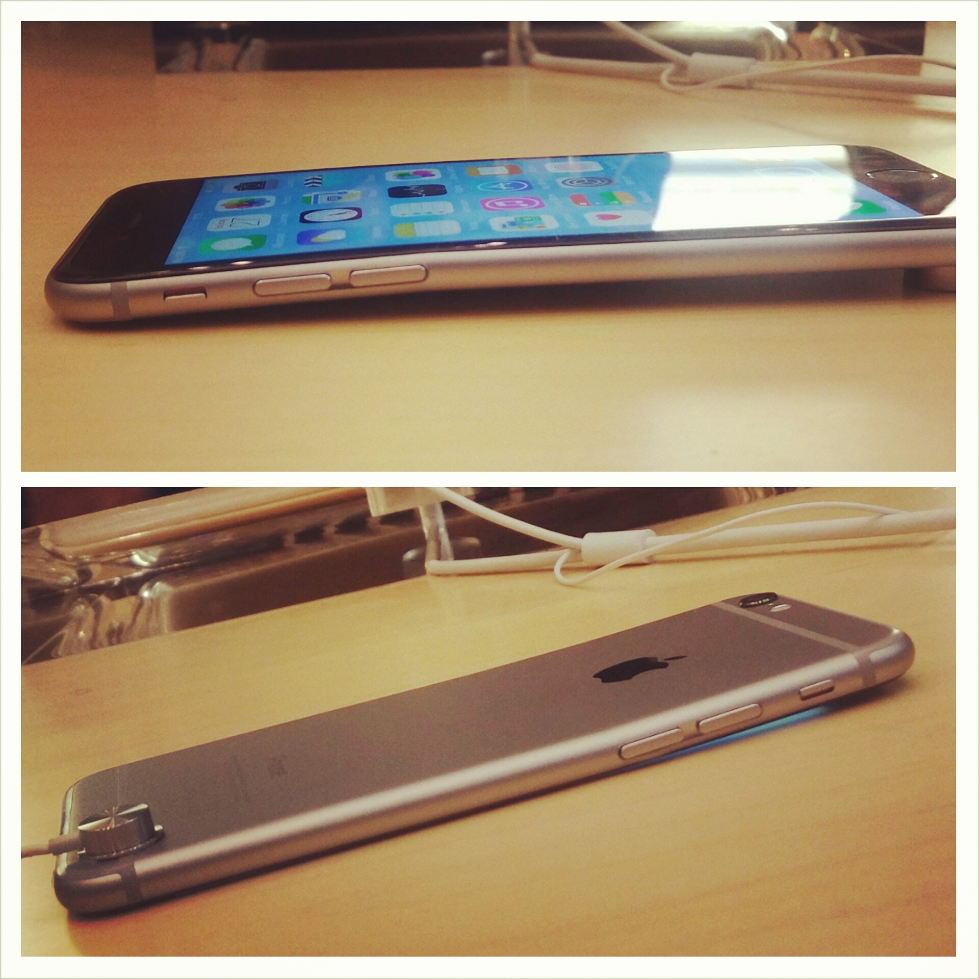

Looks like the apple store in London has bendy phone number 10 and its the smaller 6
https://plus.google.com/102834578939326629866/posts/5QKAMn6Pjer
