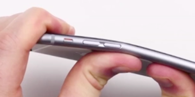

I just watched the CR video, which I hadn't previously (had only read the text). Don't see how anyone can be satisfied by that thin bar pressing down in the center of the phone. That doesn't seem to replicate any "real world" stress situation a phone will encounter (let alone address the charge that the iPhone has a weakness at a specific point in its chassis).
Its pushing on the middle part of the phone and the ends of the phone are too having pressure put on them

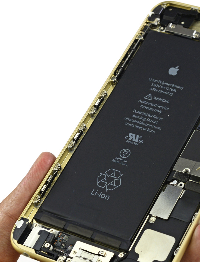

You realize that the reenforcement break by the volume buttons is the weaker one? That it's weaker because of the huge hole machined into the side of the aluminum frame for the volume buttons?
I can't believe anyone could fail to understand that.
I've already addressed this before. I can't believe anyone would fail to understand that if the weakness is in the volume button cutouts, the bend would have occurred there. But it occurs below the buttons, at the point you argue is stronger.
There seem to be several theories going around, or several interpretations of the theory you are defending:
1. That the interruptions in the reinforcements are leading to weak points (which is why people are saying a continuous bar would prevent bending), surrounded by strong points. I can see some reason in this theory, and if I were to believe in a theory, this would be the one.
2. That the reinforcement itself is bending the phone at the volume button cutout, because the cutout weakens the metal. I don't find this very credible, as the reinforcement's sole purpose is the reinforce that area, and unless that reinforcement is bending itself, there shouldn't be any bending. Furthermore, the bend is occurring below the volume buttons (both of them), and if the cutouts are causing weakness, the weakest point (the point at which it would bend) should be either in the middle of either cutout, or between the two cutouts. But again, the reinforcement bar is there. And so is the battery, flanking that entire length.
Either way, even if I do lend credence to this theory, I just don't see this being an issue in everyday use. I see it as a problem for people planning to apply force at this specific point, in a very specific manner.
Read this and explain me why this hypothesis is wrong.
http://imgur.com/a/FBegH And why the phone of user richardsonrs e.g. bent at that same spot in his jeans? https://www.youtube.com/watch?v=XQxX_x3HTXQ https://forums.macrumors.com/posts/19935054/
And thanks for your concerns, but I don't think I have any reality issues. But I really dislike these trolls here too... :rolleyes:
1) the video shows a bent iphone ( very very slightly ) but honestly we don't know in which condition, we could trust the user and think it was just his front pocket, but it could be more than that.
2)the theory about bending phones is total ********. the load diagram is totally wrong in the second scenario (there should be many many peaks, because the momentum must be taken in its absolute value)
the Momentum diagrams show just the reason why the phone breaks in that 'weak point' and why the break point of the lab could be located in a different position ( in the middle )
So in the end it s the amount of force to decide the break, the momentum diagram generally just shows where it occurs. Of course the lab test misses the weakest point, but still the video test shows un unrealistic use of force ( if u want to break it it breaks )

The bend did occur there:
It doesn't bend at the volume buttons because there is reenforcement there. It bends at the reenforcement plate's pivot point. The metal above and below the volume buttons stretches and compresses:
Others have diagrammed the forces at play.
It doesn't bend at the volume buttons because there is reenforcement there. It bends at the reenforcement plate's pivot point. The metal above and below the volume buttons stretches:
That's exactly my point, one you just contradicted. It bends at the point below the reinforcement, which is where that break is. The weakness is not in the volume button cutouts, it is in the LACK OF REINFORCEMENT flanked by two sides of reinforcement. There is a similar break at the midway point where Apple and CR applied their force.
