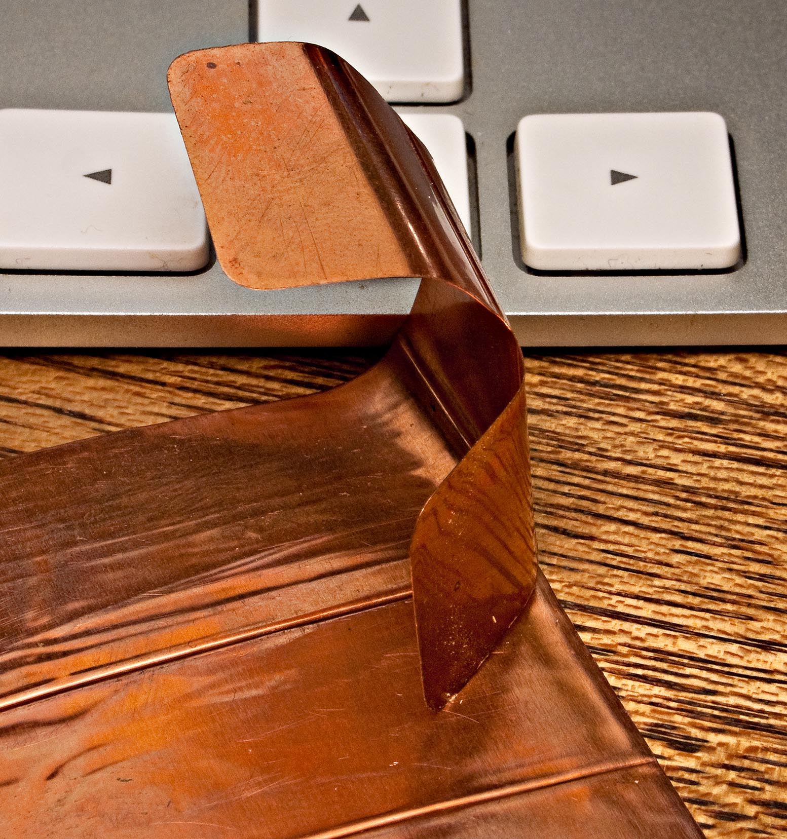

As for the copper foil I guess something like this would last at least ten years with something like contact cleaner flowing over it steadily 24/7.
I guess water without a softening agent would eat through it sooner though. Three to five years maybe?
It would have a lifespan. An inhibitor is added to ethylene glycol to help, but it eventually can eat it's way through.
As I think about it, such a thin Cu surface would also be rather delicate to deformation, rendering it's advantage moot, if not detrimental. (Too much TIM to fill in the dents (past scratches), and the chip's cooling isn't as efficient as the thicker blocks on the market). Maybe to the point of DOA. 3rd party installation would be at the users peril (voided warranty), and system vendors wouldn't want to deal with it due to defect rates (real or imagined). 🙁
Adding some nickel to the mix would help, but I'm not sure how thin it could go without deforming under installation & mounting bracket forces. 😕 That's why precision die cast might be better (than stamp forged, assuming that was what you were thinking), as you can add material to strategic locations to counteract these issues. But I'm still not certian as to the plausible thickness on the mounting surface. 🙁
Yeah, just size and mounting frame would cure most of that. Even something as huge and deformable as window screening gets a massive boost in structural form integrity with the addition of a frame. 😀 Also since they are so thin and cheep just make them as disposable as thermal paste is now. Wax-on, wax-off. 😉 Better for marketing too. 😉 Also like you say, puer 99.99% copper may not be the best material so whatever works. At that mill (or even thinner) I guess titanium would be just as good maybe? Whatever... the idea is to get as much of the heat away from the chip die as fast as possible. An HIS and a hugh copper block is a bit retarded for this purpose when you think about it. 😛 I wanna transfer ALL of the heat into the moving liquid in a matter of milliseconds and then exchange that off however.

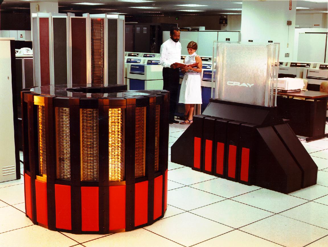

The Cray 2's were completely emersed in the Flourinert, it wasn't just on little heat syncs clipped on like today's PC's. To change a board that had a problem you had to completely drain the fluid from the machine then refill the machine. While it was active, you could see the fluid swirling around inside it since the top part was all clear.
The cooling unit was seperated and had a little "waterfall" that the fluid was pumped over. (the triangle thing on the right)
Now that is a proper computer.
That does seem to be a downside to immersion. 😉 Rather messy. 😱 😛
Perhaps time as well, assuming the competition were proper servers/workstations (easy access & removal) as the Cray 2 looks to hold quite a bit of fluid to drain first. 😀

BTW, For all you with Cray2 Envy your Mac Pros are faster! A new 2009 MP is about 40 times faster than the fastest Cray 2! 😀
Hey, don´t say that. Cray rules. 🙂
Hm, Cray CX1 Tesla. When can we get a Mac Pro Tesla? 😀
