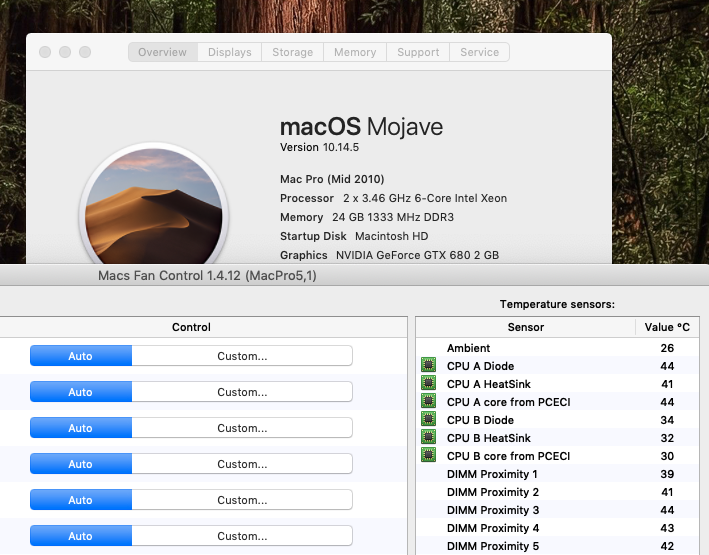

It's normal. CPU B gets the cooler outside air, CPU A gets the already warmed air from CPU B. Most people delta is around 6ºC or 7ºC, but there are some reports of 4ºC to 11ºC.
my 12 core 2.66 is sitting here with about an 8ºC difference between the two. It's totally normal.
My 4,1>5,1 has a 5°C difference. Normal.

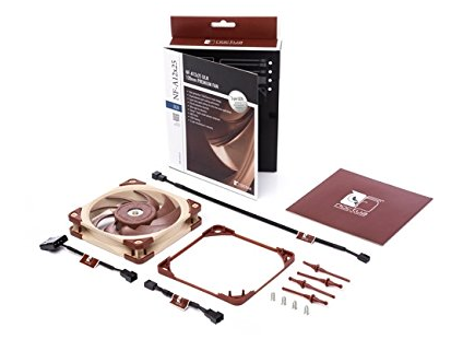

I have already bought ( for my PSU ) a Noctua 120MMx120 NF-A12x25 fan kit

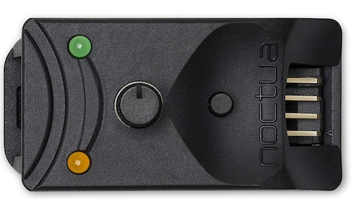

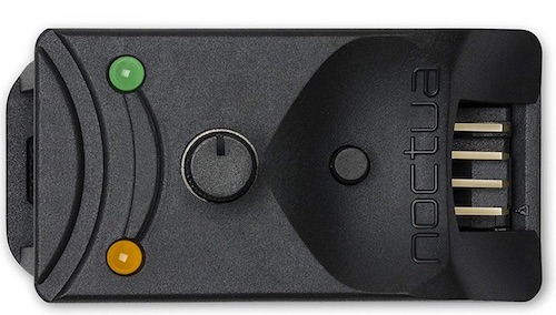

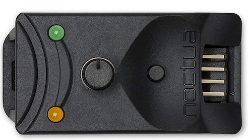

. . . .along with the Noctua NA-FX1 fan controller fan kit
- I have both a passive thermal sensor along with a Laser Thermal gun to monitor PSU temps so I don't need Apple Thermal monitoring. Anything under 40°C for the PSU in summer will please me.

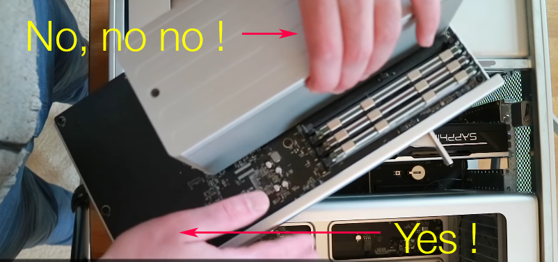

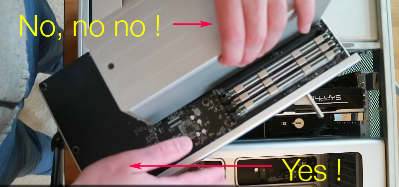

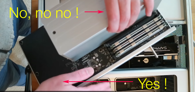

That Austrian ? guy's video is spot on - he is truly bi-lingual but I cringed when he picked up the CPU Tray by the heatsink ! Definitely a NO NO with 4,1 & 5,1's trays.

That heatsink makes a great carry handle! 😱
