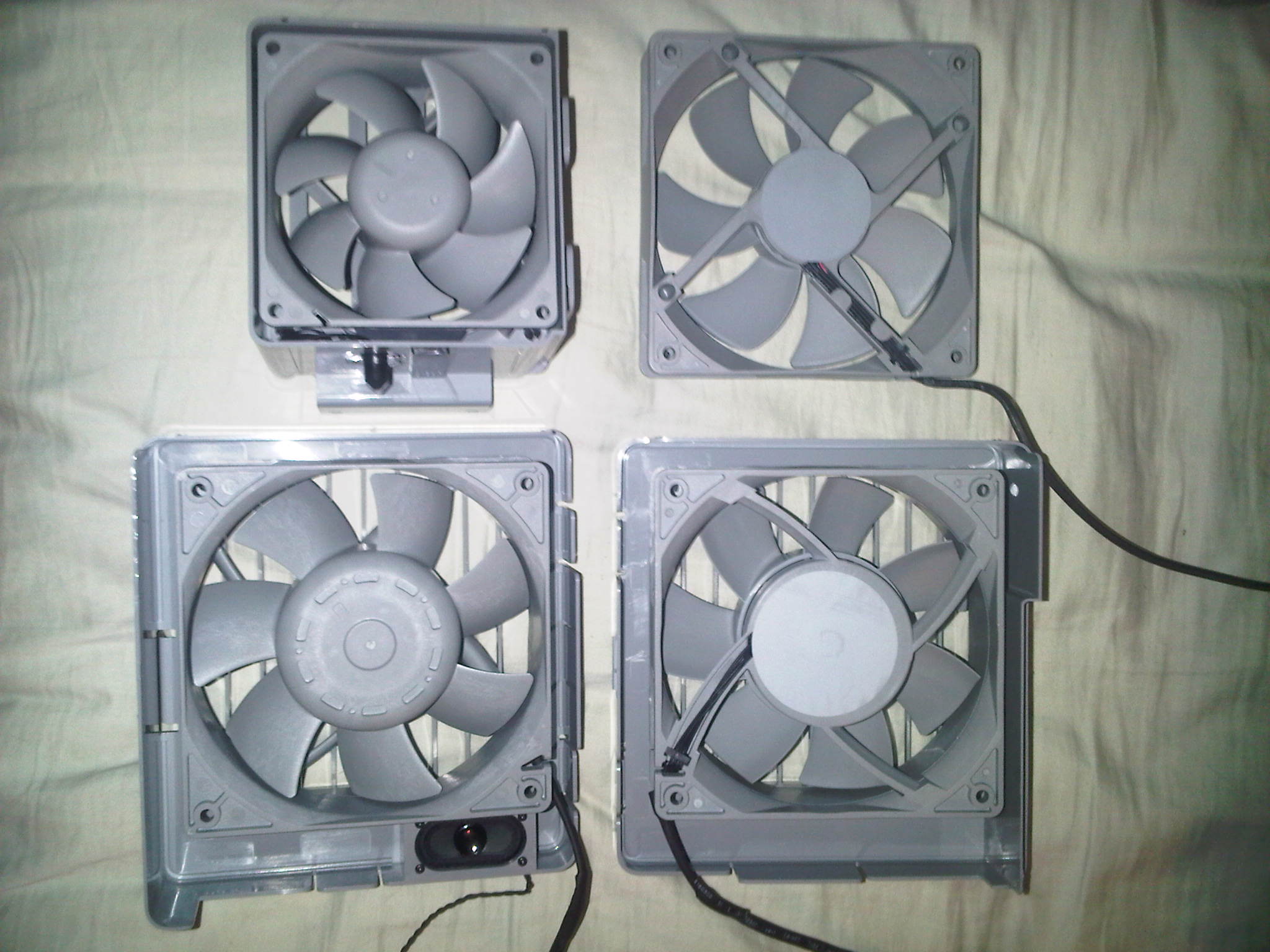

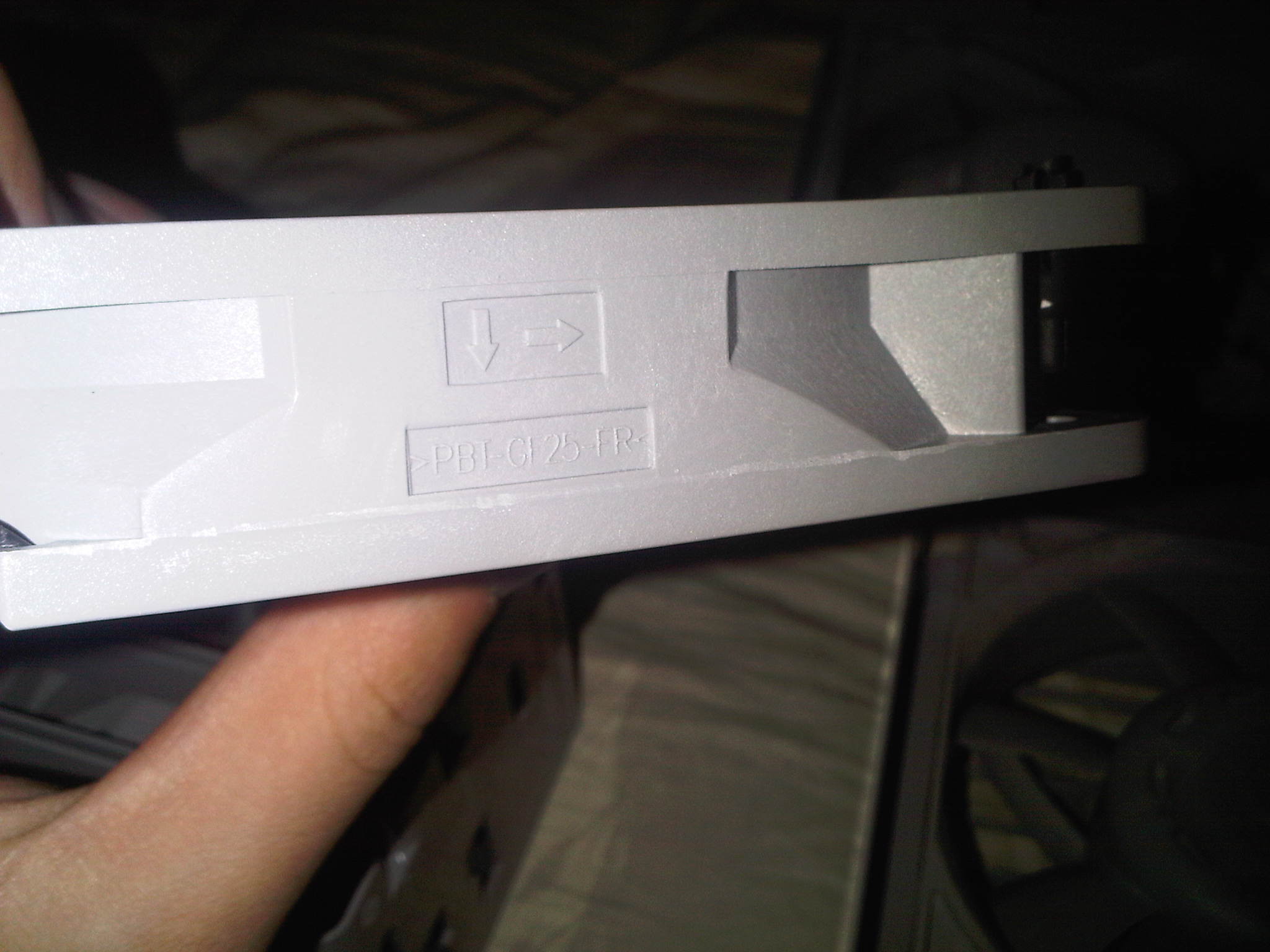

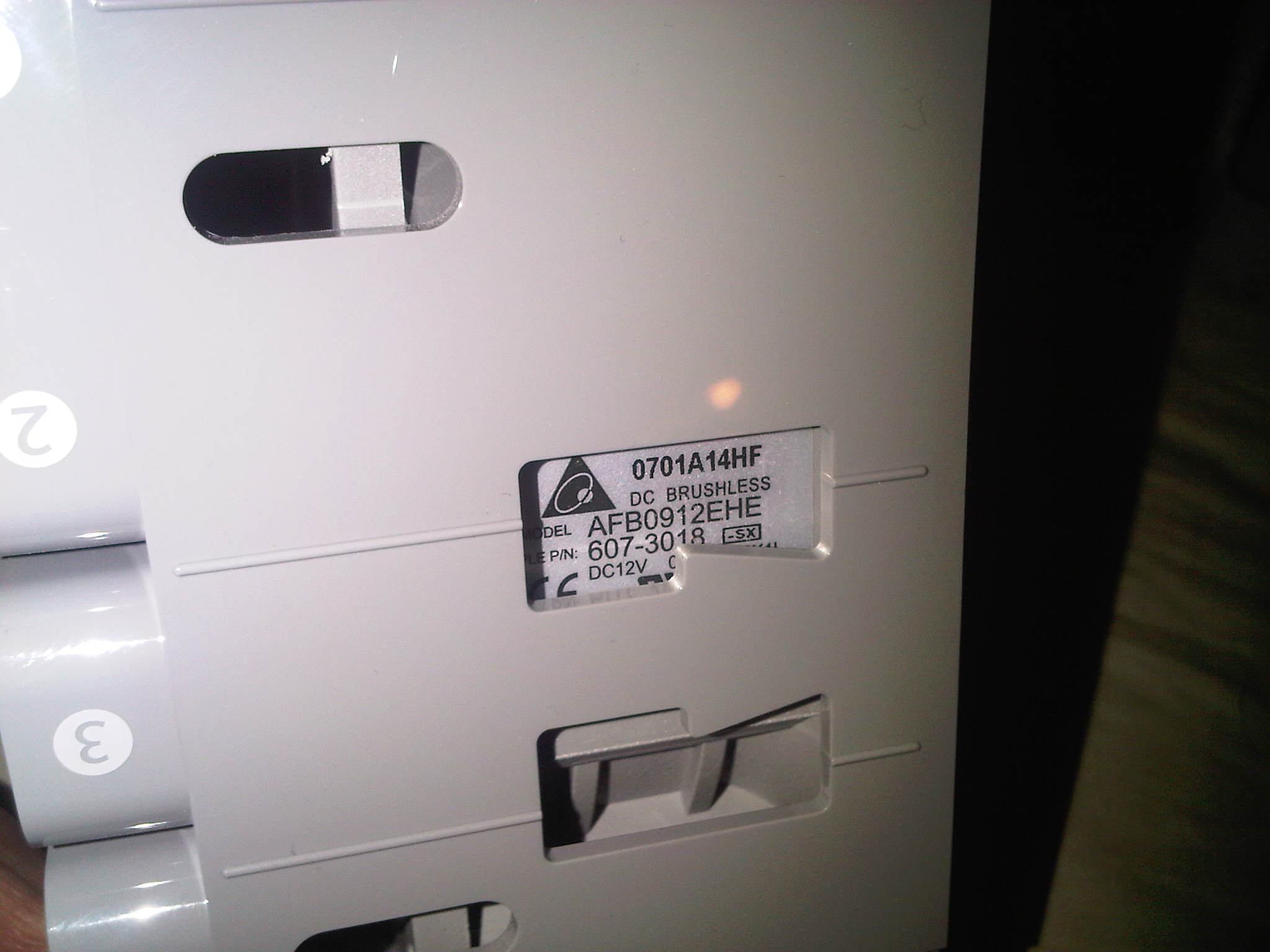

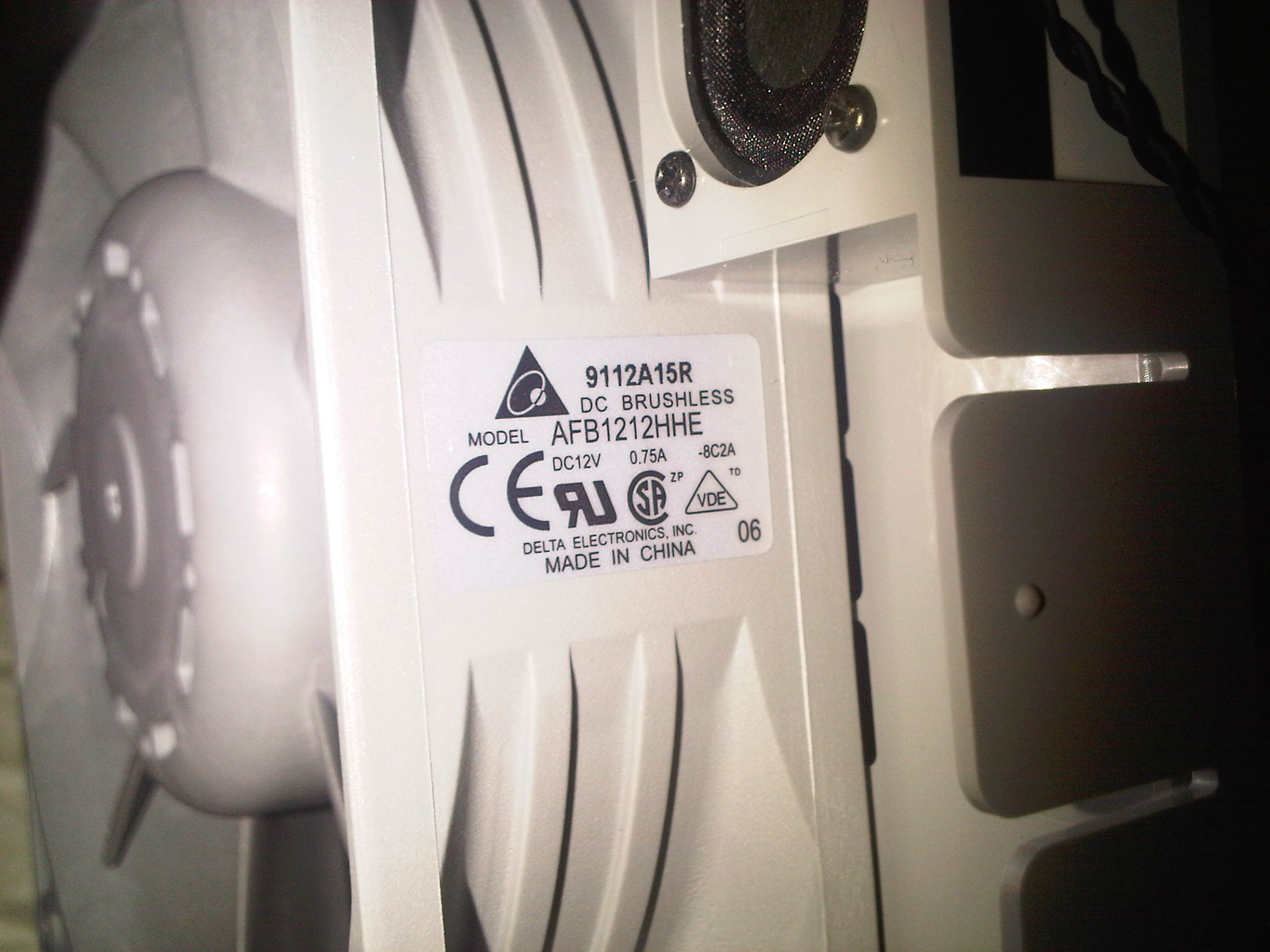

Here are some pictures. The first picture is all four fans (PCI, PSU, Intake, Exhaust). Next is the information that is on the label of the Intake/Exhaust fans. Then the information on the PCI fan. The next picture is the only information I could find on the PSU fan. The last picture is the following connectors from left to right. Exhaust, Intake and PSU. The PCI fan has a strange proprietary 6 pin connector that mates right into the logicboard. Replacing this fan looks like some splicing of wires and the original conncetor is required. I plan to try replacing the three 120mm fans first, then take a stab at the PCI fan depending upon the results of the 120mm fan replacements.

PCI Fan looks as if its a 92mm fan according to its model number after a quick google search. Information on PCI fan http://www.delta.com.tw/product/cp/dcfans/download/pdf/AFB/AFB92x92x38mm.pdf
Information on exhaust/intake fans - intake/exhaust http://www.delta.com.tw/product/cp/dcfans/download/pdf/AFB/AFB120x120x38mm.pdf
The PSU fan looks like its made by RAIDMAX. The only thing I could find that was close was a RAIDMAX fan with the model number PBT-GF30. The Mac Pro PSU fan is PBT-GF25. Could be a totally different manufacturer though.

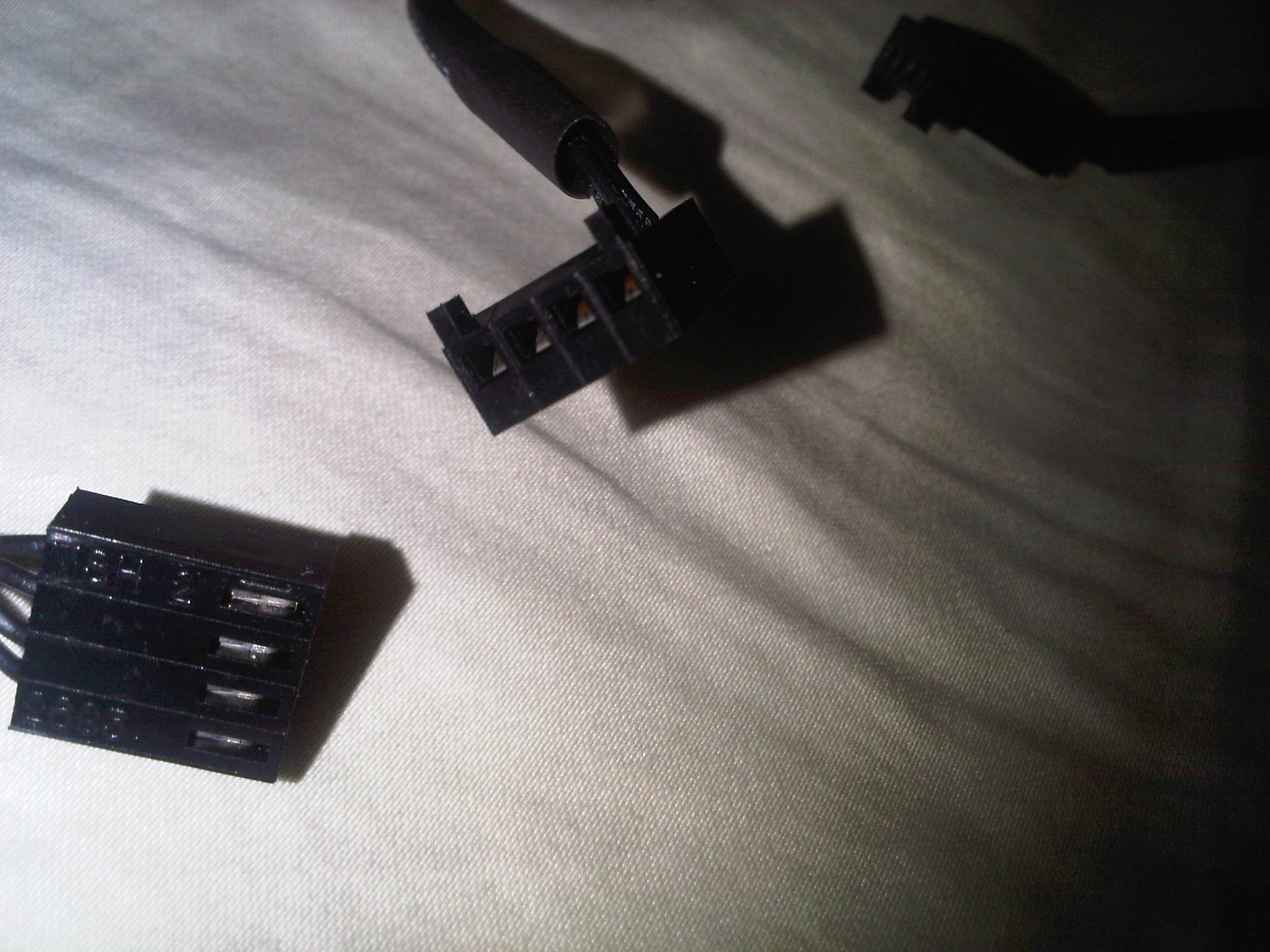

Turns out I had a PWM 4 pin connector fan that was used in an old pc box. I pulled it out and tested it.
Unfortunately it ran at 1300rpm and speedfan couldn't do anything to change it. Oh well, looks like I ought to cancel my Newegg order asap.

From what I have read elsewhere, Apple case fans may not be PWM but use the 4th line for speed regulation in a different way.
Supposedly the 4th lead on the Delta fans that Apple uses, uses an analog signal to adjust the speed, as opposed to these fans using a "digital" signal for PWM. I have a feeling my experiment is ending before it begins lol!

According to this thread (http://www.silentpcreview.com/forums/viewtopic.php?t=58212), the Apple fans use voltage on the 4th pin to control the fan speed, not a digital signal.
This is true. The 4th pin on the Apple fans is an analogue voltage, and not a digital PWM signal.
The Delta fans inside the Mac Pro are custom built units. They use the 4th pin to vary the voltage across the rotor coils, rather then as a trigger that rapidly turns the coil on and off at a varying frequency. This eliminates the whole knocking issue you'll get with a crappy PWM system where the drive frequency is lower then it should be.
