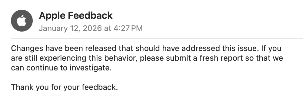

Reported the issue a few months ago and just got a response from Apple that it should have been addressed.
