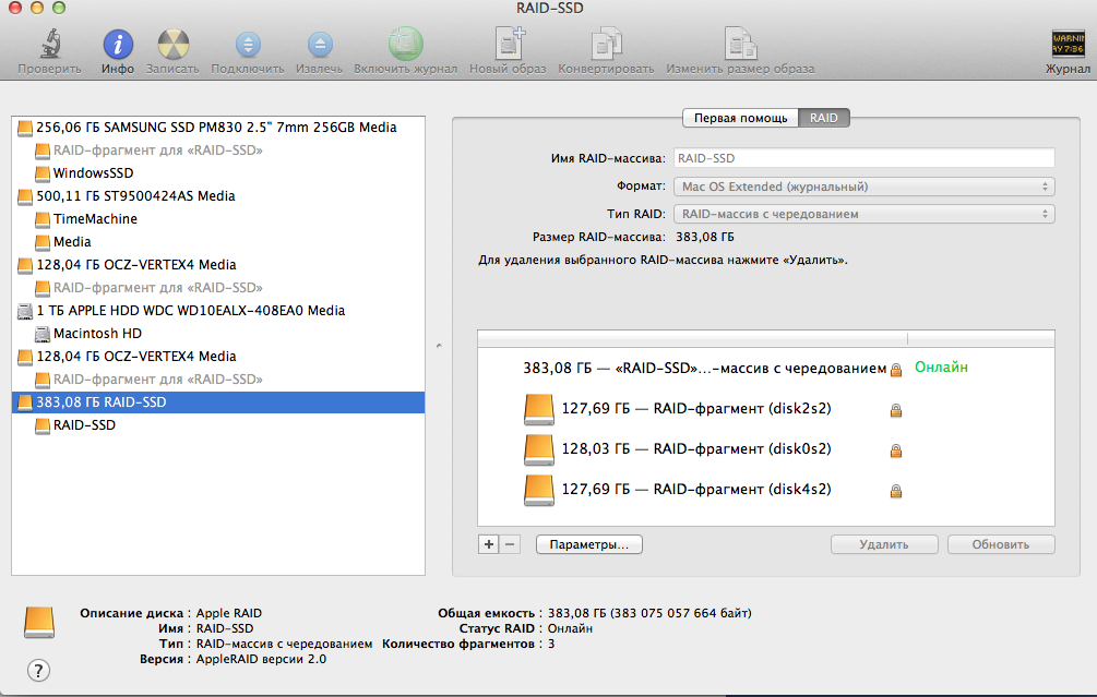

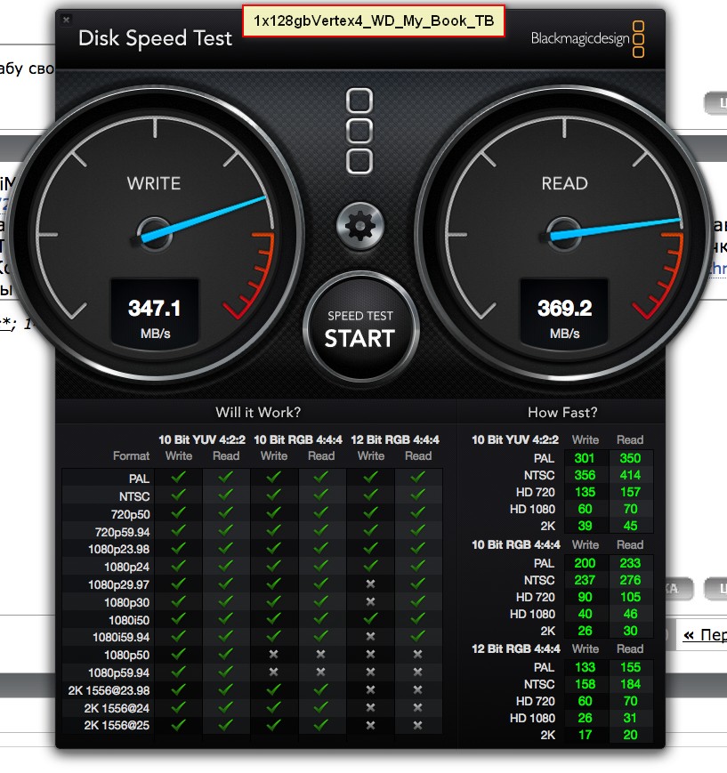

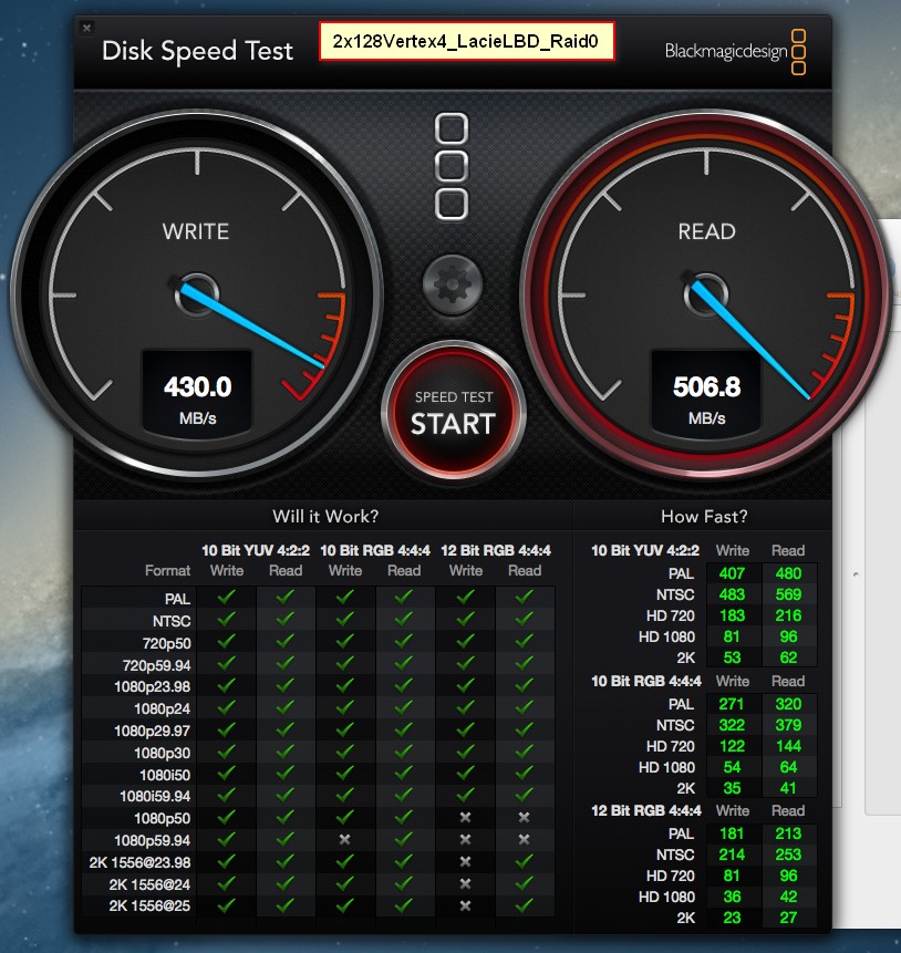

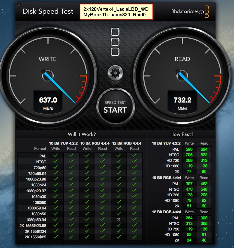

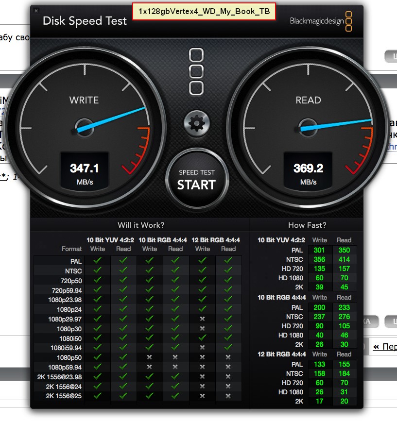

Thank you to the participants of the forum. I don't need to open my new iMac 27. I have a Lacie LBD SATA II 2x128gb Vertex 4 and WD My Book Thunderbolt samsung 830 256 gb divided into 128 gb for Mac OS Raid and Windows. I am very pleased with the result. Here are a few of my tests. Sorry for my English

You have wicked fast speeds!
