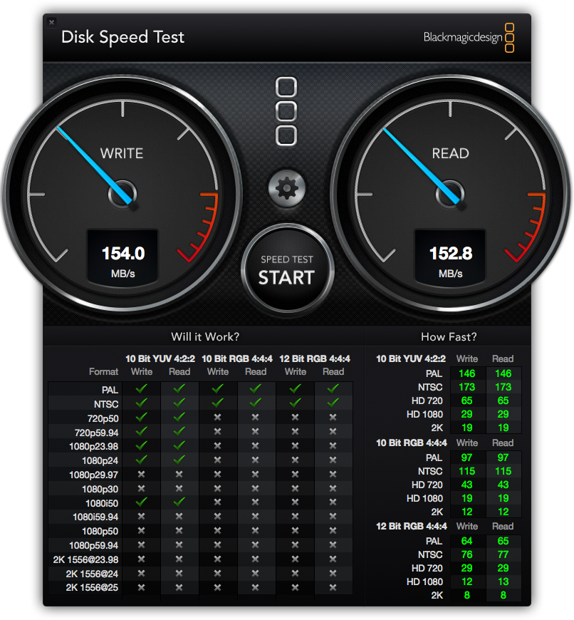

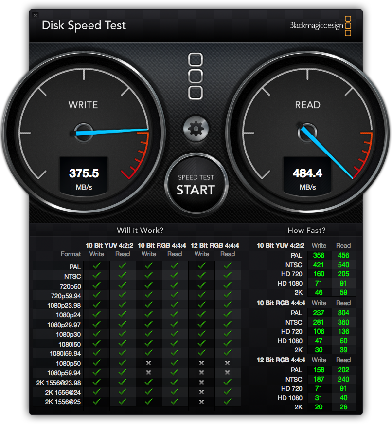

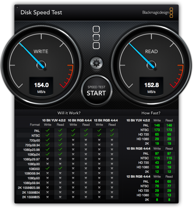

Here are some LaCie Little Big Disk test results:
1) 1 TB Hard Disk (2 x 500GB 7200rpm hard disks RAID-0)
2) 2 TB Hard Disk (2 x 1.0GB 5400rpm hard disks RAID-0)
3) 512 GB SSD (2 x 256GB SSD RAID-0)
Sorry, my notes don't say what brand SSDs were used in this test, but from the file-date they were probably OWC 6G SATA-III SSDs. I just tested a LBD which has a pair of OWC Electra 3G SATA-II SSDs and saw 270/330 MB/s speeds)
-howard

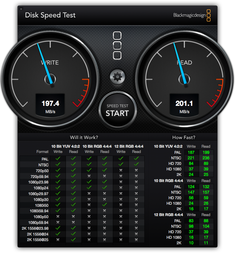

This is my 2011 15" MBP with the stock Apple 6g 128SSD 8gb ram (cell pic)
This is the same but with (cheap f/Amazon) 16gb ram, and a Samsung 830 512gb SSD replacing the 128gb SSD
This is the Lacie 2TB Thunderbolt LBD out of the Box (faster write than the initial 128SSD stock Apple SSD, close to the same read)
* This new drive had me worried, Desktop would not find it initially, despite checking connections, restarting, etc. I think I had some dust in the T-bolt socket from not using it… ever. I blew in there lightly, and took a little artist brush and loosened some dust particles.. took my rocket blower out from my camera gear gave a light puff of air in there to blow out the residue… plugged in the cable and the drive appeared!
NOW… what to do with the Lacie LBD 1tb that I ordered 1st and was also delivered, still sealed… hmmm, hmmmm? Keep, use, play with that… tear into that one, wallet says send back… sure I can use though?
So far this 2tb is pretty quiet… shocked, I had ear plugs ready based on reviews! ; ) Not under any heavy load yet though…
