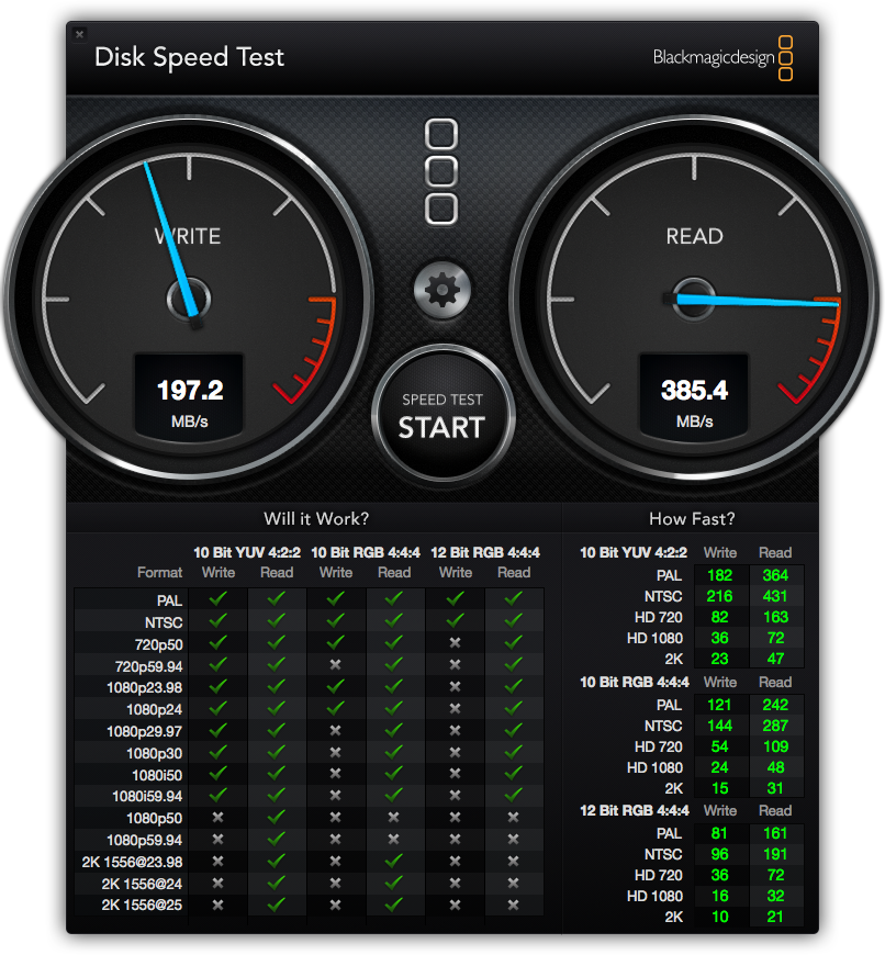

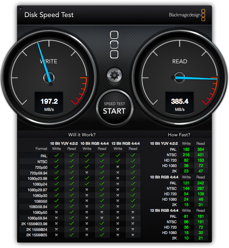

My Crucial M4 128GB SSD connected via the Seagate GoFlex Thunderbolt adapter is more than doubling HDD speed tests! Was getting 70 read and write on HDD.
