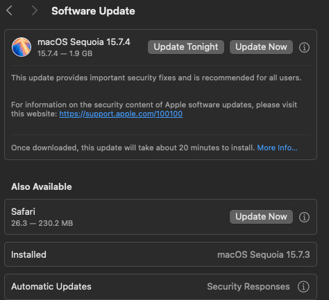

When I enrolled a Sequoia virtual machine into the beta program, Tahoe was still being shown as an available update.

Mine just shows a 15.7.4 preview build....... but I do have the 90-day deferral policy in place and maybe that still hasn't kicked in yet.
I meant to point out that, unlike on iOS, just enrolling into the beta program on macOS does not hide the upgrade option, Tahoe now.

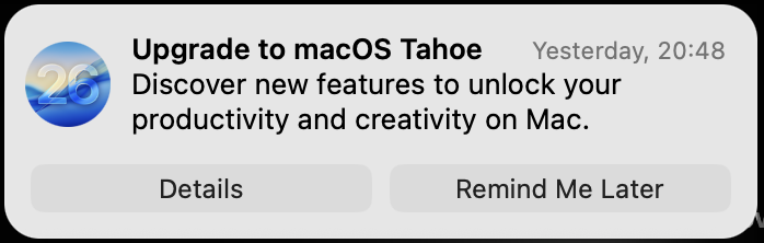

Hi, just got this message—sure enough, without a 'x' close button, although I did install the following:
  • SoftwareUpdate.mobileconfig profile
  • NoBubbleNew.mobileconfig profile
and run the command 'Set MajorOSUserNotificationDate to 2035'. No upgrade bubble though in the Dock. Does anyone encounter the same? Any suggestions to get rid of? Thanks

Tahoe is still hidden by Defer90.mobileconfig, install that profile. Reboot after.

so with deferring or turning off automatic updates y'all still get this notification ?
