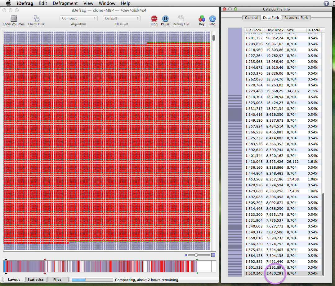

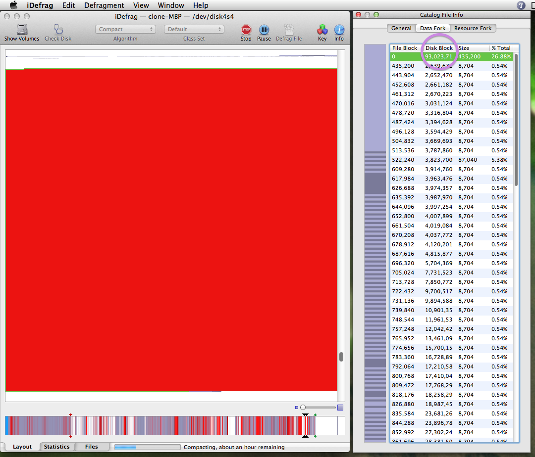

… HFS Plus catalog file … gets cached in RAM.
Impossible when, for example, that file alone is larger than the amount of installed memory.
At http://apple.stackexchange.com/a/19358/8546 there's a 3.5 GB example; I have seen many that are far larger.
