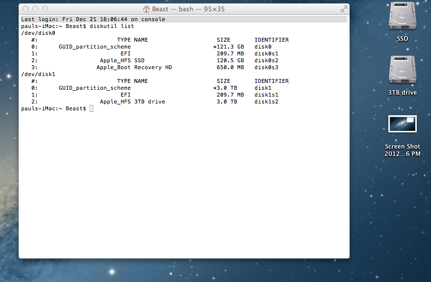

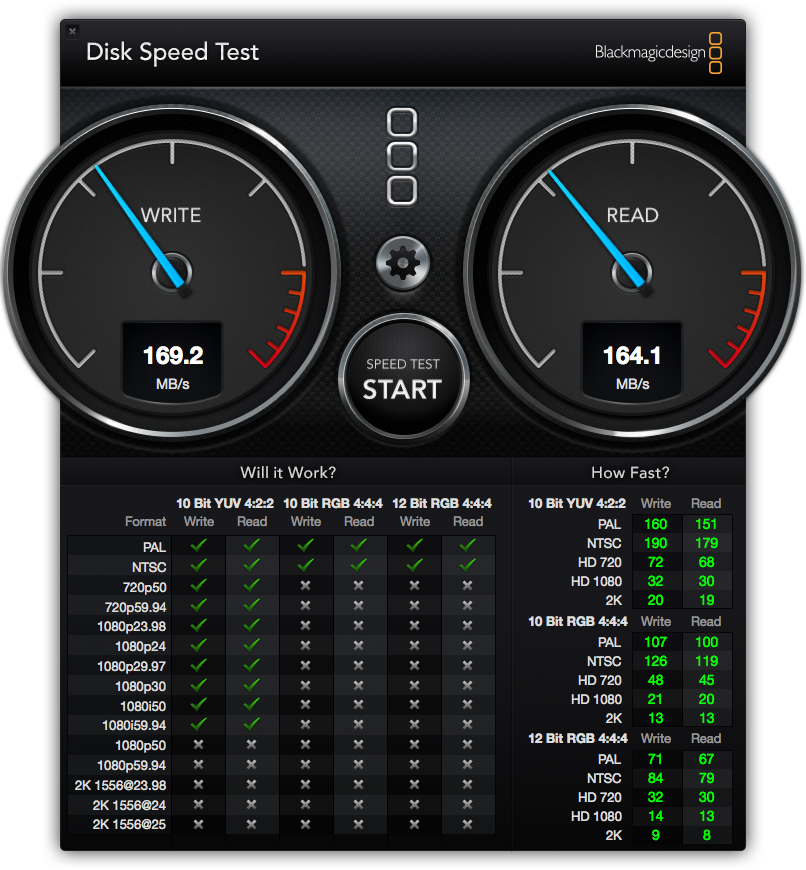

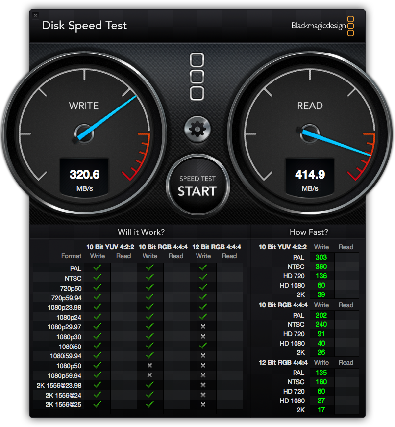

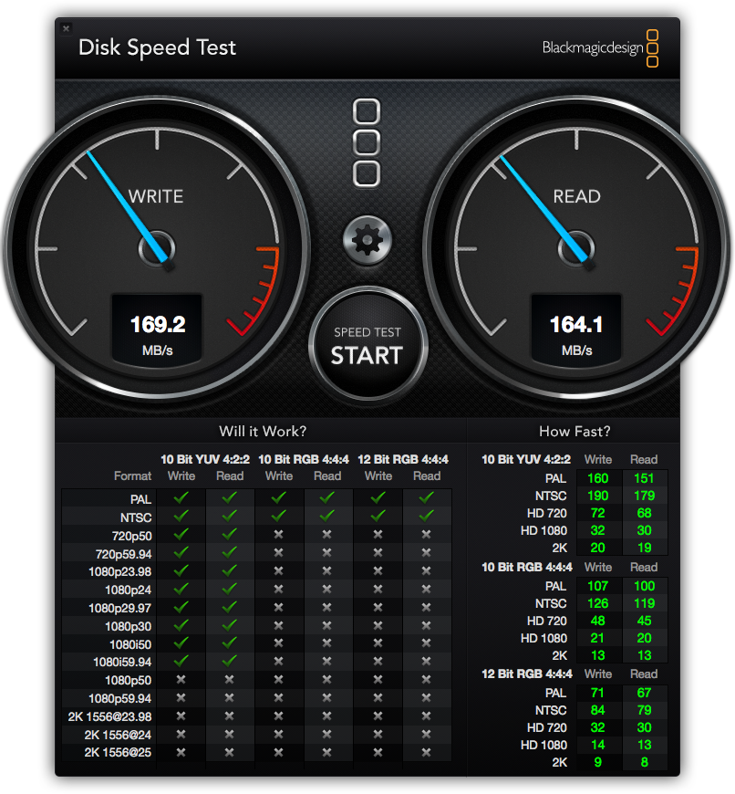

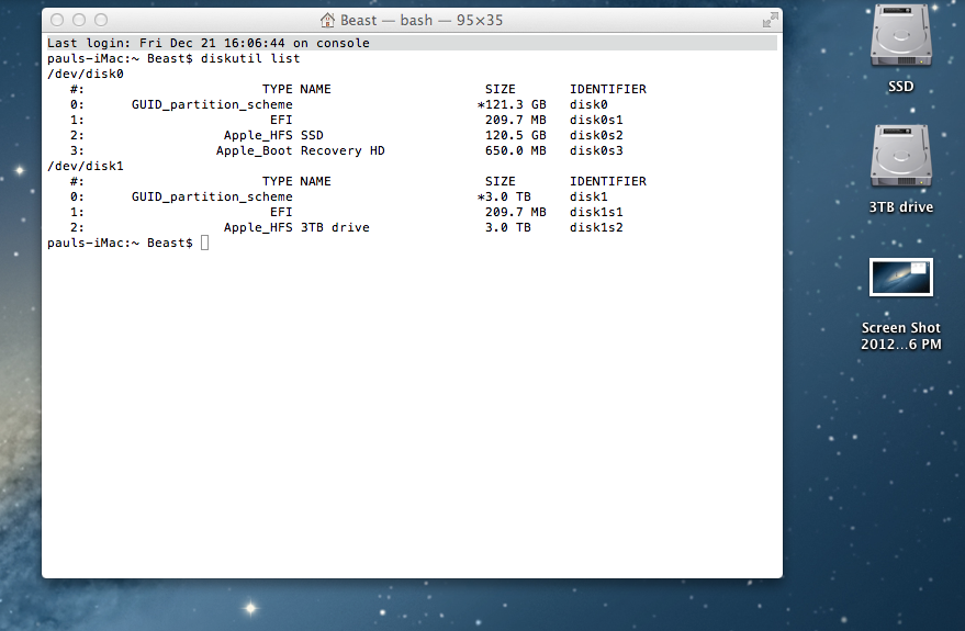

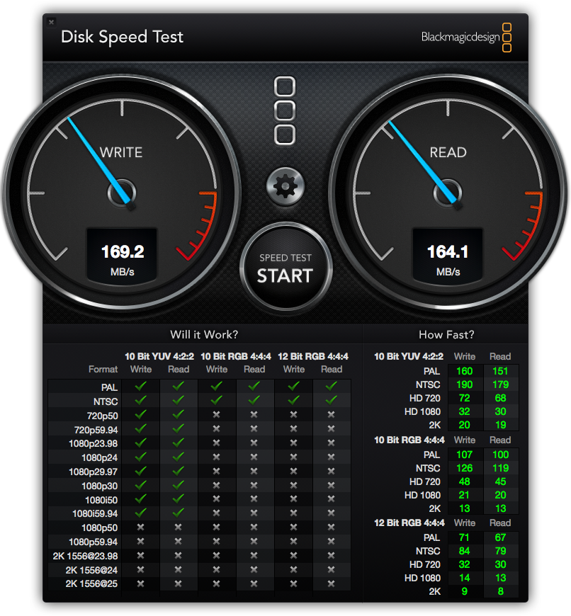

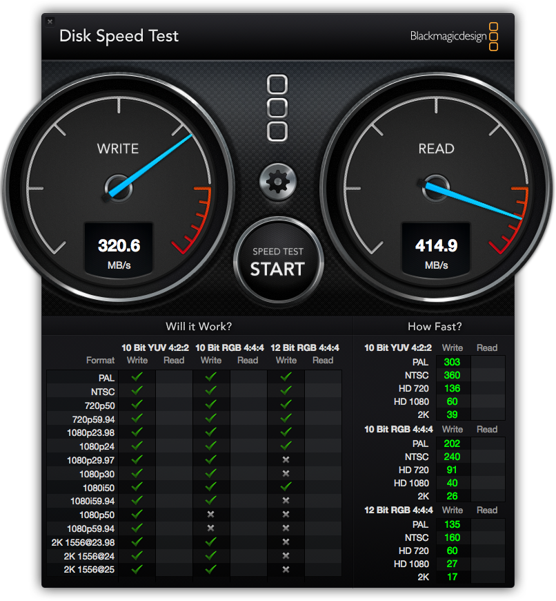

Ok i just successfully split my fusion drive into the SSD and HDD alone.
3TB HDD benchmark
128GB SSD benchmark
