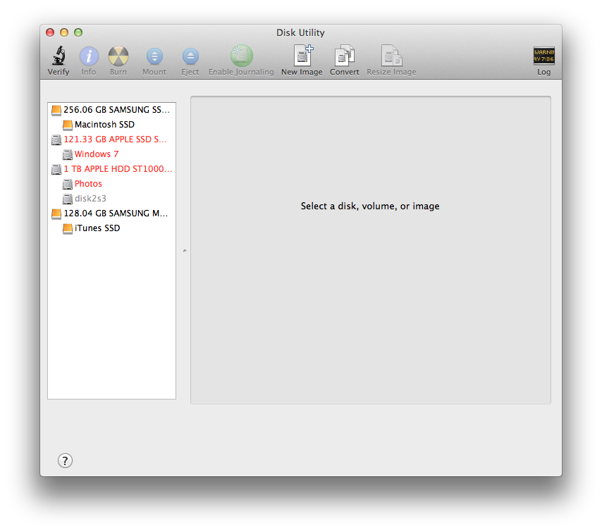

Hey, so this is an odd one.....
I have a 1TB fusion iMac, and something bad just happened..
I boot from a Thunderbolt 256GB SSD.
I split the 1TB Fusion into the 120GB SSD and the 1TB internal hard drive.
I then installed Windows 7 on the 120GB SSD. No issues.
I then split the 1TB internal into two parts: A 500GB HFS partition for OS X, and a 500GB ExFAT partition for Windows games etc, but to be readable by OS X.
I used Parallels Windows 7 to download a game to the ExFAT partition while in OS X. I then rebooted into Boot Camp to play the game, and... um... the drive wasn't found at all.
I then rebooted into OS X, and the ExFAT partition has been renamed "disk2s3" and is not readable.
What on earth happened?!

That is odd ... perhaps Disk Utility trying to "repair things"? They really need to put an option switch on that activity.
Perhaps you should format it for FAT from within Windows if you are able to see it in the Windows Disk Manager Tool.
I've now formatted the dead partition of the disk as NTFS instead of ExFAT, I somehow feel safer that way. (Windows saw the partition as RAW, meaning it somehow got reverted... - very odd). I I also downloaded the trial of Paragon NTFS 10, which gave me instant/transparent access to the NTFS partition of the drive through Parallels, and I can read/write without any issue. This is after I tried MacFUSE and NTFS-3G, which didn't work and gave me all sorts of errors...
I'm probably going to buy Paragon NTFS 10, if it continues to work.
I am a bit irritated with Apple and the Disk Utility BS. It's really frustrating. It's also bizarre that just one half of the 1TB disk got messed up. My HFS 500GB partition was fine, as was the Windows 7 install on the SSD portion of the fusion drive.
